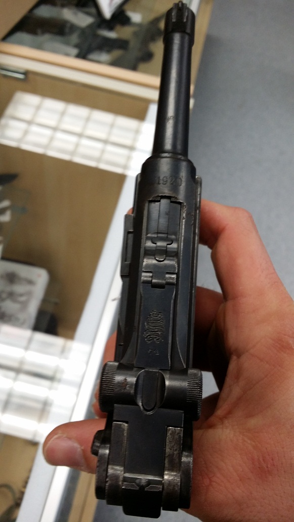

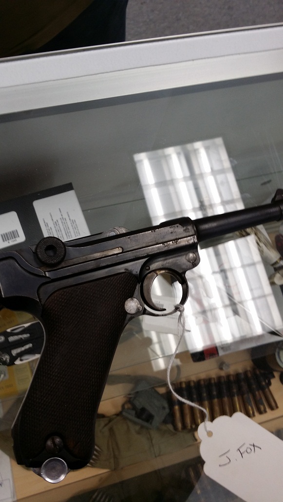

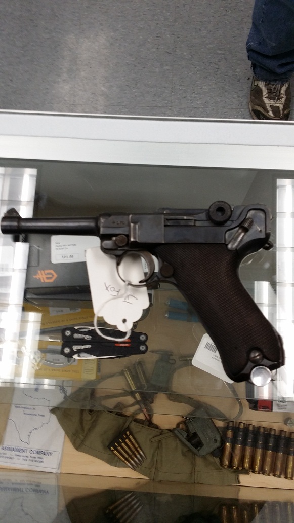

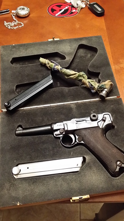

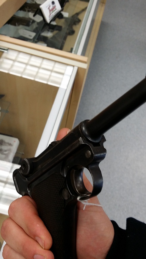

Hi everyone! Long time reader, first time poster! Finally came into a luger for a good price, and was wanting some opinions and info if I could! It seems to be a 1920 DWM in 9mm. Seems to be all matching, even firing pin, but I notice the barrel itself has the numbers 803 underneath, while the receiver and everything else on the barrel has the serial that matches everything else (1574). Does anyone know why or what that number is for? Also, upon inspection, I found 2 eagle and swastika stamps on right side of receiver, one on the receiver, other above trigger. Also didn't know if someone could shine some light on it. It also has a different eagle stamp on the top of the barrel, kind of in the middle. It has the original finish, some pitting on the right side of receiver. Came with aluminum mag but no numbers, and a black mag that seems to be a newer one, along with what looks to be the original cleaning rod and oiler combo. Interesting as well is the box it's in. It seems to be handmade, and has some sort of felt like interior. It's got what looks to be old type round head flat head screws so I believe it's old. Perhaps vet bring back and he made it for the gun to display? From the condition I would guess so. Thanks for any info!! Sorry for the long winded description. I'll post some pics of what it looked like before I cleaned it and after (quite dirty). At work now so I'll include some better ones later! First pic is after I cleaned it and it's in the box. Others were when I first saw it. (It looks SO much better now)

I think I can see a chamber date on the receiver. What is it?
Frankly, this smells like a Weimar military to me, that was later used by the Nazis.
Sieger
Unread 03-20-2014, 08:34 PM   #11
Chamber date is 1920

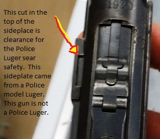

It's a bit hard to tell from the photo, but is that a sear safety I see on top of the sideplate?
Sieger
Unread 03-21-2014, 05:04 AM   #14
Sideplate is unnumbered or commercial with a sear safety cut, but I don't see a corresponding hole drilled in the upper receiver. This would make the sideplate a later addition and not original to the gun.

Default Sear Safety Cut in the Sideplate
The arrow indicates the rectangular cut in the top of the sideplate where the sear safety pin would immobilize the sear when active.
Since the gun does not have a rivet hole in the upper receiver where the sear safety would be installed, this could not have been a Police model Luger. Just a Luger with a replaced (non-matching) sideplate. The number on the inside of the sideplate is an indicator that this sideplate was of Mauser manufacture, and they didn't start Luger production until the 1930's.
