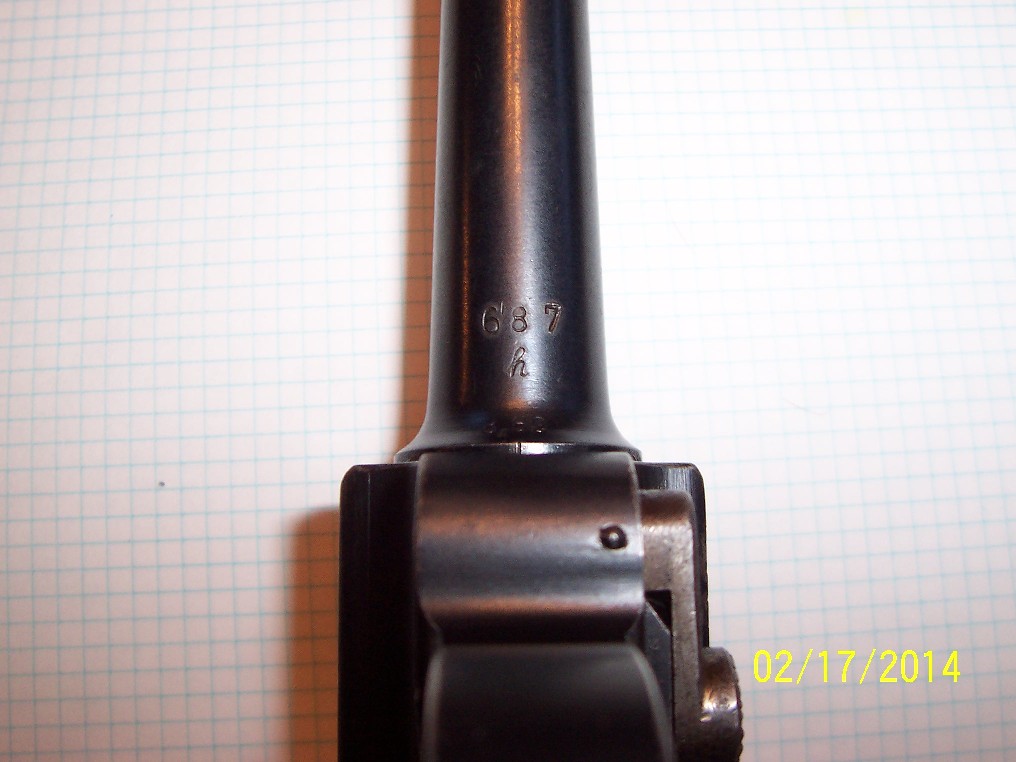

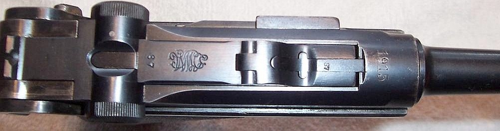

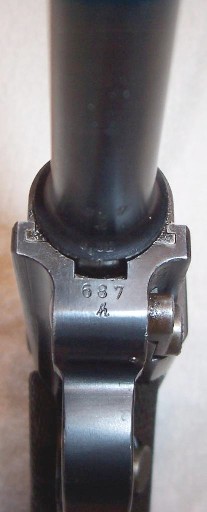

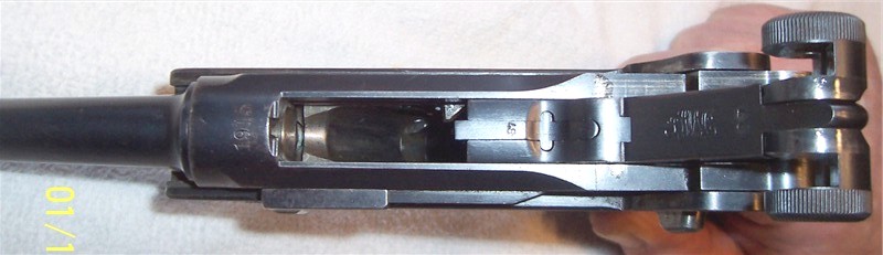

Here are some pictures of the gun and a closeup of the stamp I'm talking about. They aren't great pics but should work. Unless I can justify keeping it for $1000, it goes back on Monday.
What's weird is this is the second gun I've bought in the last month that had just ONE mismatched Erfurt part on a DWM Luger, and with the correct serial number on it.

I have a very nice 1913 DWM with the same Crown M on the sear bar. I have always assumed it was a correct replacement part and has never bothered me. I feel that we collectors ,especially now, demand to much from wartime weapons. Your Crown M trigger would not bother me. Especially for $1000. You are the only one who can make this decision. Bill

I've read all the posts, all in all I agree with Bill, moreover I think that for what I can see from your photos you've got quite a nice gun.
It's true that perhaps we tend to demand too much from wartime weapons.
