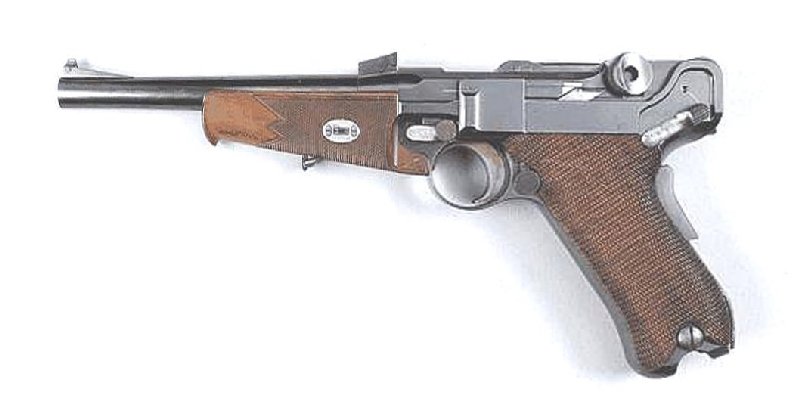

Gerry, if I wanted to shorten a carbine or artillery barrel, could you saw off the front sight band, bore it out, turn down the barrel stub and silver-solder the front sight band back on???
I would try it myself but I am not confident in my ability to solder the band back on without slobbering up the entire muzzle with solder...

I could send you a coil or two of 1/32" D silver brazing alloy from my roll. The small D. would enable you to apply tiny amounts at a time to keep the surrounding area neat. Clean the surfaces to be joined well first, then when fluxing remember more is less. The flux will "clean" the bluing right off if you're not careful; and these areas will risk wicking the solder to follow wherever the flux has been. If you get an errant blob of solder, re-heat this area somewhat to make the alloy plastic, then a quick swipe of a wire brush will remove dimension from the deposit, leaving mostly only a surface coating, which is less work to sand off. Theoretically, the joint should be a .001 or two between the surfaces. Pre-flux, like a plumbing joint and slowly heat until the flux melts and runs, which distributes the flux and its chemical cleaning power to wherever it goes. The flux will probably bubble out a bit, as its water content expands and escapes. Wipe excess unwanted flux off with a damp rag. Heat both sides as evenly as you can, and the fused solder should wick into the joint, leaving very little where you don't want it.
Or you could drive down between the lakes and we can do it at my shop...

I think Rich is asking partially on my behalf as I have a "fat barrel Baby" Luger project that he and I have been discussing and the barrel band attachment is part of the process. He has really been responsible for my thinking about rekindling the project that I started probably close to 30 years ago! Just yesterday he gave me a heads up on a "Fat Barrel" in 7.65mm that is threaded for the long receiver that I need which is being offered by Sarco. I have one ordered so we will see if that becomes part of the solution. I have done quite a bit of jewelry silver soldering years ago but I don't have the tools or ability to do the machine work for the barrel band modification.

To add to what David is saying: I would tin the surfaces first, it seems to help the solder "find its way" to the right place. You flux the surface, then heat it and apply the solder, once it's good and runny you wipe it with a rag, Q-tips or whatever works to get the excess off. This will leave a very thin coat of solder on the surfaces. Slip the barrel band on and put it in a padded vise, with the muzzle up. Apply a little bit of flux, reheat and apply a tiny amount of solder. If everything works as intended, the solder will wick into the seam and fill it completely. It takes a minimal amount to fill the seam, so the thinner diameter solder David is talking about should work well to minimize the amount you add.

...I have a "fat barrel Baby" Luger project...but I don't have the tools or ability to do the machine work for the barrel band modification.
That part is easy (relatively speaking). The band & barrel stub could even be threaded, although I can't think of why anyone would want to...
