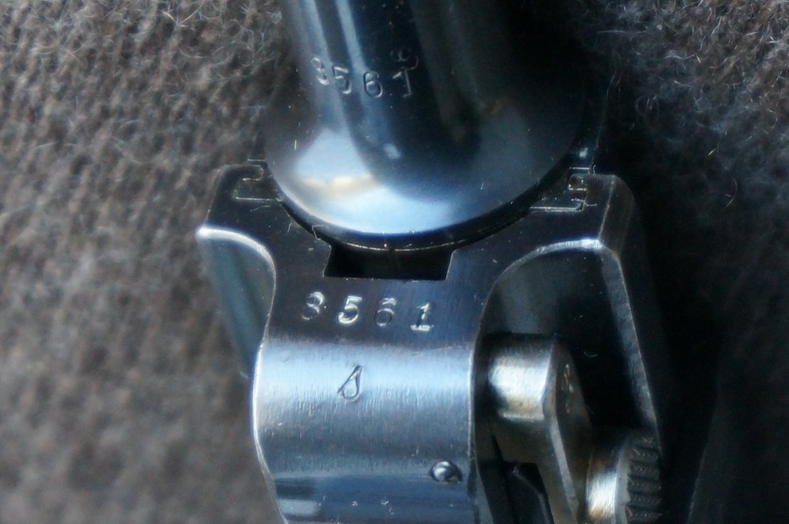

Hello all, Just looking for some info on a luger I recently picked up in a barn sale in Vermont. It's a Mauser, Eagle N proofed, 4 3/4 inch barrel, 30 cal. with strawed parts, Blank chamber.
Has a strange serial number 8561 S. From all I can find, it should have a V after the number. With a matching mag.
The blue is in very good shape, about and as far as I can tell it has not been re blued. all numbers match.
Just wondering if anyone has seen or heard of anything like this. I cannot find it in any of the books. I'm not sure what it's worth.

But, assuming you know it is a Mauser made Luger because it has a Mauser Banner on the center link and the data on the caliber and barrel length are correct, my SWAG is that it a part of the limited s-series. The Eagle N means it was made after 1940.
1. We know Mauser made some pistols for the Swiss. Some have Crown N and some Eagle Ns which is the Oberndorf Proof house. Some have the Berner Prob as well.
2. There are only a few known s-block Banners and all that I am aware of came out of Switzerland.
Therefore, my SWAG is that this might be a Mauser Banner Commercial made for the Swiss market some time after 1940. I am not aware that we have Mauser production records for the quantity made but I suspect that there were not many. The s-block is an odd lot and contains a mixture of markings and parts leaving one to believe that they were made of parts laying around Oberndorf and not used up by the military.
Again just a SWAG.
John

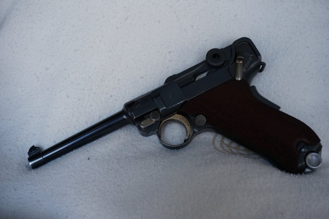

pictures of mauser barn find

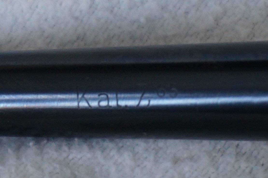

Yep!! Now, virtually certain that it is a late Mauser Banner shipped to Switzerland.
Some of the few observed specimens have had the Kal 7.65mm barrel seen here but most do not. In any case ,the series is a mixed bag with respect to specifications.
See Mike B's posts as he has a s-series Banner.
This series also written up in Joop and Don's book.
John

I don't know enough about this variation to make an assessment concerning originality. To me it looks good and is one heck of a barn find! If it is indeed original it has a value in excess of $10,000.

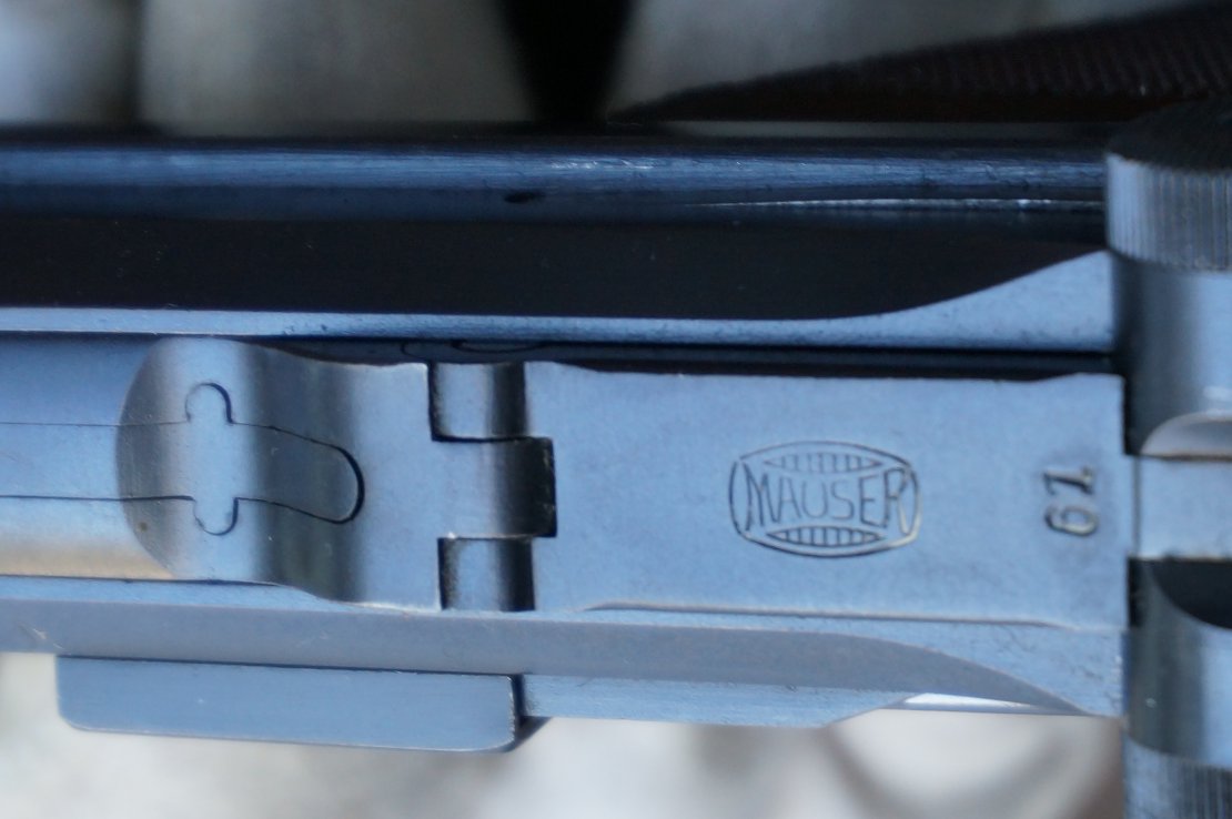

should this have a Mauser hump?
Short answer is no.
Also note the position of Gesichert.
Just FYI, serial number 8319 s may be found on page 485 of The Mauser Parabellum. A twin of the gun in question here.

thanks. between the strawing, the lack of hump and the 7.62 cal I wasn't sure. But then I'm not a resident expert here. I lurk a lot and try to learn but alas I forget more than I learn these days. this is indeed a rare bird.
