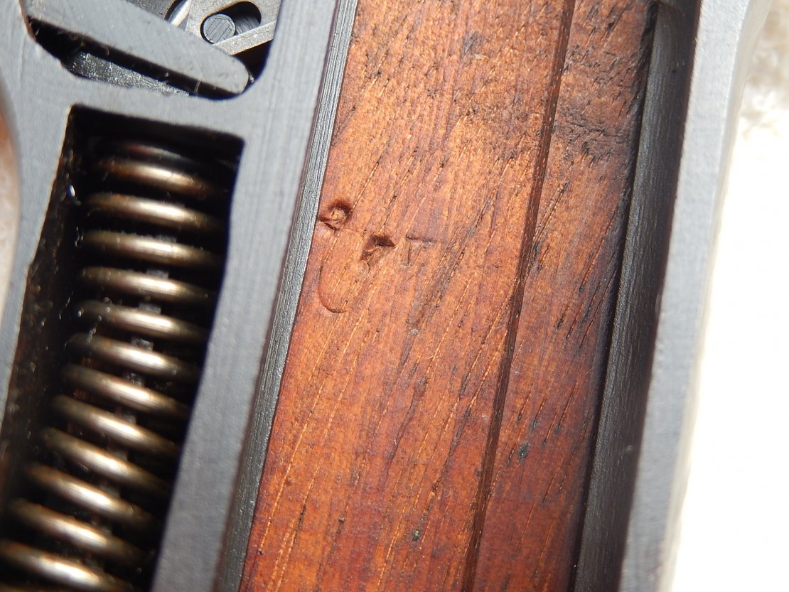

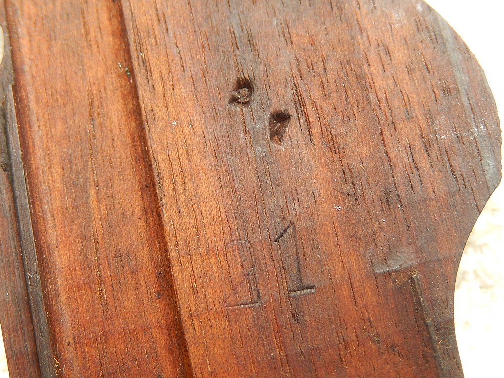

Hi, Guys,
I am new to the forum. I recently picked up a BYF 42 Luger that is in very good shape. However, I have a question about the grip serial number marking. The last two digits of the serial number end in 21. When I removed the grips, I noted that the right grip has 21 stamped twice----in two very different fonts. The left grip has 21 stamped in the smaller font, and 07 in the larger font. What are your opinions on this ? |

the small fonts look the same to me, but I did not blow them up

Ed...I would agree, the R and L small fonts look the same. But I have never seen them driven in so hard...and never seen two sets of numbers on each grip. Also, the larger numbers appears to be older and NOT matching (07 and 21). I can think of no good explanation for how this might have happened...other than being messed with. Is there any possible way for these to be "correct" on the same pistol? Also, isn't it a stretch that both numbers on the R grip are 21...and two different numbers on the L grip?

I think you have it!! I also think they have been augmented (messed with)!
![]() Usually the small size font stopped in the early to mid K-Date production. After that, in Military Mauser Production, the larger numbers were used. |

I don't think anyone here thinks you altered anything on your grips. these Lugers are 70 plus years old, and the grips may have been switched any time in between. Including war time. Who knows? Grips are the least expensive part to replace on a Luger. And on a BYF 42 even easier to find because most were not numbered or had the black plastic grips. Would love to see a photo of it. Bob |

Here you go... (a Joe Salter photo)
