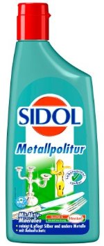

Many years ago I remember that I cleaned old cartridges with "Sidol" an Henkel product, I suppose in the States you must have something similar (Brasso ?) its some sort of yellowish creamy liquid to rub with a cloth on the brass, let it dry for a few minutes, then clean your brass with another (clean) cloth. If in he bullets there is still the gunpowder do not use the tumble cleaner.

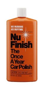

If those old cartridges were mine, I would put them into my tumbler with corncob and brass polish and give them a good cleaning. Some handloader use a liquid car wax, like NuFinish(cheap to buy) in their corncob media, and they feel that it not only cleans the brass, but it deposits a coating on the brass that help keep it from tarnishing so quick.
My 2 cents.
Thank you all.
my intention is to clean the bullets for show. i will not be firing them! I found both on Amazon!!

I found couple other techniques discussed:
Lemi Shine (from Wallyworld). It's a detergent used in dishwashers. It will make them look like brand new
Tumbling will not hurt the bullets at all. They are simply sliding around in a nice soft corncob mix. What could possibly hurt them? I polish bullets like this all the time. Put a little Nufinish polish in with them and they'll look like new in about 30 minutes.

I'm glad you've found "Sidol" to clean brass, to me it was quite useful, although it takes a lot of patience to clean all the cartridges, and then wipe them all, but the results were quite good.
With charged cartridges avoid any sort of tumbler.
