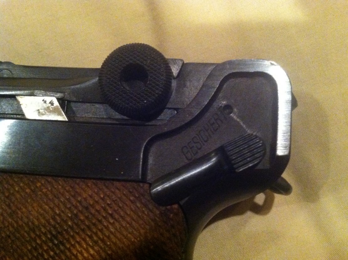

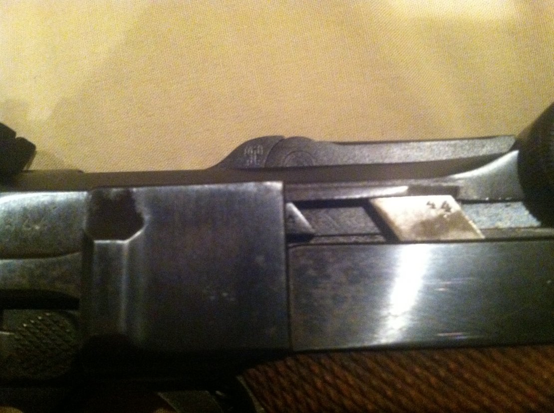

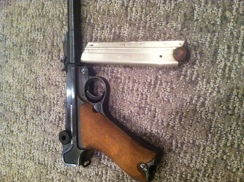

Hello,
I just made my first purchase of a long barrel Luger LP08. At the time that I purchased this gun, I paid $3900 USD. I am not sure if this was a good buying price or if the weapon has any significance. The bluing was really good (almost too good) but the gun did not have a matching magazine or holster. I would appreciate any help on knowing if I made a good purchase and if the gun has any collect-ability. thank you and the best!

Your pictures are a bit blurry, so I hesitate to say this, but can you get your money back?
Thats a lot of money, especially since it looks reblued?
The trigger, safety lever, take down lever, all should be strawed or at worst, bluish from age....

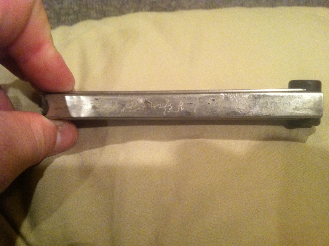

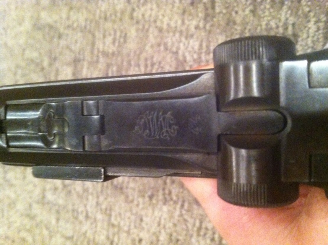

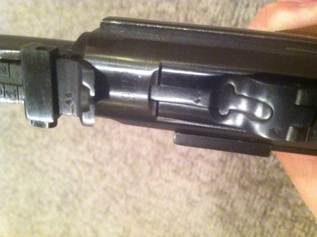

Great, just my luck. Unfortunately I cannot get refunded for the gun. I bought it at a gun show last summer and paid in precious metal. About a month later, I also noticed the back of my magazine had been hand engraved very poorly. Here are some better close ups of the gun. I do not know if these areas will help. Than you for your help!

Welcome to the forum. Usually this greeting is accompanied by congratulatory statements concerning the latest member's recent acquisition. I feel for ya Brother, but my opinion, based on the pics is that it was re-blued after some buffing, some sandblasting, and some filing or sanding, which takes it down an order of magnitude to shooter grade, albeit, basically, a very nice looking shooter--compared to what it might have brought even with a faded or worn finish.
Here are the points involved in deducing this. 1.)When I first came to the page and the first pic popped up, the first thing in my head was "re-blue". This first glance's impression was because of the general "softness" to the look of the top of the pistol. It does not take a lot of buffing to have this result--surfaces not flat, and edges not as sharp and straight as they should be. I considered it might be the focus of the pic, but no. And, sure enough, 2)the tiny retaining pin for the toggle's knee joint is blued. It should be "in the white" (unfinished). During re-blue, the technician apparently did not disassemble the knee joint and set the pin aside to be re-installed after the two links were finished, as consistent with factory assembly. Another area that is commonly blued by an inexperienced technician when it should remain unfinished is the inside of the frame, visible only after the top end is removed. If you field strip yours, I'll bet its guts are also blue, improperly. 3) The surfaces of the areas on the sides of the "ears" of the frame seem to have been sandblasted. They should, however, reveal the tiny swirls left by the end mill that was used to create these planes, or the evidence of very fine hand work used to smooth them (The latter more-so on commercial and early guns) Finally, 4) The edges of the ridges that border these areas look inordinately sharp and flat, and have a definite grain, as if the sides of the frame had been run across with a sanding belt, or block. 5) Ed already mentioned the small parts which were blued instead of heat treated to straw color. There may be more, but this is enough for now.

Sorry to hear of your misfortune - definitely buffed and reblued, but it is still an artillery Luger, which are very popular as shooters.
$1300 - if it shoots good. But you should sell the mag separately and get a cheaper/newer repro mag to shoot with or sell with the gun (you can easily sell the mag here or on ebay). Don't shoot it with the original wood bottom mag, you can break it.
