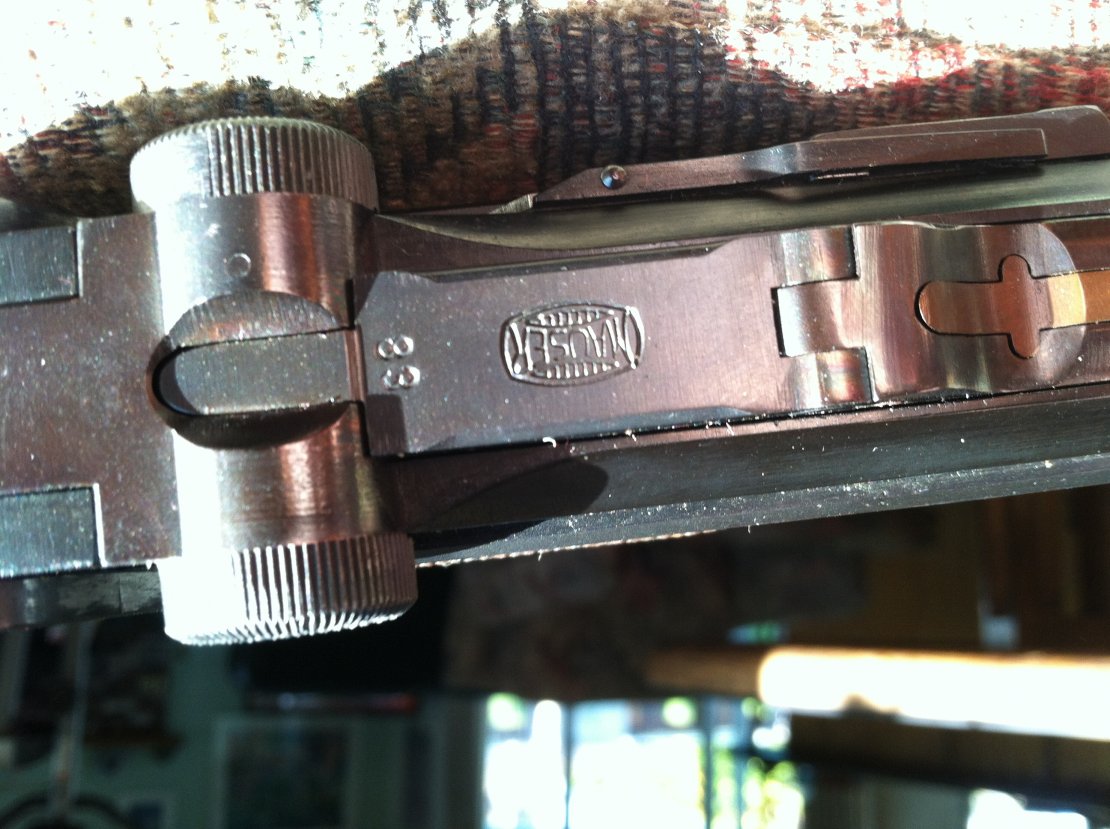

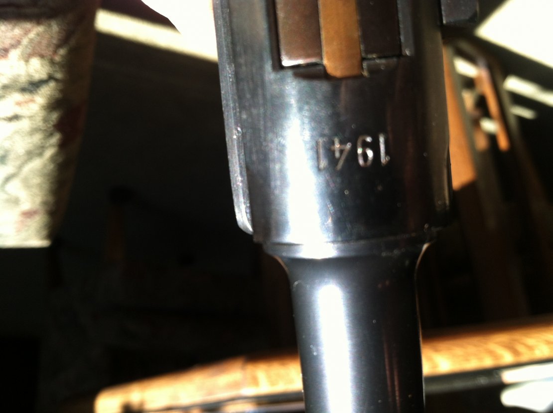

I have a cousin that recently found one of those mystical attic finds. A 1941 Mauser manufactured Luger from WWII. Condition is near 99% and all the numbers match. This thing has spent the last 60+ years in a oil wrapped cloth in the corner of the attic. I've looked up the value in the BBGV at about $4k. My question extends to how the magazines, holster, and lack of any import stamps affect the value. He has all three matching numbered 1-2-3 magazines and the issue holster. The BBGV says to add 75-100% for two matching magazines, what about the third? I've added some photo's to hopefully help. If anybody has some additional information, it would be appreciated. At this point he's not looking to sell it, he just want's to make sure it's properly insured.

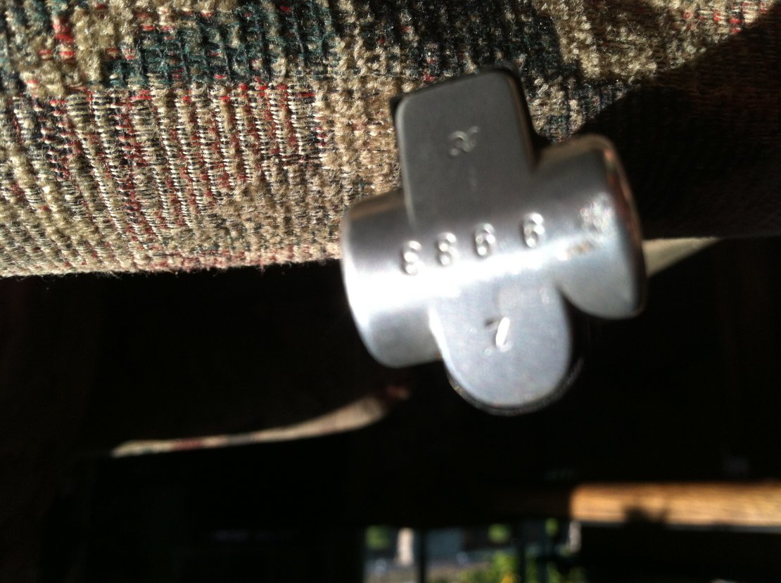

I would like to see all three magazine bottoms, easy shot of all three on a table, base showing

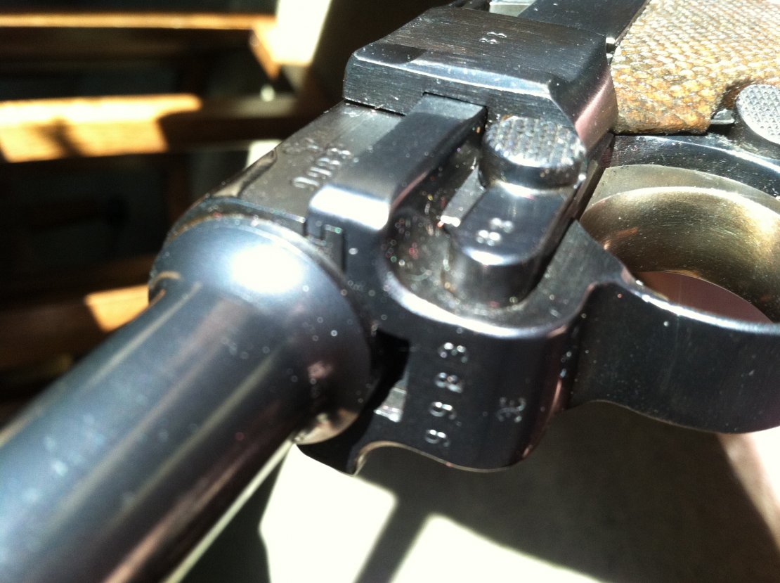

I don't recall seeing the orange/red extractor on a Mauser Police Banner before. Reblue?
Love to see pictures of the 3 magazine bottom serial numbers.

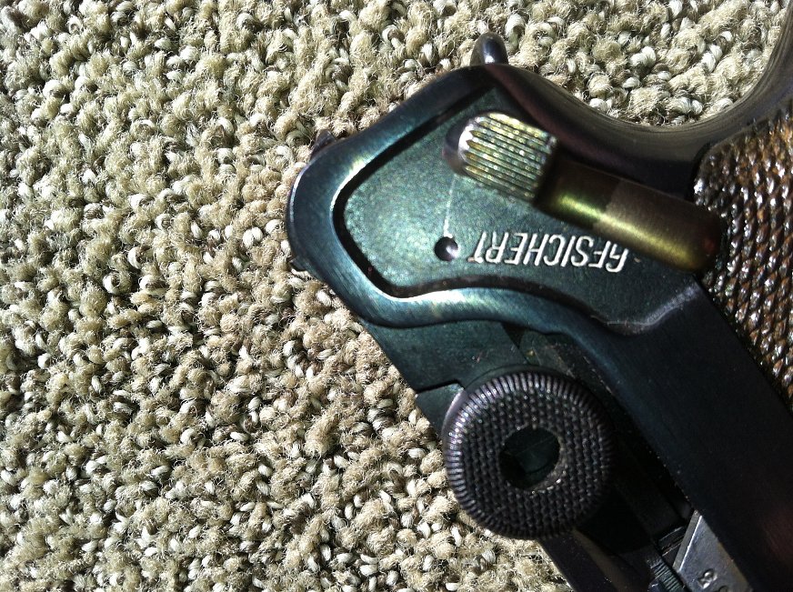

Is the trigger and safety lever strawed? Looks like it from the pictures? Bill

Is the rivet on the sear safety blued?

Like Ed said, to get a proper guesstimate, you need some better pictures - full right, full left, full top, front of frame, and rear of frame.
At first glance your pistol looks beautiful, but a more careful observation reveals some inconsistencies. Based in what I can see in these pics, this looks to me like an incorrectly refinished Luger.
The sear safety rivet/pin is blued, but these are never blued.
The trigger, extractor, and safety lever are strawed (or painted?), which is incorrect - these small parts should all be blued the same as the finish on the rest of the gun.
The GESICHERT (safe) stamping is too white and so looks to be very recent. It could be a white lacquer pen filler that you someone put on it, but that kind of conflicts with the "hasn't been touched for over 60 years" idea.
Also from what I can see in these limited pictures, there is ZERO wear in the spots that should have some wear - combine this with all of the above, and it looks very suspicious to me.
You say it has been untouched for over 60 years - do you know that for certain? I mean it is possible, but I would seriously doubt the refinish/strawing was done in the late 40s/early 50s.

I'm down with most of this, however will reserve judgment until we see the comparative pic of all three mag bottoms. The way they are numbered (1-2-3) is police; military would be serial # only on the first, a + on the first spare and ++ on the third mag. I think a military rig would only include 2 original mags for the period (wouldn't a ++ mag only have been issued on a much earlier artillery rig?). In the new mag pic, we will be able to see of the fonts and style match, also see how much grinding/tampering was done to number them as matching, if any.
