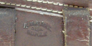

If it is of interest to anyone. I have had this one for some time and am posting it in case it is of interest for historical reasons.
A picture the front and the back and a letter with a note from John Walters as to the unit designation.

Interesting is the first 1910 dated Luger that is mentioned in John Walters letter.
Jan Still shows a 1910 dated DWM with number 3452c and unit mark B.l.M.K.D.57. in CENTRAL POWER PISTOLS: Both Lugers are listed on the 1914 dated Landau list.
Thanks for sharing.
