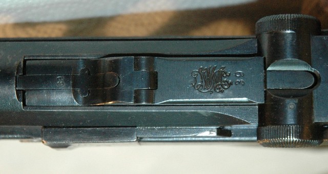

The Set: The pistol is a 30 caliber (7.65mm), with “Hard Shell” holster, and two (2) clips. This pistol has a 3” barrel and the top of the toggle is marked with “39” and the “DWM” scroll imprint (no dates at all). The pistol appears to be original finish (blue) with some rubbed areas on exterior and a few lightly pitted areas on frame where grips touch frame. The “Hold Open Latch” (marked “39”) is there, but the right-angled tab (facing toward the chamber) which actually holds toggle open has broken off and is missing.

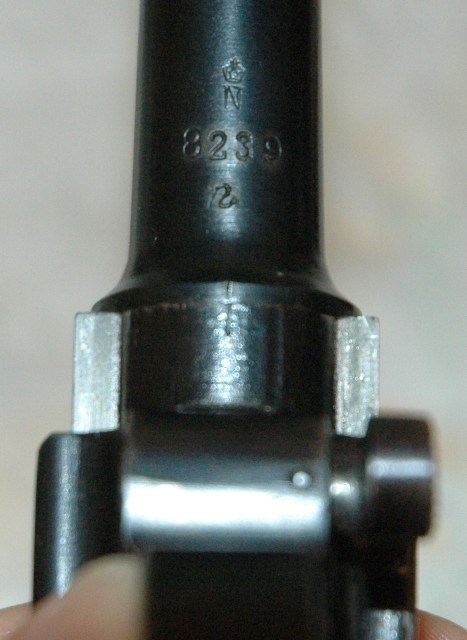

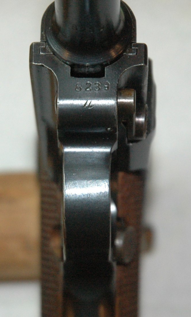

Other Markings: Under the barrel there are three (3) markings: A “Crown” with pentagon; a large “N”; the S/N “8239“; and then a curving script type marking almost like an “Infinity” mark. At the mating of barrel and chamber, there is the mark made after barrel was fully screwed-in and tightened (appears to be intact and original indent showing no changes to barrel). On the frame below the chamber, there is the S/N “8239” and that curving script type marking almost like an “Infinity” mark. Inside the frame (machined out area), forward of the chamber, there are two marks which appear to be a “W” and possibly a “N” or inverted “V”.

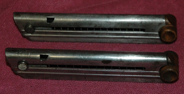

Magazines: One with S/N “8239” and “P”; the other is S/N “9969”, and what appears to be a letter “h” in cursive script. Both magazines are bright metal, with tight grain (maple?) wooden base caps which are in very good condition, and the springs are in excellent condition. There are a few slight discoloration spots on the metal of the magazines.

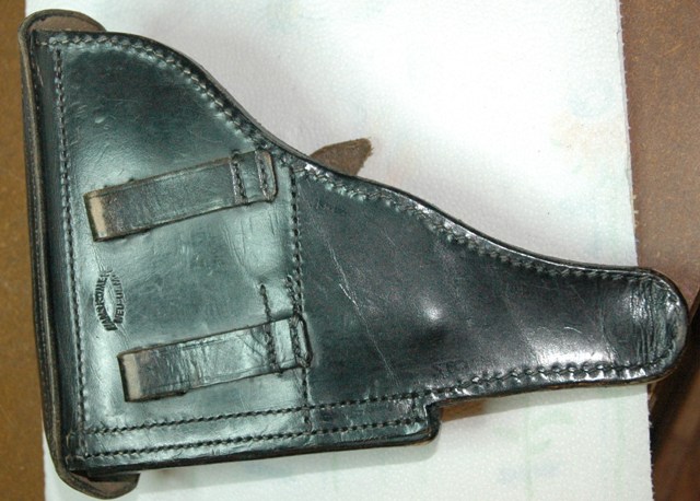

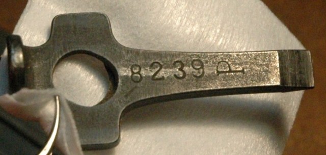

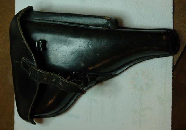

Holster: Black leather “Hard Shell” with inside flap pocket for the pistol tool. The pistol “Tool” is located in the top of the holster flap, and is marked “8239” and the letter “P”. The flap pocket is in excellent shape and is still tight to fasten down over the post (button). There are two (2) belt loops on the reverse, and a belt type fastener to hold the hard-shell top down. There is a leather strap on the inside of holster, with tab showing outside for lifting the pistol upward in the holster. The black ink markings on inside of top shows “R.B.D., Stuttgart, and 1939”. The indented markings on the reverse side of holster are: “HANSROMER, NEU ULM”. There are no other markings on the reverse side. The front edge of the holster has the additional magazine holder which is in excellent condition. All stitching is fully intact and tight.

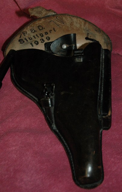

In several decades of being interested in Luger holsters I have never seen an interior marked this way this large. This might have been issued to the very elderly..they need large print.
The initial do not spell out RAD.

Were any commercial guns sold with serialized magazines and tools? Is the p on the magazine and tool supposed to be the suffix or does that have other meaning?
I'm thinking that the organization re-numbered the mag. and tool to match. Normally I'd be yelling "foul" about now, but this one may have an unusual history.
Unread 10-29-2013, 04:44 PM   #5
David..I wonder. Just because I have never seen it doesn't make it necessarily suspect. I actually like the mag and tool markings..P on Swiss mags mean Private sale. I don't know what this may mean. The serial on the BACK of a tool normally means Police but no Police indicators here.
The matching mag, 8239 appears to be a late beech wood.

The ink stamp at first looks to be RAD but blown up it looks more like RBD? or RBO?
Unread 10-29-2013, 06:40 PM   #6
Need a better photo! Also looks like it might be P. a D.

I really appreciate the feedback so far. I am posting-up another photo of the inside of the top flap of holster, showing the black markings inside. I hope this clears up any confusion over the markings. If anyone needs additional photos, just let me know.

My memory is a little foggy on the subject but wasn't there railroad police organization something like Reichs Bahnhof Direktor?

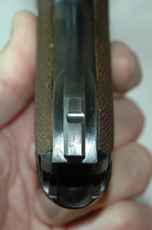

I just read some things about "Stock Lugs", but not sure if that helps anything with my friends' DWM 30 Caliber set. I am uploading additional photos: (1) Front of frame markings; and (2) Two photos of what I believe you guys are calling Stock Lugs. I am not sure if the Stock Lugs (or marks at front of frame) helps to confirm previous answer about our gun being a "mid-1920's Commerical - Alphabet gun". Also, does anyone care to speculate as to how a mid-1920's gun may have been paired with this 1939 Hard Shell holster marked R.A.D. and Stuttgart? Someone has mentioned the letters may be for "Reichs Bahnoff Deutschland" or Railroad Police. As mentioned before, I really appreciate the help with this project. THANKS!

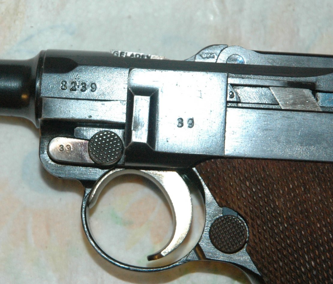

I just noticed another mark on the 30 Caliber DWM Luger set that I missed previously. On the left side of the frame, somewhat superimposed at Serial Number, is another "Crown" and "N". I am not sure if this helps in confirming the 'Mid-1920's Commerical - Alphabet" or not. Additionally, this photo shows the "Round in Chamber" indicator (Geladen) which is why I took the initial photo - I just did not see the Crown and N in that shot before. If anyone needs any additional information or specific photos, please don't hesitate to ask and I will respond. THANKS!

The Crown/N is a typical, commercial Nitro proof and correct for your pistol
