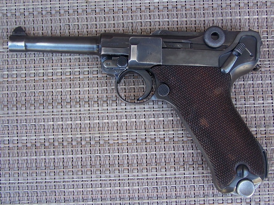

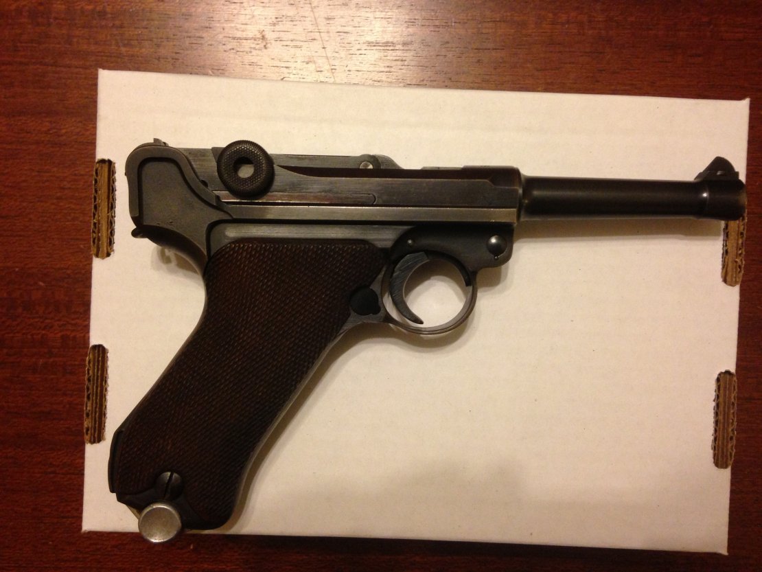

Unread 08-29-2013, 10:57 AM   #6
By 1939, Mauser was salt bluing their Lugers, including the vast majority of the commercial ones.
From what I can make out in our pictures, your's looks right as rain...
Take pictures without using the flash in indirect (shaded) sunlight outdoors. They will show the finish more accurately. Use a tripod and the camera's closeup setting to get sharp pictures.
BTW. a 1934 Mauser is a pocket pistol, not a Luger. "K" date Lugers made in 1934 had strawed parts, as they did until the change over to salt bluing during 1938.

ok thank you, i was kind of worried about the straw blueing, mine def dont look like it was reblued I will try and take some better pics. thank you for the info

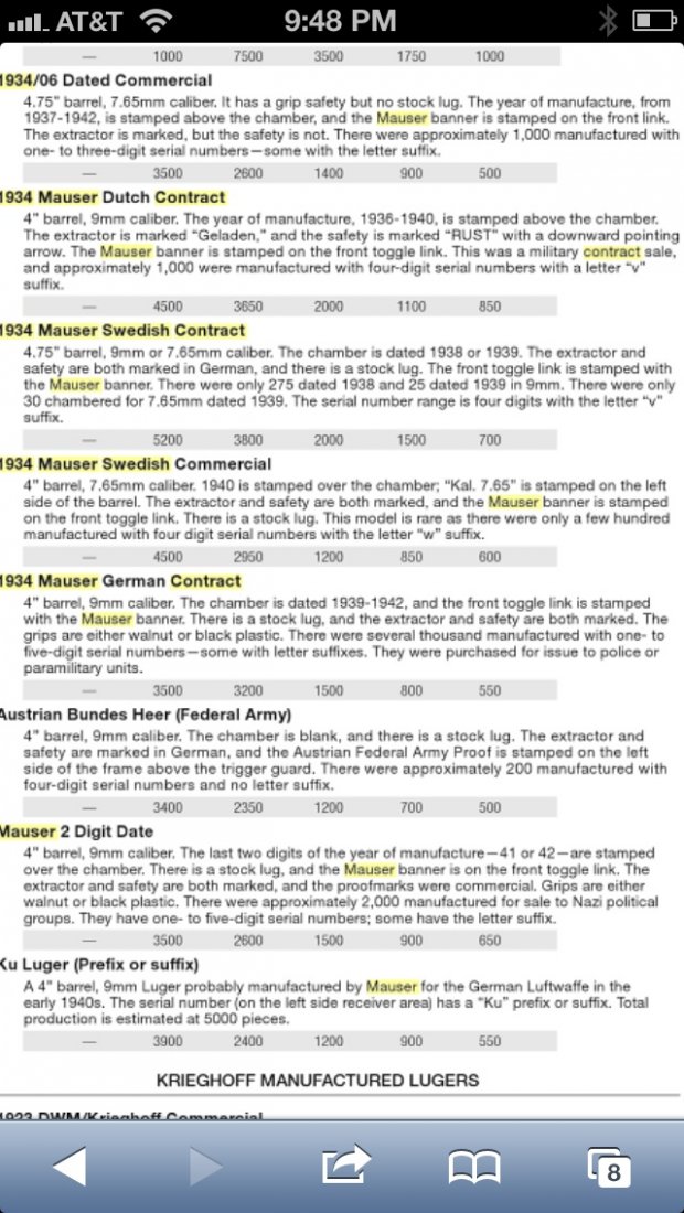

I did some research and my gun matches exactly as a Mauser Swedish contract. I attratched one of the references below, tell me what you all think. If it is there were only 25 made in 9mm dated 1939.

Never mind I measured the barrel and its only 4 inches. Dang

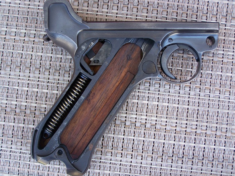

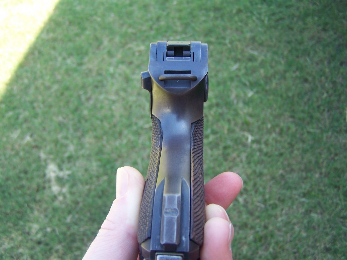

Unread 08-31-2013, 06:00 PM   #18
Don't know if you are interested or not, but our own Hugh Clark could really clean up the grips, clear the flat spots, etc.

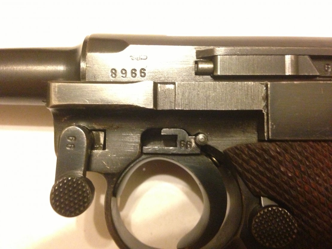

Unread 08-31-2013, 07:04 PM   #20
guns3545
Join Date: Aug 2006
Location: Florida
Posts: 438
Thanks: 661
Default Serial number siffix
Originally Posted by stimg367 View Post
pics 2
Apologies if I missed it; but what is the suffix of the gun?
As you know there are many variations of the 1939 Banner but a lot of research has been done to isolate which contract or use was intended.
We can deduce a lot from the photographs you have provided but the more details the better.
Thanks,
John
