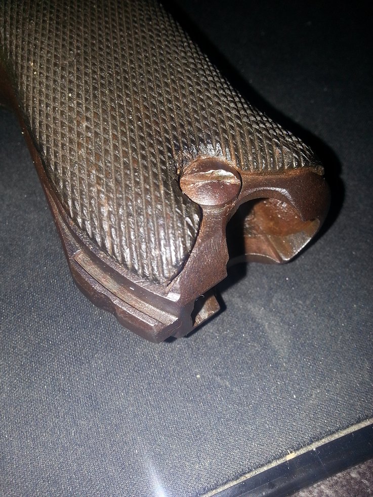

Hello guys.
I recently acquired my first P08 that I plan to take down and clean off surface rust with 0000 steel wool. I noticed strait away when I received it that both the grip screws were fairly mangled and I have my doubts as to weather they will last if and when I manage to get them loose.
Two questions I suppose,
1 - Are the screws hard to come by? I have had a look on the foresale section and couldn't find any.
2- I would assume submersing that area of the gun in some sort of oil might help loosen up the screws but I don't know weather that will damage the possibility of resurrecting the grips, any advice would be great.

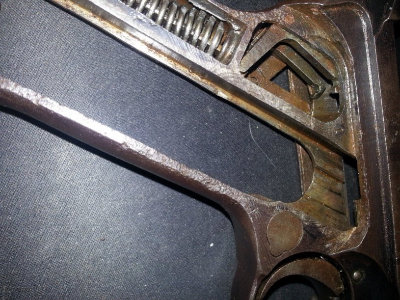

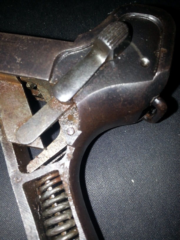

Default Update
Hello Gents,
I though I would just give you an update on the progress so far.

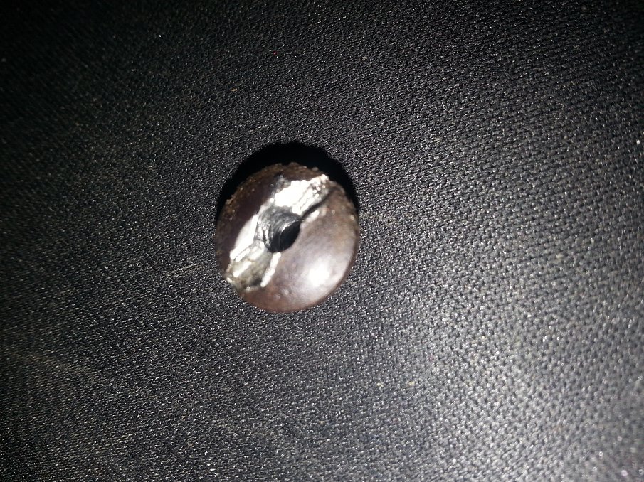

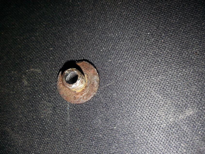

The screws are off thank god that was an ordeal ... first one( right hand) came off after a few goes with some WD40 over a couple of sessions with a couple of convincing taps with a hammer.
Second one (Left hand ) no such luck applied the same scenario as above but was so intent on staying put i ended up burring off the groove and put a slight bend in the frame just enough to stop insertion of the magazine. in the end I drilled through the center of the left hand screw and used an easy out to remove it.

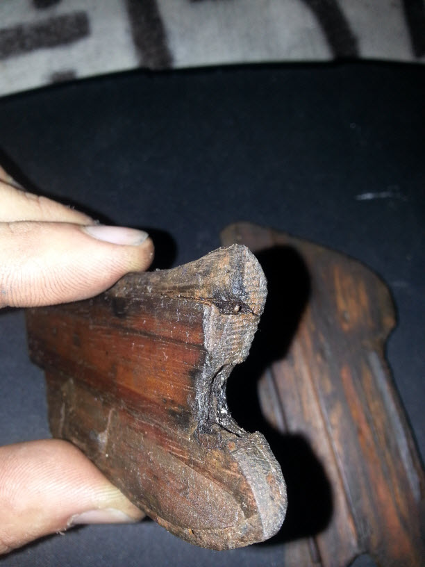

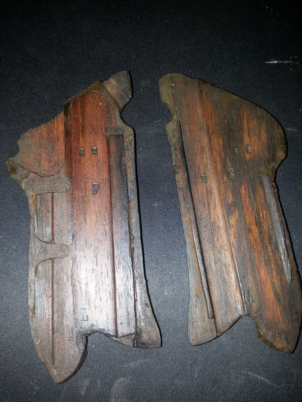

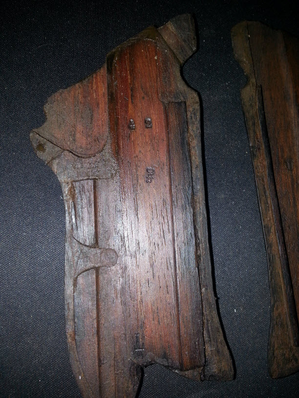

The grips turn out to be matching as per the numbering which seem to be in not bad condition damage wise with exception of a small crack forming on the bottom of the left hand one.

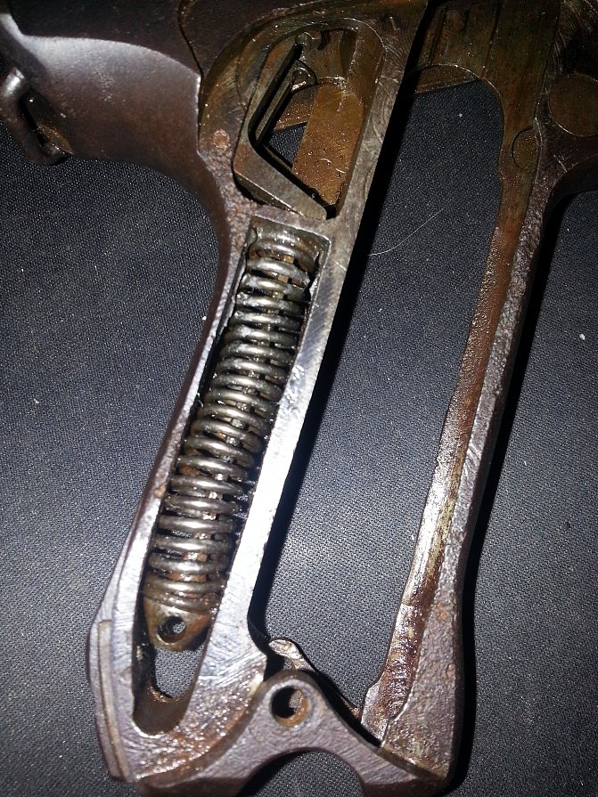

The grips I assume had not been taken off for some time if not at all in the last 96 odd years aswith in the pictures I have provided you can see the pitting on the frame, is there any way to treat this to stop it from continuing?
Peg
remerus is offline   Reply With Quote

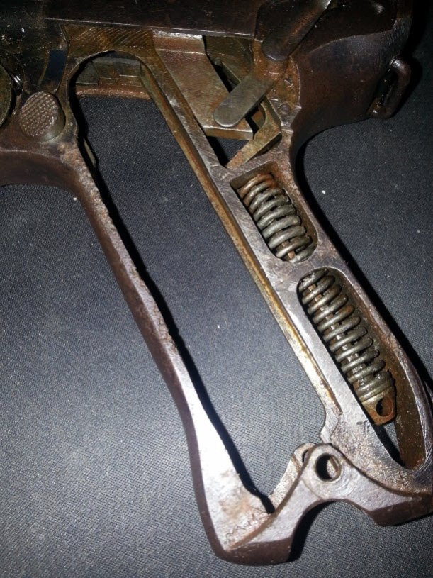

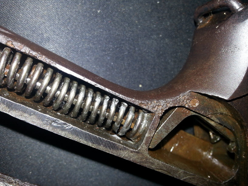

Default more

Glad to hear that you were able to get the grip screws out. they can be a real 'pain" as you have experienced. If that Luger were mine, I would totally dismantle it to a bare frame, and then treat the rust with a lightweight gun oil on 4-0 steel wool. It is going to take some time, but it will remove the rust, and leave any bluing that might still be present under the rust.
If you plan to refinish your Luger, then I would beadblast it with a very fine(less than 60 grit) abrasive. that will remove everything off of the steel.

Seems like you have a pretty even coat of brown patina, so If you're planning a refinish you can try and boil the parts in distilled water first. This will make the rust turn black, just like when you rust blue. If everything has an even patina, you might end up with a finish nice enough to keep as is. I have done this with some parts I just wanted to "freshen up" without refinishing them, and it works quite well.
Sounds like an interesting idea Olle. Tell me how long do you boil the parts for when you do it? I would assume also you would need to emmerse the parts in a good mineral oil for some time afterwards to displace the water?
