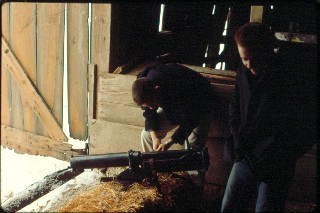

Unread 07-11-2013, 11:41 PM   #11
MikeP
MikeP's Avatar
Location: ILL
Posts: 686
Thanks: 36
Training or even a firing range.
Lots of folks who never bothered to do their service misunderstand he concept of training.
It never stops. They might get to limber and unlimber that rig a hundred times or so just to get good at it for when things get real.
I had an 08 in high school. it had a cobbled up ground or trench mount.
It had no booster, but actually fired pretty well.
I only had an old US belt of some kind and we would cram 8mms into it and it would fire 10-15 shots without jamming up.
