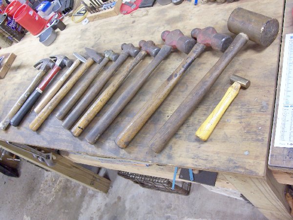

I think we can all agree that the proper tools are essential for any aspiring gunsmith...
I like the 2nd one from the right!!!! That is George Fortier's favorite gunsmithing tool!!!!

Hugh..I have to disagree..George wouldn't use a BRASS hammer! Or one that small...
