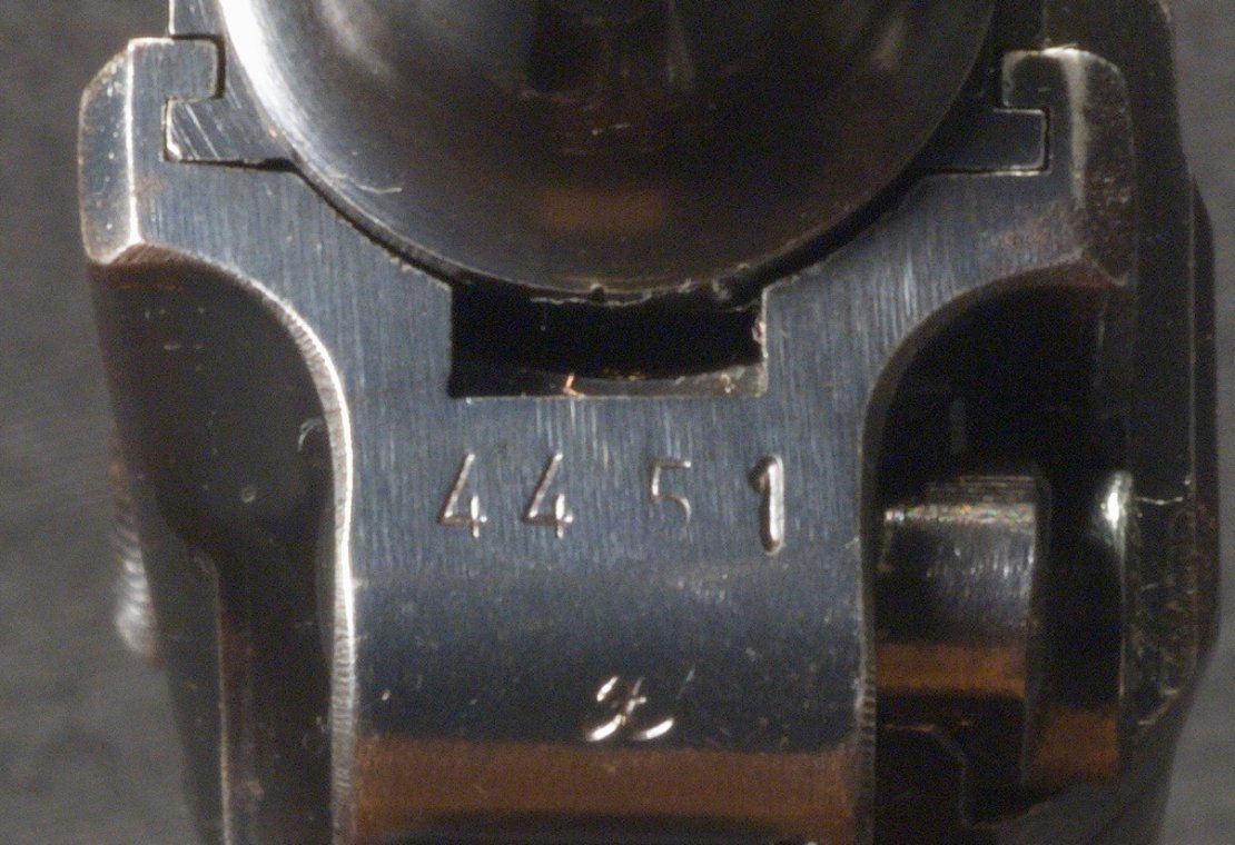

Checking inside the side plate would be the first thing I'd check on if you're concerned about a force match. Sometimes you will see inconsistencies with Mauser s/n stamping.
I have two that have anomalies. One is inconsistently deep. The other has an overstamped digit (the adjacent digit stamped in the wrong position, then overstamped with the correct one).

Mauser used mixed fonts, you can find ones ("1s") with and without horizontal feet. Added to this the darn side plates often look like the grain goes the wrong way. It gives you the impression of forced matching, but it's not!
This drive me crazy and even though as a collector you should spot this sort of thing, in this case it may mean nothing.
I suspect that Mauser and DWM used assembly stations differently and the result is the mixed fonts- just a guess on this but it would explain how this happens so often.

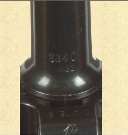

The serial number on the barrel is very near on top of the barrel gauge. I don't ever remember seeing one this close before. Also, to me, the 5 on the sideplate could be suspect as compared to the rest of the pistol.
