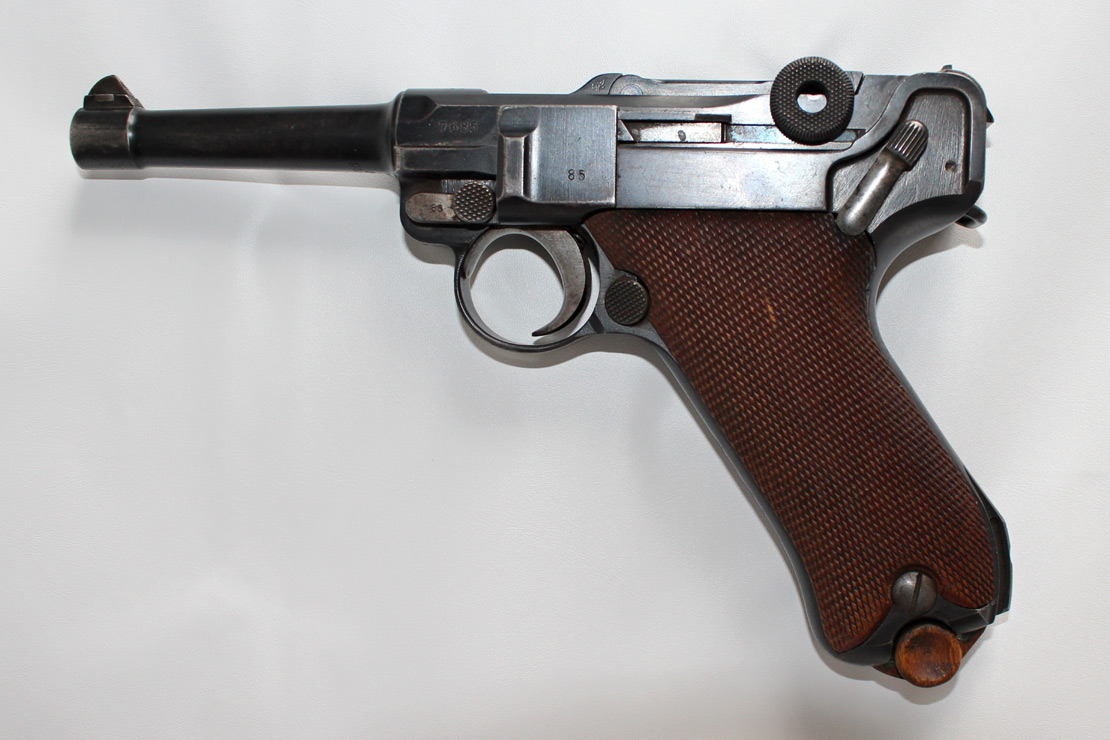

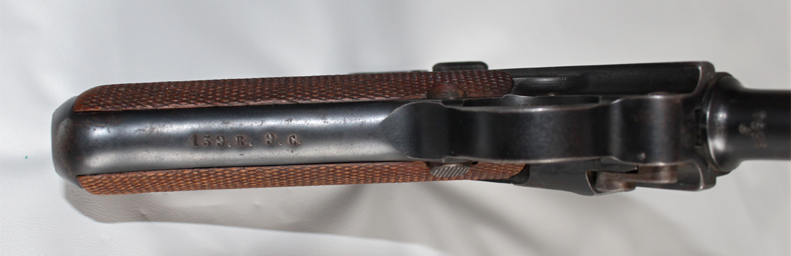

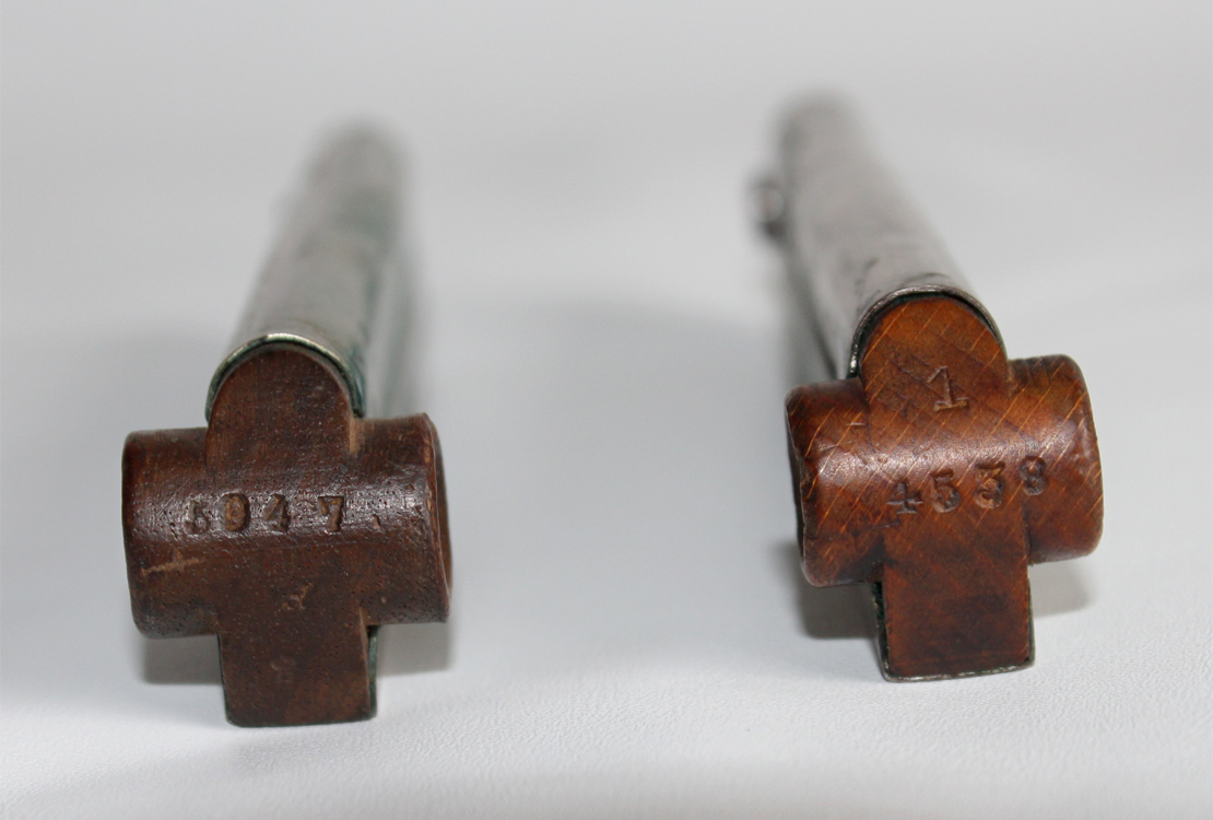

I have a 1916 DWM Luger that my late father acquired from someone around/after WWII; overall it is in what I would say appears to be in very good condition. Serial number below barrel on front says 7685 and 85 appears in many other locations; only mismatch I've found is on the rear portion of the cocking lever that says 46. There are 2 original mags w/wooden bases, one marked 5847, the other 4558. The front area of the pistol grip is stamped with 139.R. 9. c. Also have brown leather holster with imprinting on the back that says: Auwaerter & Bubeck, A.G., Stuttgart; Also has a date printed that says 1936. There is a ½ inch cut off the bottom front tip, likely with a knife from the looks of the sharp edges of the cut; not sure the reason this may have been done, (drainage/air flow perhaps?). Also, does anyone have an idea of an approximate value and also if it would hurt the value to clean and oil this gun? |

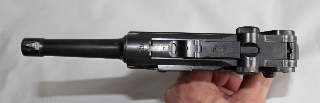

It is going to be extremely difficult to give you a reasonable estimate of value without photos. These photos need to be close ups of the serial numbers, proofs, top, sides,front of grip strap and also views of the holster.
We already know from your statement above that it is a parts gun since you have parts with serial numbers different from the frame and barrel. That reduces value as it is not of collector interest in this condition. It is placed into a "shooter" category, but the value could still be significant with that holster and the wood bottom mags. Without photos(good ones that show detail) it would only be a guess. |

Don't jump out the window just yet. There are shooters and there are shooters, and a nice gun with one mismatched number will be worth more than a totally mismatched gun.
Send us those photos, as we'd love to have a look. Holster too. It will not hurt the value to carefully clean and oil the metal. YouTube has excellent instructional videos of the disassembly process. Just be very patient removing that left grip panel from the frame. Lift it straight away and it will chip. dju |

About the gun, we still need to know more about the internal numbers to be certain that they match. If that rear toggle link is the only stray part, just remember that one of every 99 out there is the one you need. So do you want to sell or just understand its value? Probably worth more to you because of the family connection, and once you sell it, it is gone, gone, gone. If someone approached me with that gun and holster, I'd want to pay no more than $900, but a new guy wanting their first shooter/low end collector Luger might give you closer to $1100. And I admit that I am a card-carrying, bottom feeding, cheap S.O.B. That's why I have more guns than regrets. But let's see what the others say about that. And the book guys can tell you what the grip frame "unit marks" represent too. Nice gun. dju |

It looks likes nice one. Is the rear toggle the only mismatch? Because if true, it's a good one. Nice army and a police mag too.

Glenn..Yes..nice pistol. I wouldn't worry too much about one mismatched number if that's all..unit mark is nice.
The holster is unfortunate. God only knows why someone cut the toe. Other things wrong with it could be fixed but the toe cut is a toughie. Only thing to do there is to cut a piece just like it from a dead donor holster and fit it in. Beautiful magazines!

As to the magazines, it is the reverse. The one with the large "1" is the police magazine and the other one with the small acceptance stamp would be the army. As to the holster, 1934 dated holsters are scarse and collectable. If it were mine, I would send it to Jerry Burney for repair and preservation. The small pocket inside is for the takedown tool, as you stated. The cut at the bottom of the holster may have been to remove an area that had frayed through. The leather on the back of this lower section is oddly wrinkled and may have been the result of water immersion or heat. The halos around the barrel numbers indicate that the finish is original. The gun is in very nice shape. If all the other numbers match, finding a rear toggle link with the right number would not be impossible. I would start with the site's "wanted" section. Congratulations on a nice heirloom! |

@Doug: Thanks for clearing that up for me, I thought the numbered mags were the ones for military use.

You photos reveal a very nice looking apparently original finish Luger. That is a dandy. As you break it down for cleaning and lube you can check the internal numbers on the breachblock, the firing pin,grips, etc. If it is all matching except for the rear toggle link, then if it were mine, I would begin a quest for that part to make the Luger whole. As stated, one out of 100 rear toggle links had that number on it. I would start by placing a want to buy in that area of this forum. You should be proud of that Luger, I know I would be. |

I'd like to compliment the pics you've posted so far. They are in focus and well lighted, which helps these other guys in their assessment of your pistol--excellent! Oh, and the Luger is pretty sweet, too; kudos on your stewardship! Another sign that the finish is original is that the toggle axlel's retaining pin, visible atop the left toggle knob in pics #6 and #9, is "in the white", or unfinished. This is because the front and rear links were rust blued separately, by hand, before they were assembled with a pin that is unfinished, to provide another clue to the originality of your Luger's finish. David Parker

About that goggle pin, it is also not pushed all the way in. A result of it being removed to install the stray toggle link.
Also don't stop at looking for the part itself. But also watch for a mismatched shooter with the correct part number and original finish. Buy it, trade rear toggle links, then resell it at little loss. dju |
