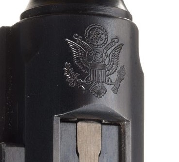

The Eagles are beautiful. Did the quality remain the same over the years? Were there any differences over time? Where did they obtain the dies? Were they made in Germany? Is each eagle unique to each model produced? How many different varieties are there? ~~Eric

Eric,
Die marking crests and national emblems on the chamber occurred often in DWM production years and even later in the Mauser era. It was always an option for a country purchasing for their Armed Forces. Or a freebie thrown in to win an order. Also, for commercial purposes having the national emblem on the gun gave it a certain cachet that attracted retail buyers.
But to your Questions:
1. The depth and quality of the die marking varied with the age/wear of the die, the skill of the die maker and ultimately with the skill of the production personnel but was always generally good. For example, as you examine various AEs , you can see variations in the depth of the impression.
2. The Eagle is not just any Eagle. It is the Eagle on the Great Seal of the United States of America that is used on currency, buildings, badges and other official and not so official articles. There is only one true definition of the Eagle. But die makers are human and even on our currency you can detect minute differences.
3. DWM certainly manufactured their own dies. Tool and Die makers are artisans essential to gun making.
4. For American Eagle models, the symbol is always the Eagle on the Great Seal of the United States of America. But various eagles were used over time in the crests and national symbols of other royal families and countries.
Hope this helps. And I agree, it is a truly wonderful symbol adorning the chamber of a truly wondrous gun.

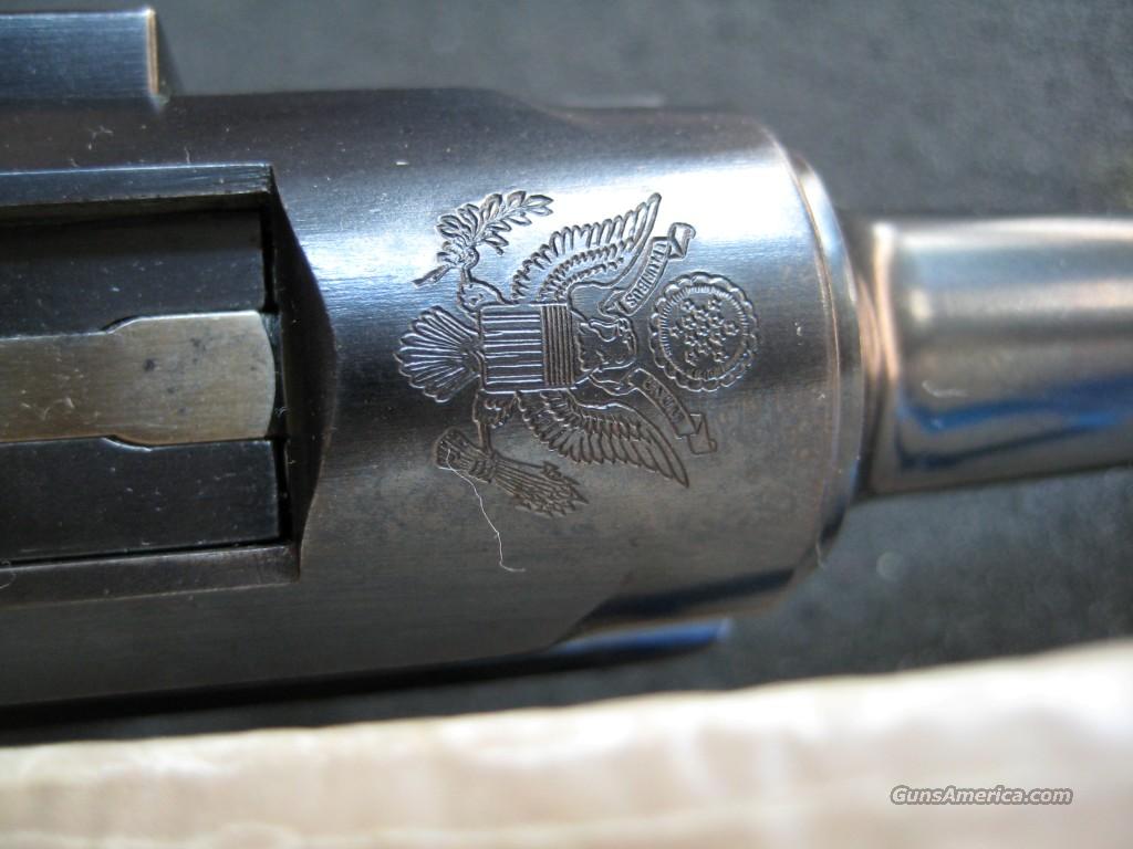

Eric,
I have observed at least two different versions of the seal on 1906 AE Lugers. One version has 20 bumps and the other has only 16 bumps round the outside. When I first saw this I thought the 16 ones were fake, but I believe they are a truly different version (perhaps some other 'expert' can chime in on this).
Your 1902 above has the original 20 bump version - you are right, that is a beautiful eagle. I find the earlier ones were sharper and nicer, maybe due to the dies being newer. The "E Pluribus Unum" inscription on the ribbon should always be clearly visible for guns in good condition, but I've seen some pretty poor ones on later guns.
I wanted to show you an example of the other but I can't seem to attach a picture.
- Geo

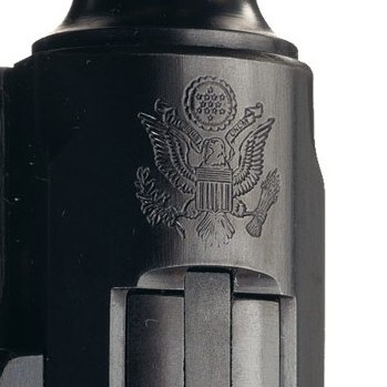

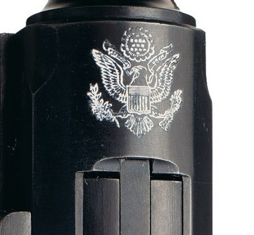

OK I figured it out.
1906 Eagle version #1 (small).jpg VERSION 1 (20)
1906 Eagle version #2 (small).jpg VERSION 2 (16)
1902 FatBarrel Eagle (small).jpg 1902 FAT BARREL VERSION (ORIGINAL)
- Geo

Thin tail and fat tail differences too. Plain breast and detailed breast is another detail. Mine is a later gun, 45xxx with 16 bump fat tail.

The Eagle that I had a chance holding in my hand had lots of detail. But I had touched only one DWM AE, were there many variations of this crest?
