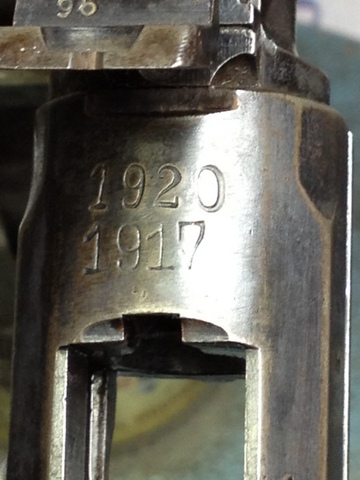

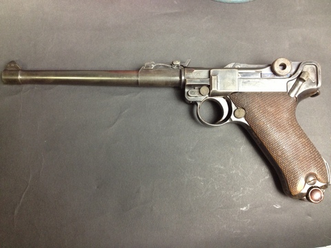

I just got a Luger Artillery Erfurt Double Date 1917-1920 chambered in 9mm.

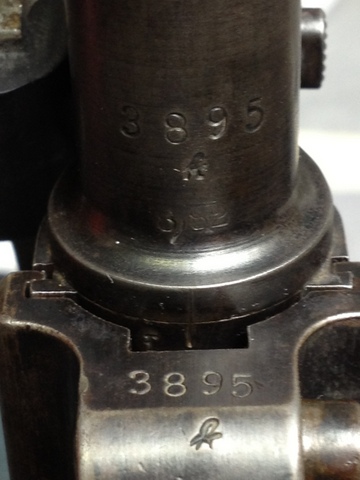

With a serial number 3895 with no letter, only 4 digits. on the frame, the barrel and the receiver.
It is in very good shape with original bluing, and all the parts numbered 95 but the toggle train numbers are 35 not 95 like the rest, the mag has a wooden bottom with the number 661.
I Need some information about it, A gunsmith told me that the miss-mach between the toggle train and the rest is ok because in 1920 the barrel was change from the original 30 cal to 9mm and the toggle is different specifications. Is that the truth?
What is the value of this pistol if I wanted to sell it?
is this a rare item? is double date erfurt a very scarce pistol?
Thanks in advance for the informative answers.

There is a letter (I don't know which one tho) on barrel and receiver, under the #

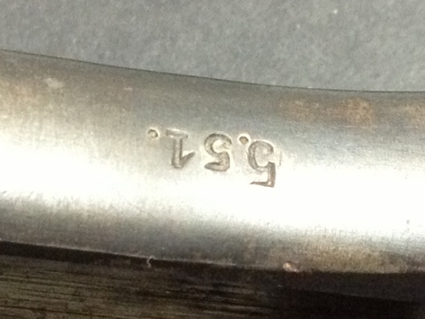

5.51 is unit number
lower date is when made, upper date is state property stamp added after the war to mark the gun and prevent theft

Your gunsmith does not know what he is talking about. Your WW1 Erfurt Luger WAS taken into service by the Weimar republic post war, (thus the 1920 property mark, NOT date), but this gun was manufactured as a 9mm and always was a 9mm. The toggle is mismatched so the gun's value is affected accordingly.
The unit mark guys will comment on the front strap marks.
Your letter suffix looks like an incompletely stamped "J"
I hope you paid a reasonable price for her. As she is, she's a very nice shooter.

Erfurt only made Artillery lugers in 1914, most likely you have a 1917 DWM Artillery Luger with a mismatched Erfurt Toggle assembly.

Kenny is right. This is a DWM that has an Erfurt toggle on it.

A) was made in 1917 and the number is 3895 A
B), the caliber was 9mm from the get go (Not a changed barrel)
C) it is a DWM not a Erfurt
D) the toggle was replaced at one time for a Erfurt.

Also, your serial number letter suffix is not an "A", but what looks like a "J"

Ya' done fine in it. Go have fun, take care of it, and recoup your money down the road. And you may wish to keep an eye out for a DWM Artillery goggle with that number. You may get lucky. Remember that one out of every 100 artillery toddles for sale will have your number.

I like your arty Luger. if it were mine, I would shoot it a lot and enjoy it, but keep an eye out at the proper places for a DWM full toggle train with the correct numbers to match your Luger.
