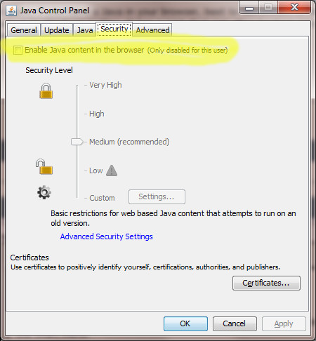

After installing this (on a Windows machine) you go to the system "Control Panel" from the Start Menu.
Set the control panel to view with "Small icons" if you don't see a "Java" icon with a little coffee cup. You should then see this app.
You can also just search for the "Java" app from the Windows Start Menu.
I attached the panel with the area you need to un-check highlighted in yellow:
You want to turn off "Enable Java content in the browser".
