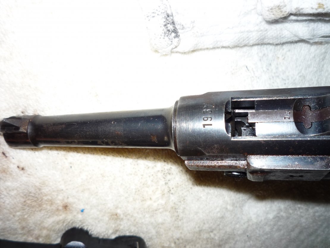

I got a Luger with a completely seized slide. Soaked everything overnight, no change. The pictures show the largest opening, or movement I get out of the slide. There is a mechanical lock up, somewhere.
Don't have a history on it of who did what to this gun.
What other options do I have, other then drilling the barrel shaft bolt out?

Okay, here is my best guess at long distance troubleshooting.
First of all, make sure the gun is NOT on SAFE as suggested by VLIM. The word "Gesichert" should be covered up by the safety lever. If the gun is on SAFE, then the safety bar will block the sear as the toggle is pulled back and won't allow the sear to slip over the firing pin, thus preventing the toggle/slide from moving more than your photo is showing.
IF the gun is not on safe, then I agree with VLIM:
I see a lot of established surface rust. What I suspect may have happened is that the gun was stored with an empty magazine for an extended amount of time without lubrication.
Since the magazine button is what pushes up the holdopen device, I suspect that the holdopen device may have rusted in the UP position preventing the toggle from fully opening.
Please try to post a photo looking straight down into the opening between the bolt and chamber with the toggle as open as you can get it. The holdopen may have broken or was improperly installed in the first place. Seeing this photo may clear up some of the confusion.
Remove the grips and submerge the gun in penetrating oil as a last resort.
DO NOT DRILL ANYTHING... cause you will destroy whatever value the gun still has if you do so.
Waiting to see further photos...

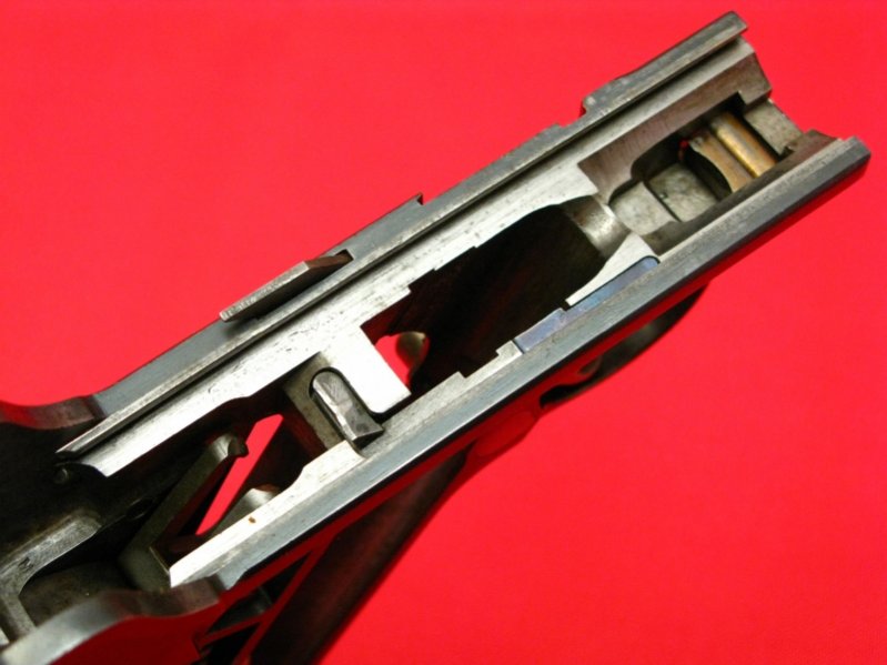

Is slide rust shot or it will move slightly or not at all? Could it be that she is deactivated??
On the second pic I can see a strange piece of metal that doesn't belong there. Here is a pic how things should look like under neath the slide. Actually no, it looks Ok, I was expecting to see feeding ramp there not the slide stop cavity.

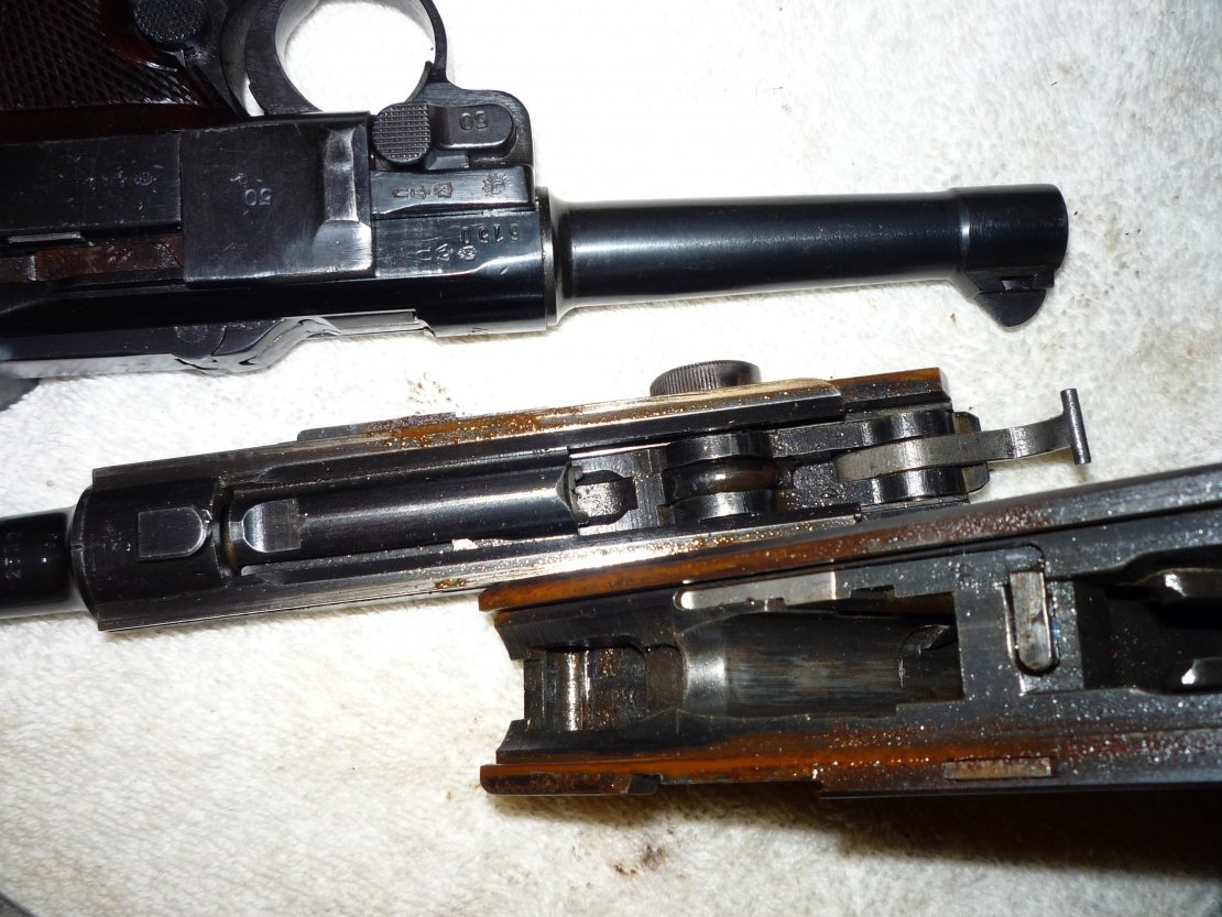

Thanks for all your suggestions.
I finally got her apart. I was able to disconnect the main spring toggle and soaked it some more in WD 40 and Kroll. The toggle removal gave me another 2 or 3mm of slide. Enough to get a larger screw driver in there. A couple of careful pulls allowed me to open the slide lock.
To make a long story short, the frame was rusted to the slide. Never seen this on a gun before.
Well, TLC time
Alex
