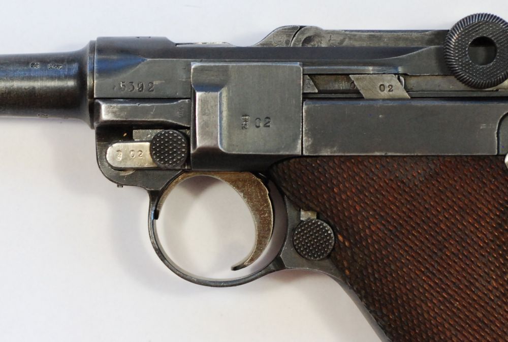

Hi Bill, I don't recall ever seeing a 1916 Erfurt with an unrelieved sear bar. Here's #5302n/s with a relieved bar. Regards, Norm

Hi David, The first photo shows an un-reiieved sear bar, on a 1912 Erfurt, the second, a relieved sear bar on a 1916 Erfurt. This modification, which was mandated in 1916, makes it possible to chamber a round with the gun on safe. Regards, Norm

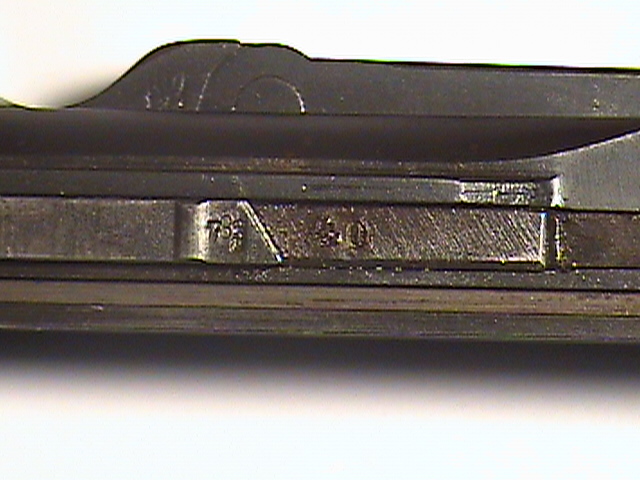

For whats it worth, here's a photo of my 1914 Erfurt with a replaced sear. I say replaced (and original not milled down) because you can see the original sear number (73) and the re-stamp (40) to match the pistol.
Unless the (73) is not a serial number?
Bob
