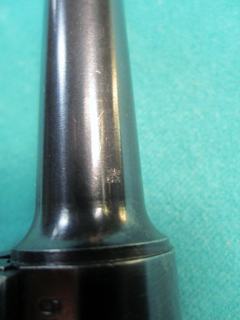

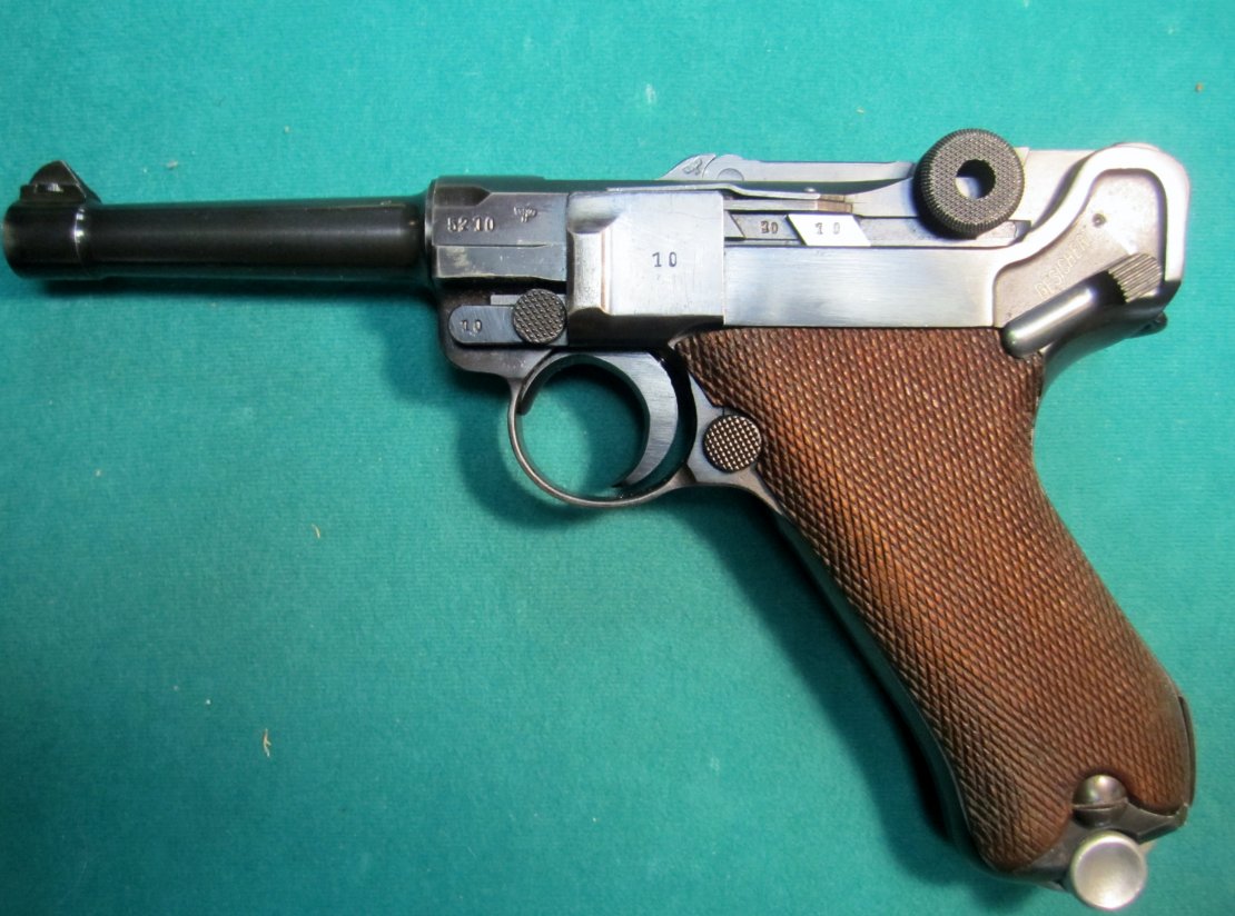

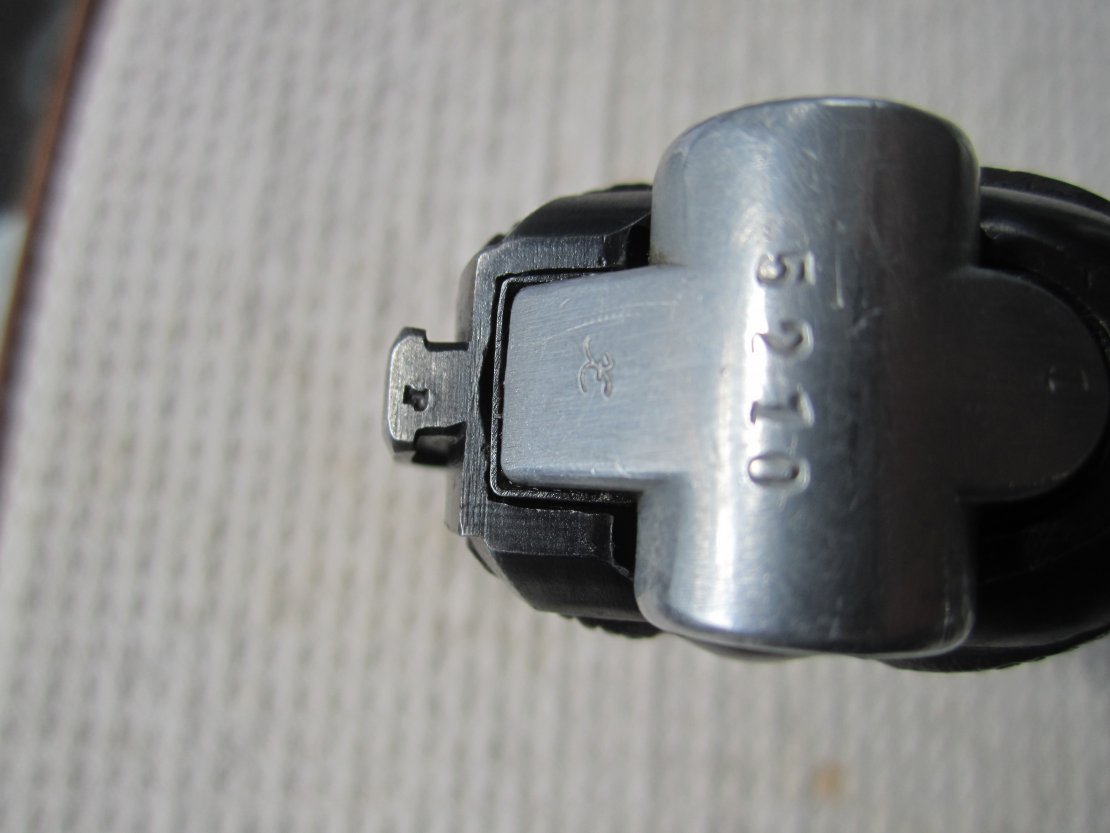

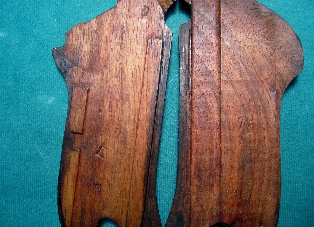

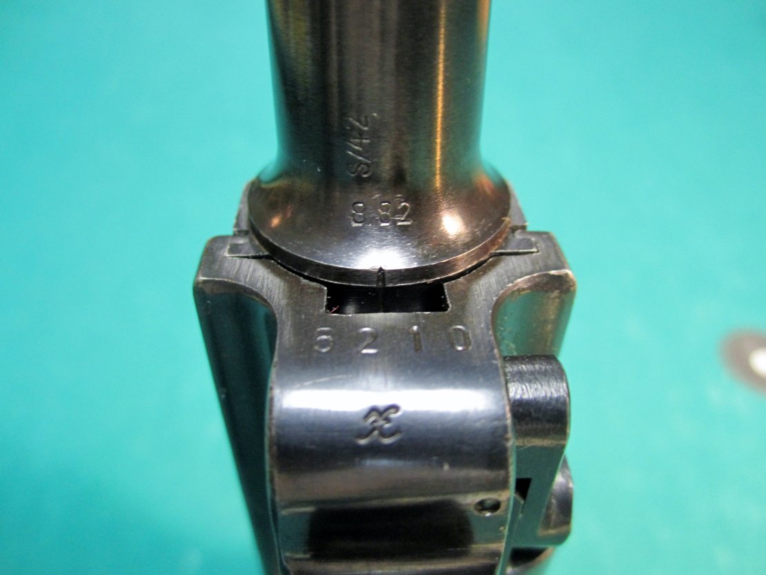

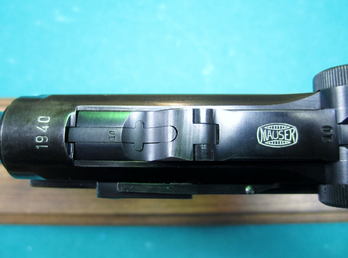

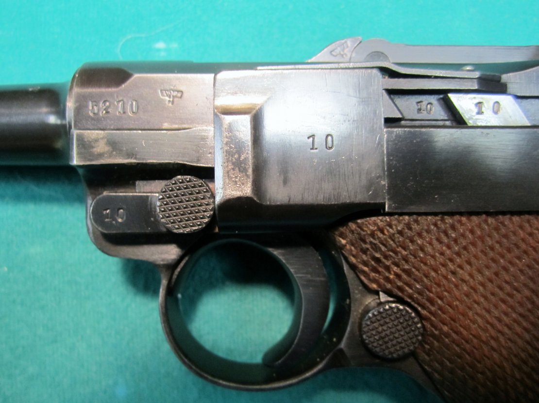

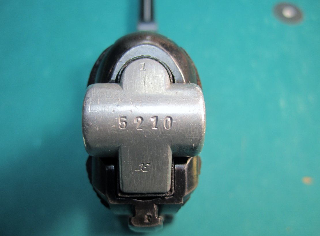

I have a new to me Banner police. I am confused by the S/42 mark on the barrell. Any one thoughts on this?

I'm not the expert around here and I believe it is a replacement barrel. Not as bad as it sounds. The s/42 is the code for a Mauser componant and possibly a field replacement due to damage, who knows?
I think it's an interesting addition to the weapon.
Nice find.

As Mark mentions, "S/42" is the military concealment code used for parts manufactured by Mauser.
It would seam that at some point this beautiful E/N proofed commercial police pistol found it's way to a military armorer for a barrel replacement. (See below for details from Tom and Jan... Factory original most likely...)
Unique and interesting!
Is there a mark of some type (perhaps a small "x") on the base of the frame shown below the magazine in your 5th photo?

Default x on frame, E/63 on barrel, E/N front sight
Thanks for the quick replys. Yes there is an "x" there. See pic.
I checked another S/42 I have with the correct serial number on the barrel. It does NOT have that "x" mark. No sear safety on that one; it is a military gun.
Don't know what to make of that "x" mark.

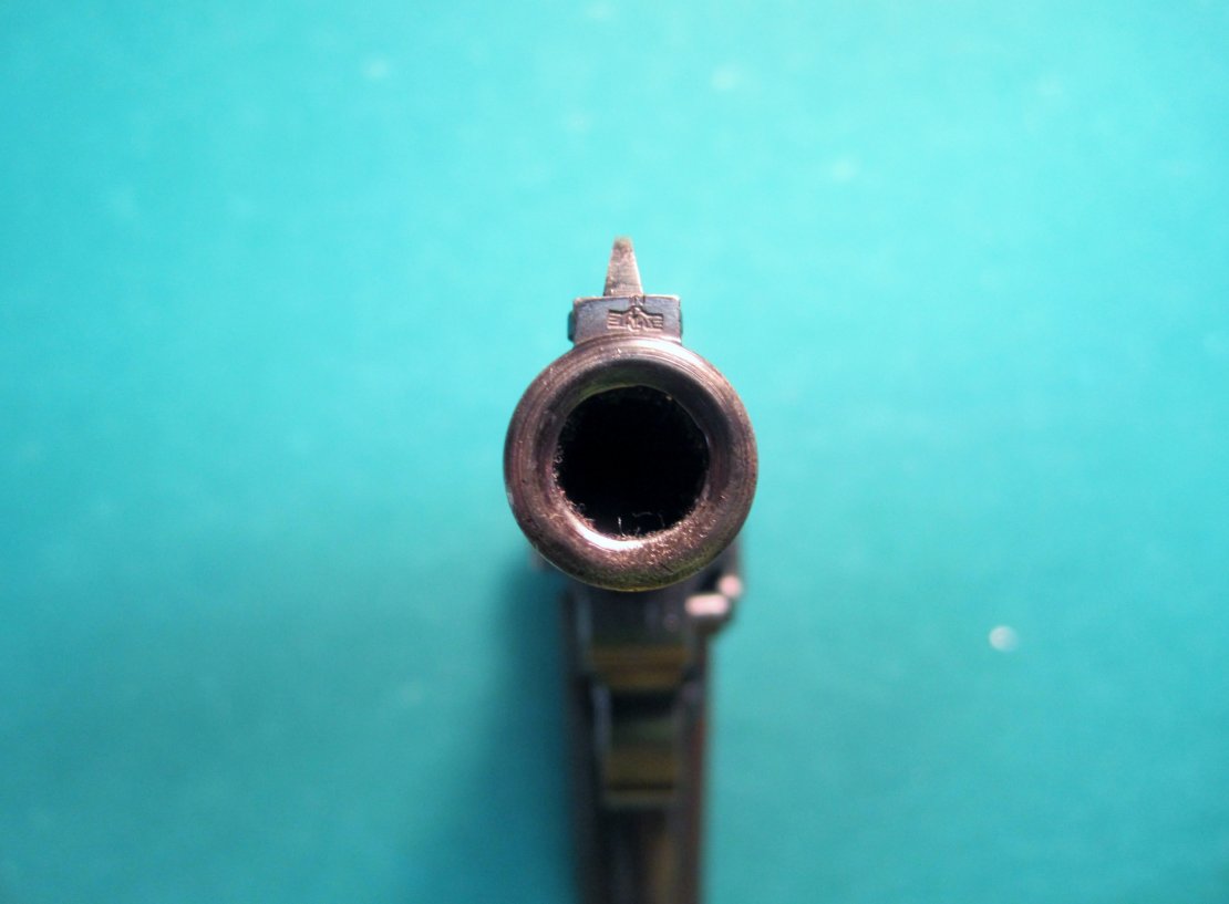

Also attached pics of other markings on the police pistol barrel - Eagle 63 at 11:00 o'clock, Eagle over N on base of the front sight.

The Police were not always first in line for luger parts. Looking at the data on Jan Stills Forum it appears the Police were scrounging for barrels around the time your gun, 5210x, was produced.
My 1940 Police banner, 4748x, has a Su (Simson) stamp on the barrel.
Yours received a Mauser S/42 replacement when produced.
In addition the following barrel markings have been recorded in that time range.
4122x S/42
4347x S/42
4569x Su
4995x Su
5679x S/42
5755x S/42
6128x S/42
I believe your gun is original and correct.
Tom

Agree with Tom (tharpo) above.
Jan
Unread 10-11-2012, 05:03 PM   #7
I, of course, defer to Tom and Jan. They have the tracking data that confirms this kind of sourcing of parts at the factory.

Tom :
Thanks for the detailed research. I will enter my gun's info into that data base. I think it is very interesting that even Simpson barrels were used.
Thanks also to everyone else who responded. This thread cleared up a mystery for me!

RJS, Since Mauser "inherited" left over parts from previous manufactures, it's not unusual to find these parts (and new Armour's spares) used to make their non-military lugers. You'll sometime find Imperial accepted (Erfurt) & Simson parts on these pistols. The "x" serial suffix on your mag, without WaA, is the correct matching mag for your police banner luger. TH
