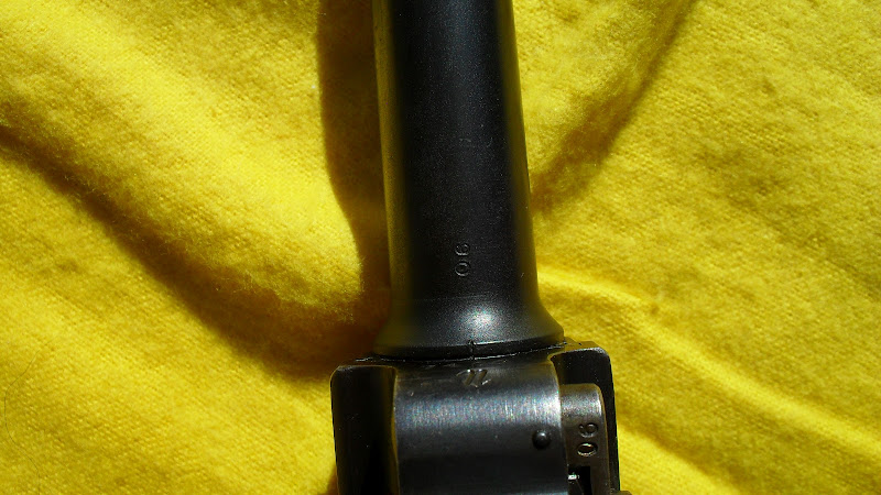

All parts are marked with matching serial numbers. The front of the chamber has the full 4 digit serial number of 7490. Underneath the serial number is what appears to be a cursive capital letter "N". The rest of the parts are marked with just 20 digits "90", including the bottom of the barrel.

Bottom of barrel

If it is a company made longer barrel, such as Pacific Arms etc, then $1000 was reasonable. a 6 inch barrel in 9mm and installation is around $200-$300 / and thats a nice length. See the #90 on the barrel, it matches the serial number, that said, it is not in the normal spot, I just find it interesting that its marked that way, a completely aftermarket likely would not be marked.

Regarding the 90 on the barrel, Aaron made a big deal about whether or not something was stamped then blued, or vice-versa. This looks to me like it was stamped, then blued. The finish on the gun seems to match. But I guess the killers are the sights not matching up to something production.
