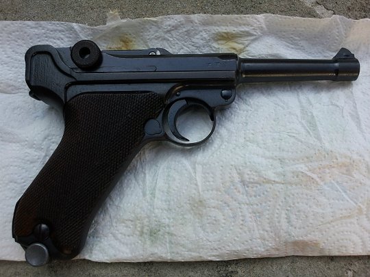

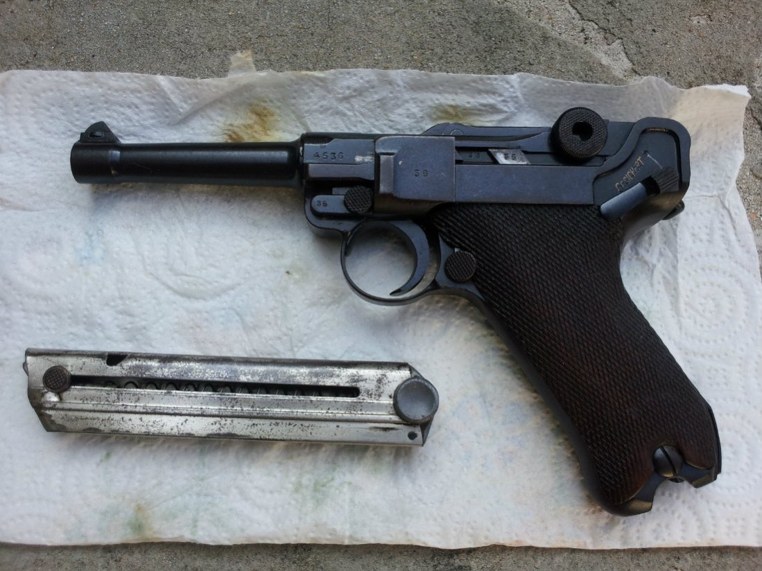

Hello,
I've been lurking for a short while trying to learn as much as I can about a 1938 S/42 Luger with matching numbers I just acquired. I'm interested in opinions on its value, but I'm more interested in ideas on what I should do to treat the rust patina that covers a good bit of the barrel and grip. I have it in pieces now and internally it looks nearly brand new, and obviously has not been shot very much. All of the internals have very sharp edges and every part I've checked is matching. While the outside of the trigger plate is a matching number, the inside of the trigger plate has a 45 on it. What does this mean?
The person I bought it from told me that it has been in a drawer since he bought it twenty years ago. He purchased it from a pawn shop, but was told by them that it came from a veteran. It has no import marks. Any help is appreciated.

Well, just shooting from the hip...
It's a 1938 Mauser [S/42 + Mauser hump] which looks to be in quite good condition...
By 'patina' I assume you mean the blue has oxidized to a brownish color, from exposure to moisture/oils in hands or holster...I like patina...IMHO it shows honest use and age...Cleaning & oiling is good...
Not sure about value; probably in excess of $800+...How much more is best left to the collectors of this niche variation...
Unread 10-07-2012, 09:18 AM   #3
The "45" in the inside of the sideplate should be one digit off from the beginning of the gun's serial number. Does the serial number degin with "44"? It's hard to tell from your photos.
Also, the gun appears to be heavily oiled, so the finish is hard to determine, but from the rounded surfaces, it appears to have been reblued at some point. Really fine steel wool, ("0000" or finer) and a little oil will help remove surface rust, but as rich states, you are probably seeing undersurface red, which is mornal in salt blueing.

Yes, the grip and much of the barrel show a reddish patina under a bright light.
Unfortunately, I forgot that I had rubbed it with grease the night before I took the pictures so It looks very shiny in the photographs. I'll try to wipe it down and see if I can take more pictures. The serial starts with 45 which is the same as stamped inside the plate. Don't know why I didn't connect the dots, but what you're saying is that they should be one count off of each other correct?
Thanks.

John, welcome to the forum. Congratulations on what looks like it may be a mint Mauser Luger. Generally, with collectable firearms, it's OK to disclose your serial number since the tracking done by forum members is one of the ways we prove provenance of collectable pistols like yours.
Your approach to the pictures was correct. Indirect (shaded) natural lighting outdoors without using a flash. But try to get sharper better lit exposures, and include closeups of the markings. Your full serial number is on the front of the frame above the trigger guard, and includes the suffix letter.
It's a bit difficult to judge the finish and condition of your pistol because of lighting and the camera's pickup characteristice (was this a cellphone camera?).
While generally the inside of the trigger plate is the first two digits of the serial number plus one, during this year the number matched the first two digits of the serial number.
You can dry the oil off the pistol with a soft absorbent cloth and let us get a better look at it. If it's original finish and a very high condition (97% +) is is likely worth closer to $1800+. My guess is that the rounded surfaces Doug mentioned are due to camera focus problems or camera shake. Use a tripod, and the closeup setting of a good digital camera. The self timer eliminates camera shake.
Don't be too worried about removing oxidation unless it's active red rust. As Doug mentioned, careful use of oiled "0000" steel or bronze wool can remove that. Go gently and slowly. It is normal to see a small amount of red oxidation deep in the finish of an older pistol, and it is, in fact, one thing you look for in judging the age of the finish.
Your Luger was originally hot salt blued at the factory. Resist any temptation to "improve" imperfections. The un-altered original finish (as worn through use) is the most highly valued, and historically correct.

Hello John, welcome. The trigger plate number on the inside should be the same number as the first two digits of the serial number. This is true for most 1937 and 1938 Lugers. The later Lugers, beginning in 1939 were mostly numbered with the inside plate number one larger than the first two digits of the serial number.

These pictures were taken with a cell phone. I did take some with a digital camera, but they were actually worse than these. I'm going to see if I can get someone who knows what they're doing with a camera to take some.
The serial is 4536c and I've been trying to make out the first waffenamt on the right side of the receiver; the second waffenamt is a 63.
I've been surprised by the number of parts that are numbered.
Thanks for the info. I'm going to work on getting better pictures.

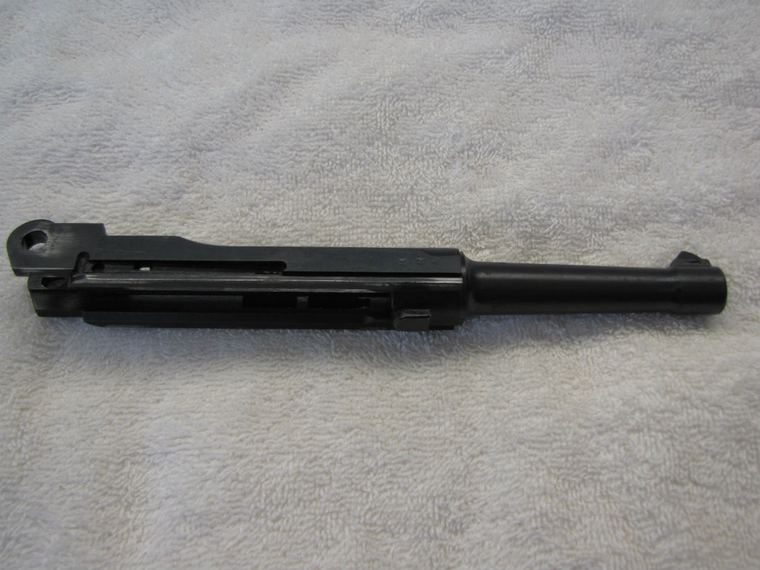

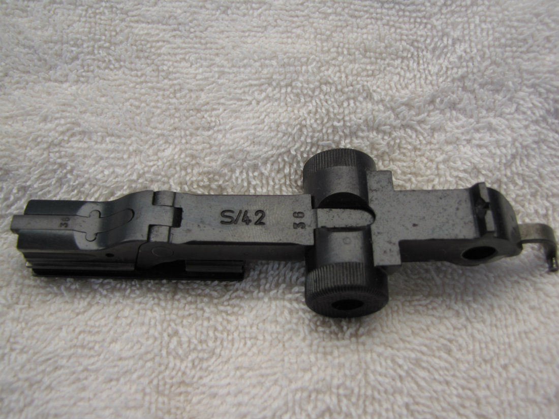

One more try on my own with the camera.

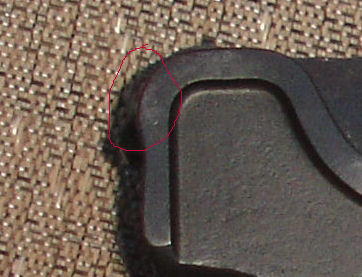

I guess my questions are,
Should I put it back together and leave it alone?
Should I shoot it or not?
Does it look like it's been refinished?
What's it's value?
What is referred to as the Mauser "hump"?
Thanks for the prior replies. I've learned a great deal from all of the posters.

Mauser hump...

John, These pictures show more detail, but I'm still having trouble judging the finish. The edges of the metal look sharp (a good sign).
When you re-shoot these, use outdoors natural sunlight in a shaded area. Use a background that is more grey in color (meters are calibrated for 18% reflection) or compensate for the light reflected by the background.

John, These pictures show more detail, but I'm still having trouble judging the finish. The edges of the metal look sharp (a good sign). Marc
I agree, it almost looks like it's been dipped in that black Russian stuff.
I think it would help to wipe it down well with a clean rag and take some photos in natural light.

Roland, yes - the matte and speckled appearance of the finish had me thinking the same thing, but I still think it could be the lighting and camera sensor.
John, if you're near another LugerForum member that has experience judging finish, you might try and get a first hand evaluation in person. It makes about a 40-50% difference in the value of the pistol.
As to the provenance (veteran to pawn shop to 20 year owner to you), we have a saying, "Believe the gun not the story"... This is where capture papers and the databases we maintain help.
