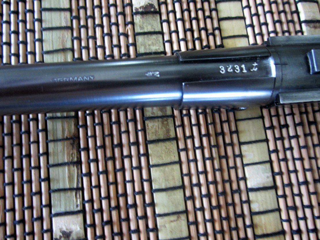

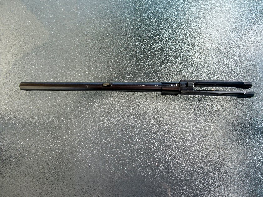

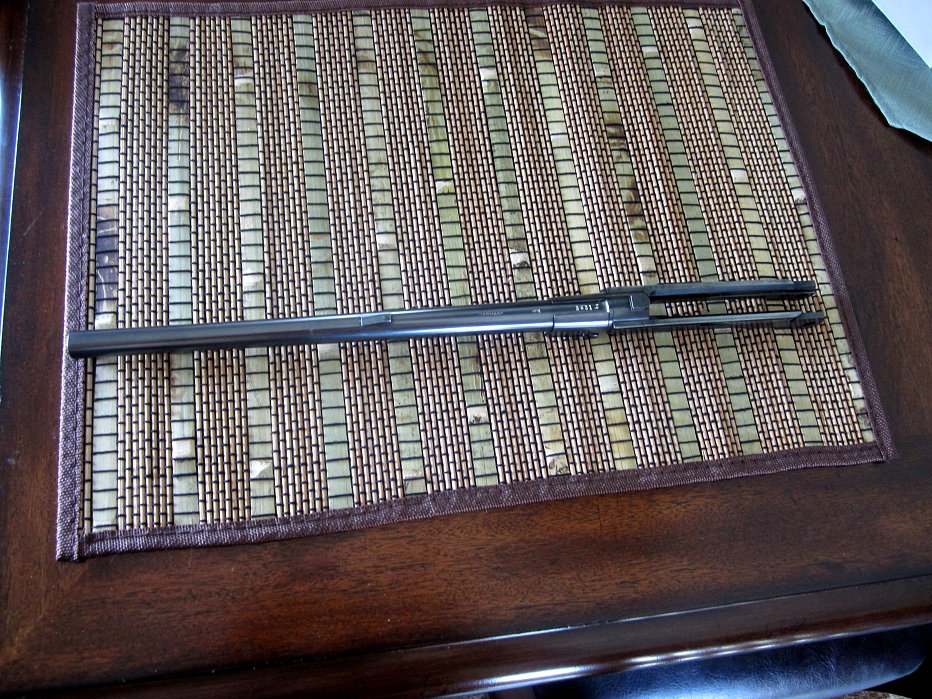

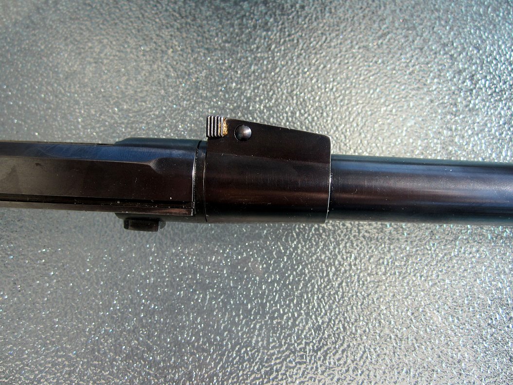

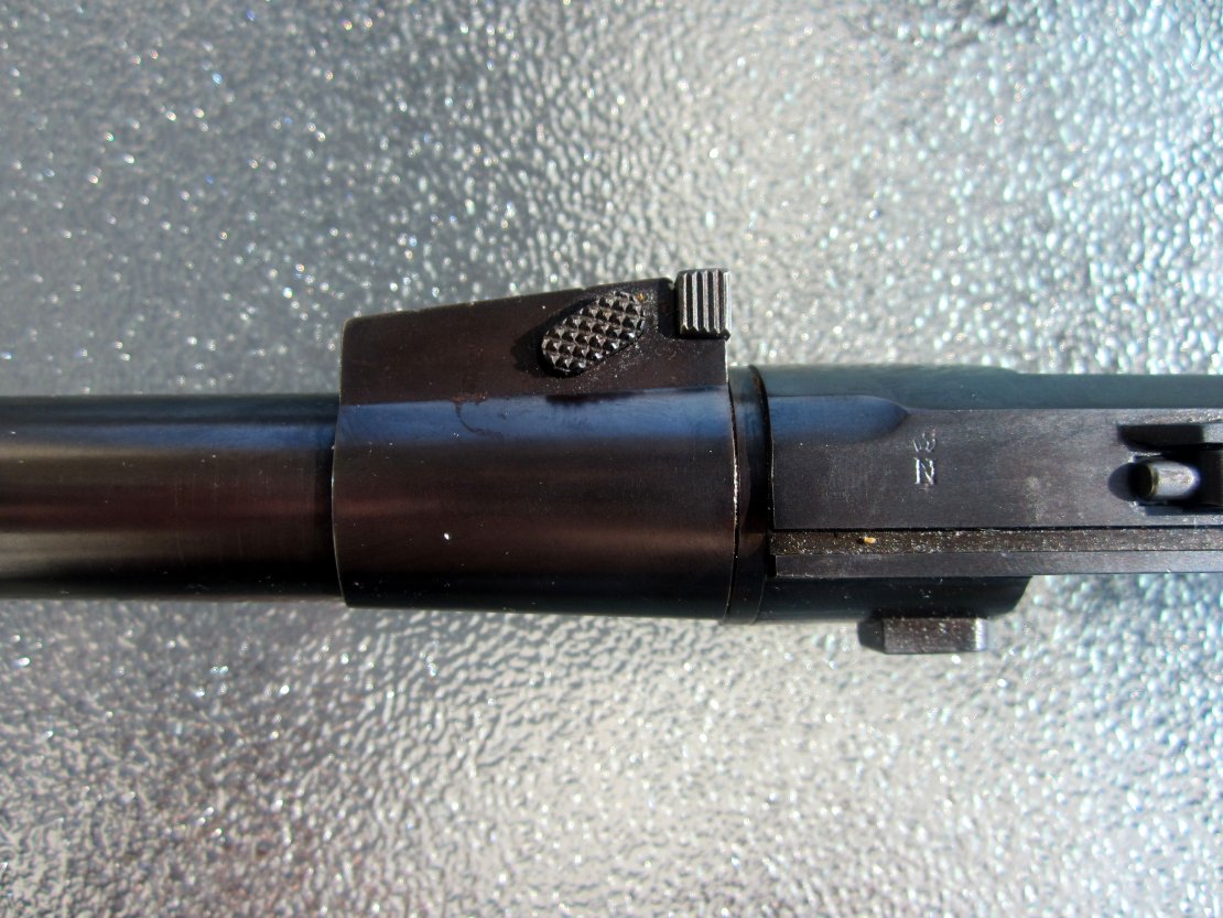

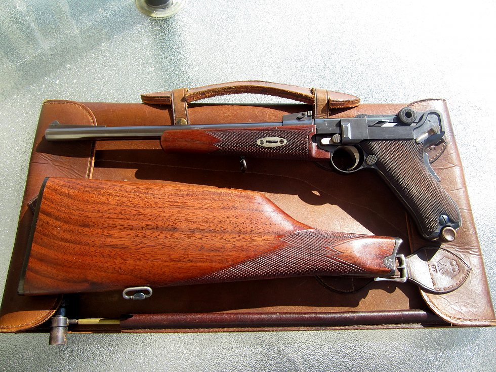

I got a look of a 1920 9mm Luger Carbine barrel. It appears the base of the barrel is reinforced! I welcome any comments! Eric

Eric,
It is not exactly a "reinforcement", it is just part of the mount for the rear sight. There is nothing about the gun or ammunition that requires reinforcement.

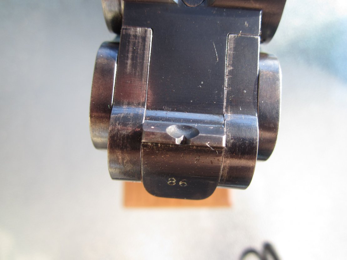

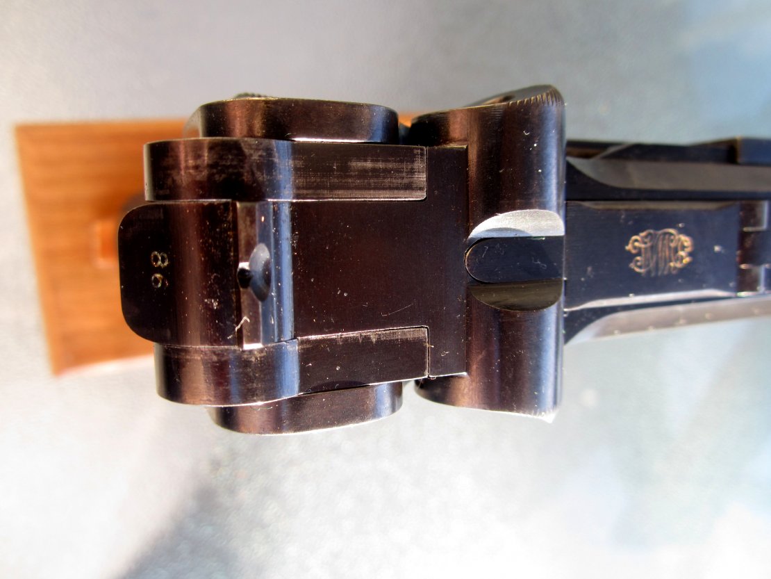

Default I Was Told The Rear Sight WAas Inproper
and had to go!!! i SENT A MESSAGE TO TED TO CEASE UNTIL THIS IS WORKED OUT! What do you think!!

Unread 09-03-2012, 08:38 PM   #5
Its not that sight. Its the little notch on the end posted above that pete and a few said it was improper!

Eric, it should be replaced with a sightless artillery type rear toggle. George

seems to be massive confusion in communication here...Eric's carbine should not have a rear toggle with a v-notch sight like regular Lugers....it'll be "more correct" with a smooth rear toggle like an Artillery, of course not original, but then it wasn't before!

EJB, It's hard to tell from your one photo of your carbine's frame, if it is in fact the long M1902 type, which should have the "sightless" dished rear toggle, or the later short frame M1920 type (probably this one, judging from the 4 digit serial under the barrel) which as mentioned above normally have the same rear toggle as an LPO8. If your frame has the M1902 features, I do have a spare M1902 Carbine rear toggle link. TH

Serial # font "typewriter" used on that barrel is not same as font used on that toggle 90 years ago. (refferring to toggle #31 not #86)
