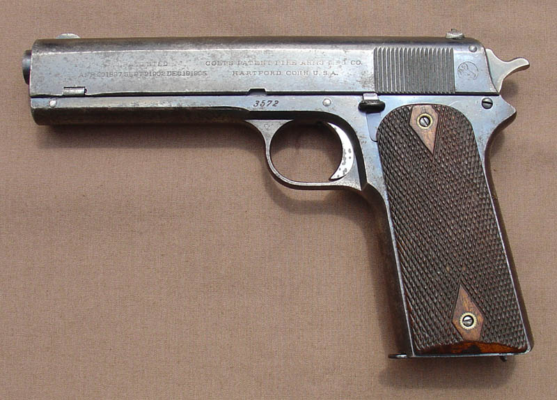

I recently purchased this from a member of my gun club. I have replaced a few damaged internal parts and purchased a spare extractor and firing pin from Numrich. I tried it out last weekend with some very light loads (200 gr. plated RN / 3.5 gr. Red Dot) and it performed perfectly. I would like to replace the recoil spring but I have not found a source. It occurred to me that a 1911 spring might work. The recoil spring is 6" long, outside diameter .420, inside diameter .344. Can anyone provide the dimensions of a 1911 spring?

The people at Wolff have a full page for 1911 springs:
http://www.gunsprings.com/Semi-Auto%...cID1/mID1/dID1
They don't publish dimensions, but do offer a range of compression strengths and two alloy options.
This summary discloses the wire sizes for different compression strengths...
From this post:
Let us revisit the 1911 recoil spring issue.
As a reference The Colt .45 Automatic A Shop Manual Volume 1 by Jerry Kuhnhausen Page Number 90:
“Recoil spring weight in the standard factory Government Model will vary some what, but averages approximately 16 pounds. This spring weight began with the original M1911 production, and is correct for 230 grain ball ammunition at velocities of about 800 FPS.”
As a reference The U.S. M1911/M1911A1 Pistols & Commercial M1911 Pistols Volume 2 by Jerry Kuhnhausen Page Number 146:
“Spring Drawing/ Specifications Total number of coils = 30 – Free length 6.55 (inch) Ref - Solid length 1.375 (inch) Max. Load at 73% compressed length of 1.81 (inch) = 13.55 Lbs. – OD .430 (inch) ± .005 (inch)”
“Figure 135 –Spring data: ordnance std. recoil springs have 30 coils. Fully Compressed spring tension is 17.36 lbs. Although tension is progressive, this equals an average spring rate of approx. 2.65 Lbs/Inch.”
Should Jerry Kuhnhausen be correct it would appear the 16 Lb. is the standard spring as opposed to the 14 Lb. spring for the M1911/M1911A1 Government Model.

Jerry,
You ask a good question. The spring is kind of bent up, seems weak, and is presumably over 100 years old. The beauty of a new 1911 spring is that there are many variations. My goal is to find a spring that barely cycles the action with approximately the original ballistics – 200 gr. Bullet at 900 FPS.

Many thanks for the information – that is exactly what I need. It looks like the 1911 spring is close enough to give it a try.

That old Colt is a beauty! Shooting it had to be a true joy. I am sure that you know this already, but Wolff springs offers "calibration packs" of springs in different weights for a very reasonable amount of money. I would bet that you could find one that will work well with your soft loads and others.
I used this pack of springs when I was trying to get reliability out of my 1914 Colt 1911 with some soft loads(200gr plated RN with 3.5-3.7gr of bullseye). It really worked out well for me, and I don't have to worry about over stressing that old warhorse.

Success! The 1911 spring is an exact match - obviously one thing that was not changed when the 1911 was developed. I purchased a Wolff spring from the local gunsmith.
