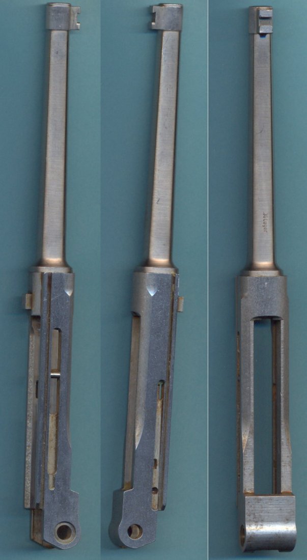

In post war production, Mauser used a specialized threading machine or 'Gewindeschneidmaschine' as they called it on paper.
It was one of the later steps, after shaping the barrel and sight base. After threading, the ejector slot was cut, followed by milling the feeding ramp and cutting out the dovetail area of the front sight base.

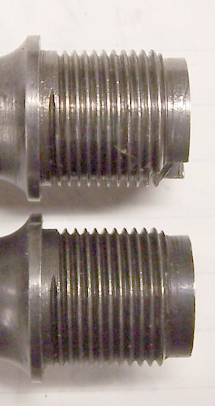

In post war production, Mauser used a specialized threading machine or 'Gewindeschneidmaschine' as they called it on paper...
I would guess it used a rotary cutter to mill the threads...I'm looking at two Luger barrels and the cutter marks (and end of cut) are distinctive...

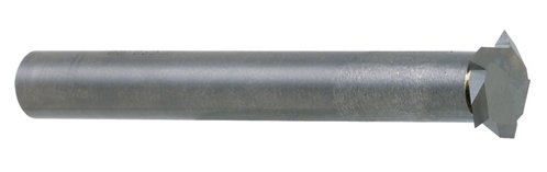

Also a 60º (or whatever angle the Germans used - 55º?) thread cutter, this one is for a vertical mill...I would further guess that the Gewindeschneidmaschine used a horizontal cutter, probably on an arbor, with a much larger diameter & number of teeth...

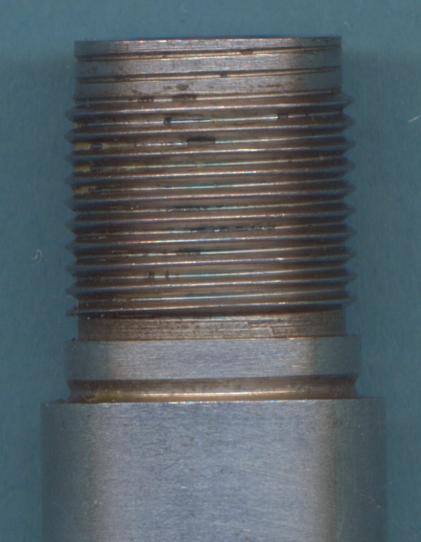

Here is a closeup of the threads on an unfinished post war bull barrel.
That pic does look like a lathe turned thread, cut with a single point cutting tool (although it doesn't show the end of the cut)...but the machinery could have changed from what was done before that...
Just my guess...

Gerben - That pic you posted - "Mauser_blanks_1.jpg"...What is that??? Square front sight base...Receiver not machined at the rear...No rear sight...???...
Unread 06-18-2012, 02:24 PM   #9
Rich, it is an in-the-white barrel screwed into an unfinished receiver, both from the 1970s production. The metal part at the rear was retained until the last production steps were completed. It prevented the receiver forks from warping during production, and was finally cut away as one of the last machining steps.

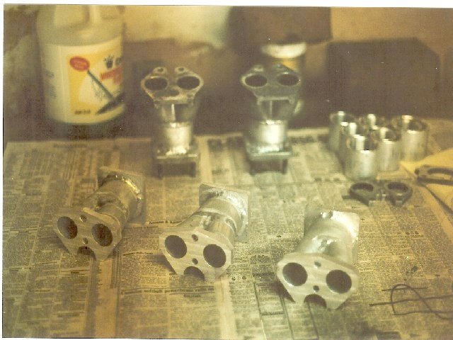

I also put triple SU's on the 240Z motor. I made my own triple carb manifolds. Pic attached is a set just off the TIG machine. The two in the background are a dual setup for a Datsun 521 pickup, same SU's. (The 521/510 4-cyl motor was 2/3 of a 240Z)...
Cut, mill, weld, drill. I used to love this stuff.

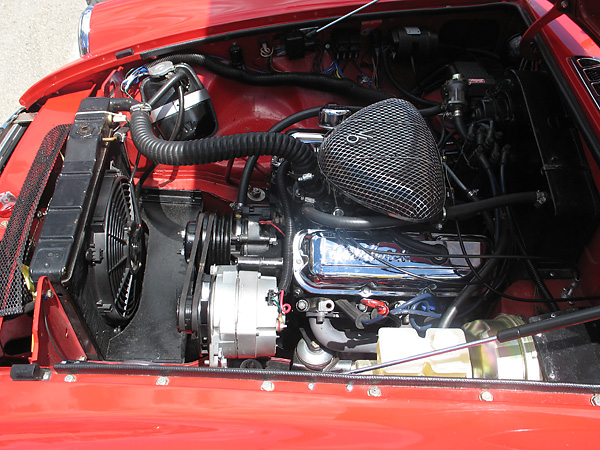

nah Rich....just a joke..Classic Conversions makes a neat kit using a 92-95 Camaro/Firebird 3.4 v6.....thinking about it....can get 220HP in a MGB....entertaining, i'd think! A lot cheaper and easier than the Rover/Buick 215, and as much or more torque/hp
