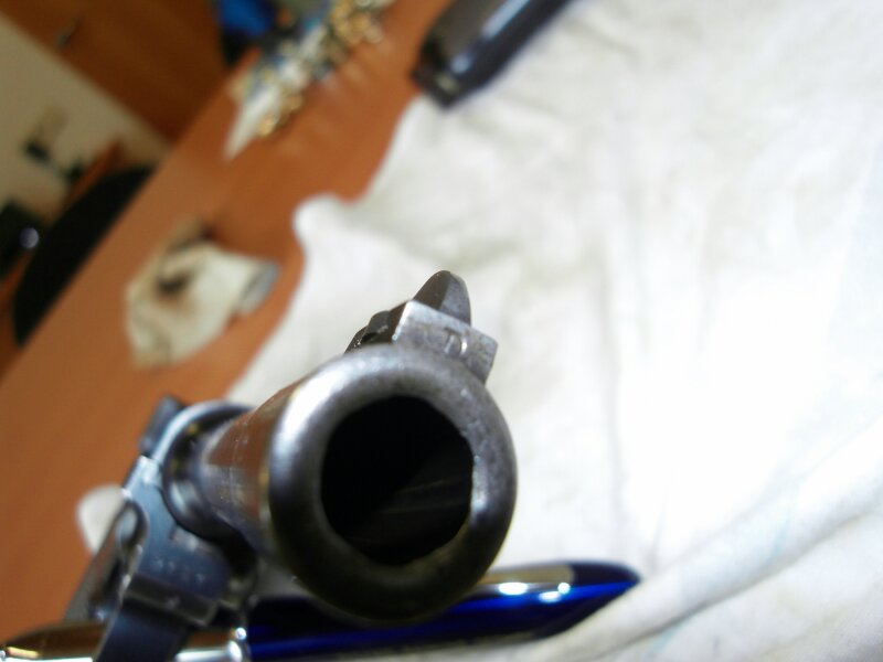

Gentlemen:
I have a 1917 DWM that has a mark on the forward edge of the front sight base. It's a capital "N" (see attached). I have no such marks on any of my other pistols. Please tell me what it means. The s/n is 6288 with no suffix.
Thanks.
Neil

Hello,
I found an Erfurt 1917 with an I-mark.
I think that this marks the used sight.
best
Otto

Anybody else have some thoughts on this?
Neil

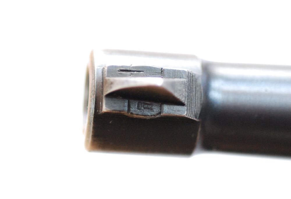

H Rich, Luger sight blades are a study unto themselves, but Neil is asking about a mark on the front sight block, which is not interchangeable. To your question, military Luger blades were not numbered (with the possible exception of Finish Lugers, which are outside my area), they came in two heights, 5.0mm and 5.5mm. Only Erfurt and Krieghoff blades bore inspection marks, Erfurt on top and Krieghoff beneath, only visible when the blade is removed. Regards, Norm

Hi ,
Some pics from my lugers:
The first is a 1917 Erfurt, the 2nd is a 1929 DWM Police and
the 3rd is a DWM with no Date in 7,65 Para.
It looks like I,D and O.
best
Otto

Just to clarify, I was referring to German Military Lugers, P04s, P08s and LP08s. There were only two sight heights used, 5.0mm and 5.5mm, both measured from the top of the base to the top of the sight. All P04s (Navies), and LP08s (Artilleries), used the 5.0mm blade. Early P08s, prior to 1914, also used the 5.00mm blade, but most were recalled and retrofitted with the 5.5mm blade at the same time as the hold-open was installed. After 1914, all P08s came with the 5.5mm blade, whether they were made by DWM, Erfurt, Simson, Mauser or Krieghoff. Once again, I'm talking about German Military Lugers only, not commercials or foreign contracts. If the blades were considered interchangeable, which they weren't, they would be marked on the blade itself, like some P38 sights, not on the front sight block. Regards, Norm

Hi Rich, I haven't see John's drawings, and I have no idea what the mark on Neil's front sight base signifies. The mark on FNorm's base that you posted earlier, is a Police inspection mark, the mark I showed, on the blade itself, is an Erfurt inspection mark (on an early DWM gun), that signifies that it is a retrofitted 5.5mm blade. There were other changes that occurred over time in the number of serrations on the blades themselves, but that's another story! Regards, Norm
