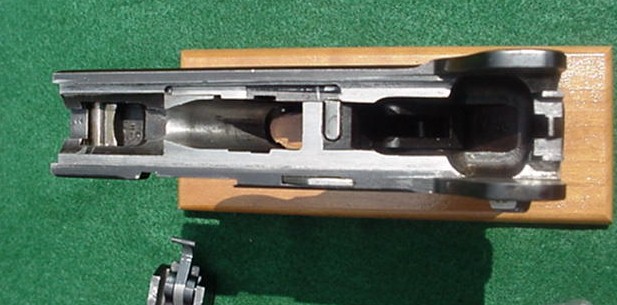

Hello to all,
I would like to share with the forum members one of my new acquisitions. According to Joop & Don in their new book on page 482 & 483, there were only 200 of this variation produced. As pointed out in other threads, the barrel is salt blued and the frame is rust blued. Your comments are welcomed.
Mike

Unread 05-07-2012, 11:59 PM   #5
Ben M.
Ben M.'s Avatar
Posts: 499
Thanks: 96
Thanked 146 Times in 91 Posts
in the recess at the thumb safety lever, there seems to be lots of peening.
did Mauser use frames that were previously marked with gesichert and peened that marking away and them apply the bare-metal marking the swiss liked to use ?
Unread 05-08-2012, 05:59 AM   #6
That's not peening. Those are machining marks from the router bit that has always been used to machine away metal in this area. A "Gesichert" has never been aplied to this area. It would be obvious to the owner if one had ever been present.

Unread 05-08-2012, 07:04 AM   #8
Posts: 8,197
Thanks: 1,416
Those are machining marks from the router bit that has always been used to machine away metal in this area...
... ...A router bit??? I would think the meticulous Germans would have used a corner radius end mill to cut this recess...
Unread 05-08-2012, 07:16 AM   #9
Non machinist talk for the proper metal cutting tool used...

Unread 05-08-2012, 03:02 PM   #11
One fine Swiss Mike! Thanks for sharing.
Unread 05-08-2012, 05:22 PM   #12
Posts: 8,197
Thanks: 1,416
My bad, Doug...I thought you had mechanical background - must have been another member...
But it is Swiss...maybe those cost conscious chocolate makers did use router bits...
