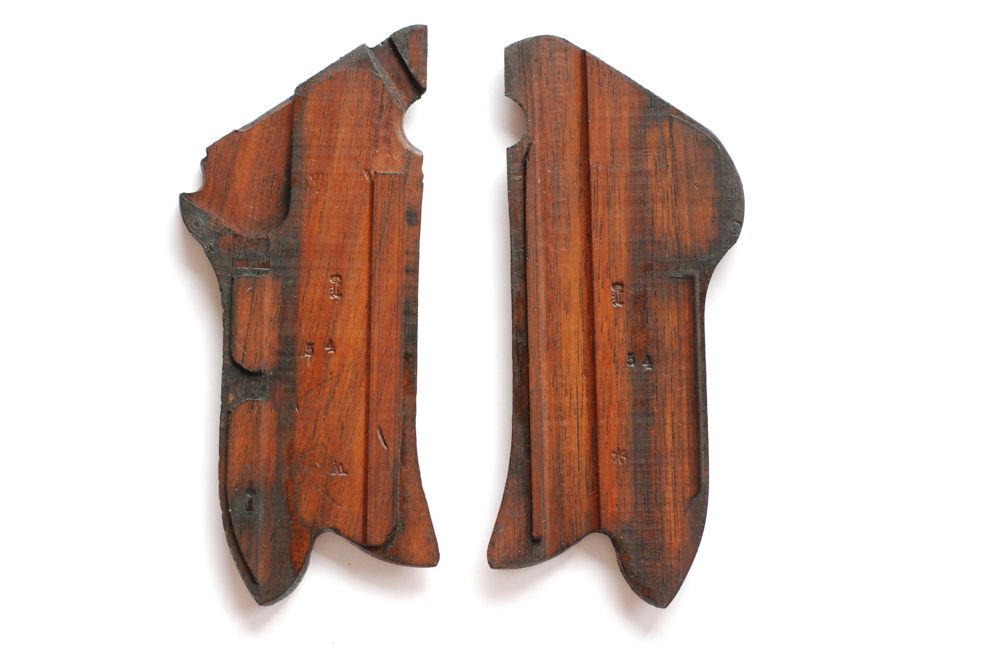

Hi Richard, Just to be clear, I assume you are looking for an Imperial era military Luger. During this period there were two manufacturers, DWM a privately owned company, and Erfurt, a state owned arsenal. Numbering and inspection marking on DWMs was less rigid than on Erfurts, and unnumbered DWM grips are not uncommon. Erfurt however, numbered and inspected everything, including grip screws prior to !916. The photo shows a typical set of Erfurt grips. With regard to matching magazines, they are quite uncommon on military guns and most collectors are happy with a non-matching magazine that is period correct. A lot of "matching" magazines are faked, another reason to buy from a reputable source. Good luck, Norm

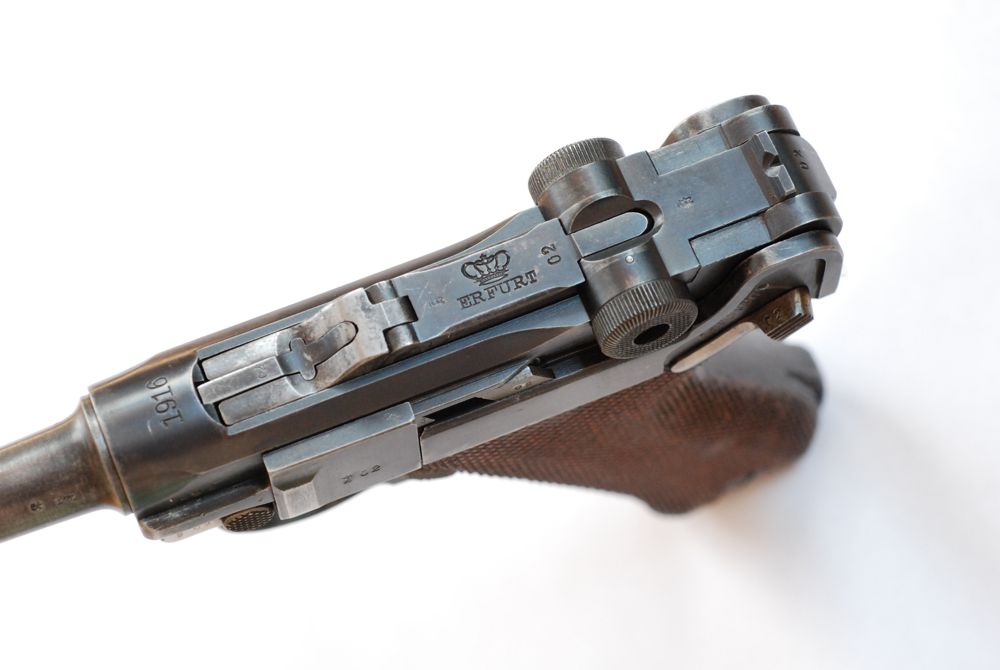

Why does this one has artillery notch on the slide? Is that normal for Erfurt Lugers?
If it is not normal - than barrel is replacement. If the barrel was replaced than other parts as well do not match on this one.
Joe,
After 1914 all Erfurt Lugers were manufactured with the notch on the receiver regardless of barrel length. Even though Erfurt only produced the LP08 in 1914, once they set up the production line to cut the notch they never went back to a standard receiver.

Joe,
Ron,
I bet it was a mistake while typing: this feature was introduced by Erfurt in mid or late 1916. There are 1916 dated Erfurts without the rear sight latch...
Best wishes,
Douglas
Unread 05-04-2012, 02:02 PM   #20
Hi Douglas, I think both you and Ron are correct. Once Erfurt switched their machinery over to notched receivers they kept making them that way until the end of production in 1918. However, they evidently had a lot of un-notched receivers in stock, and a lot of them show up dated 1916 (there were no 1915 dated Erfurts produced). Regards, Norm
