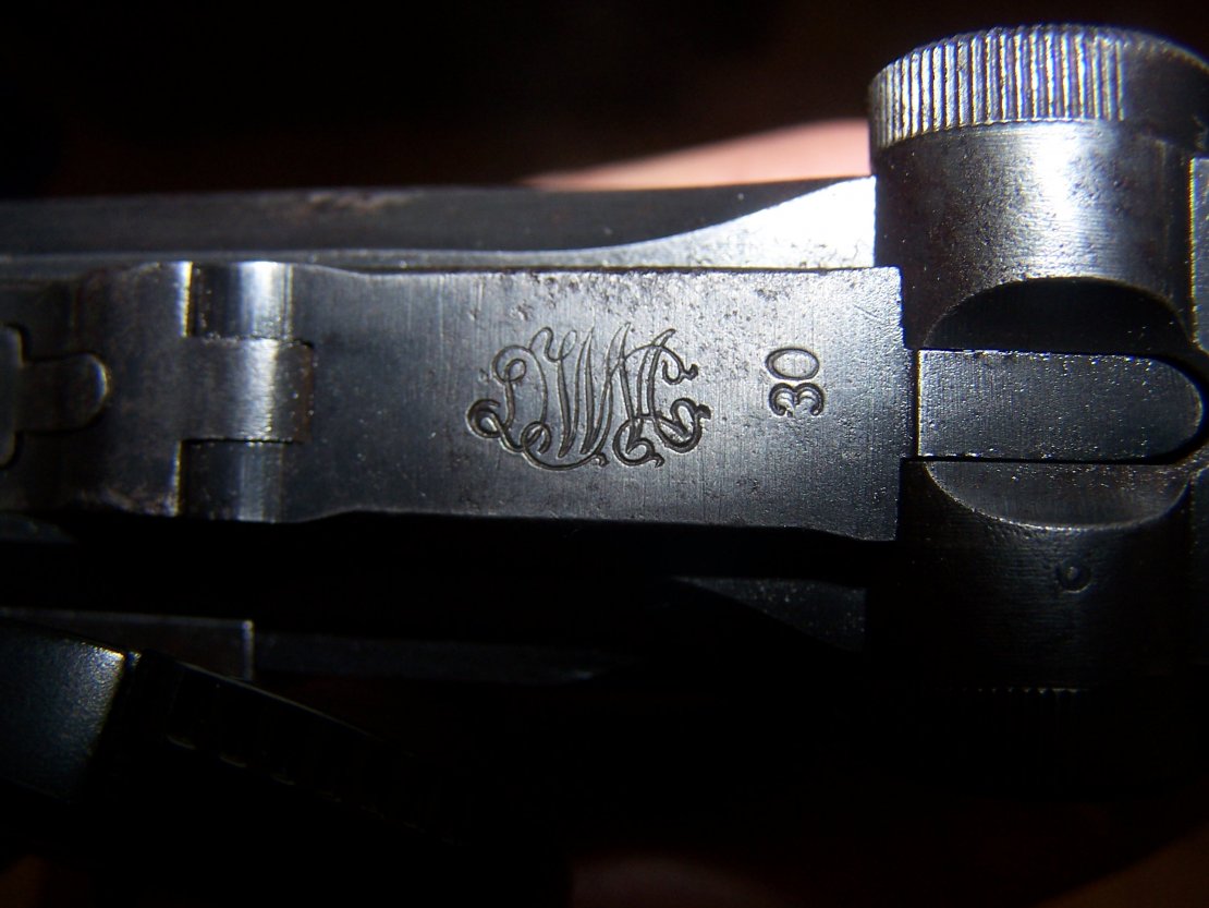

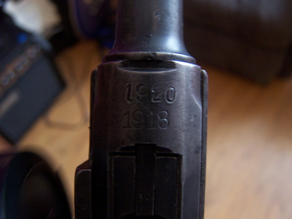

Another marking: year 1918 and year 1920 on top of the breech, DWM marking on top of the breech and type N on the left side breech.

The "1918" on top of the receiver is the year your DWM Luger was manufactured.
The "1920" mark is a Weimar Republic property mark (not a date) that indicates it was re-worked after WW-I for use by the police agency Don mentioned.

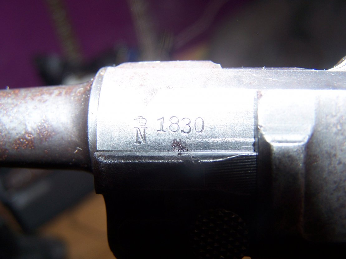

A Crown over "N" mark would be a commercial Nitro proof, which I wouldn't expect to see on a German military firearm. Is it possible that the pistol was re-proofed in Cz at some later time?

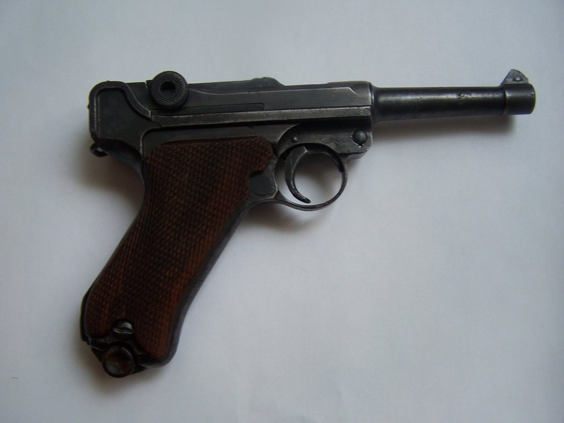

Photos of P08:

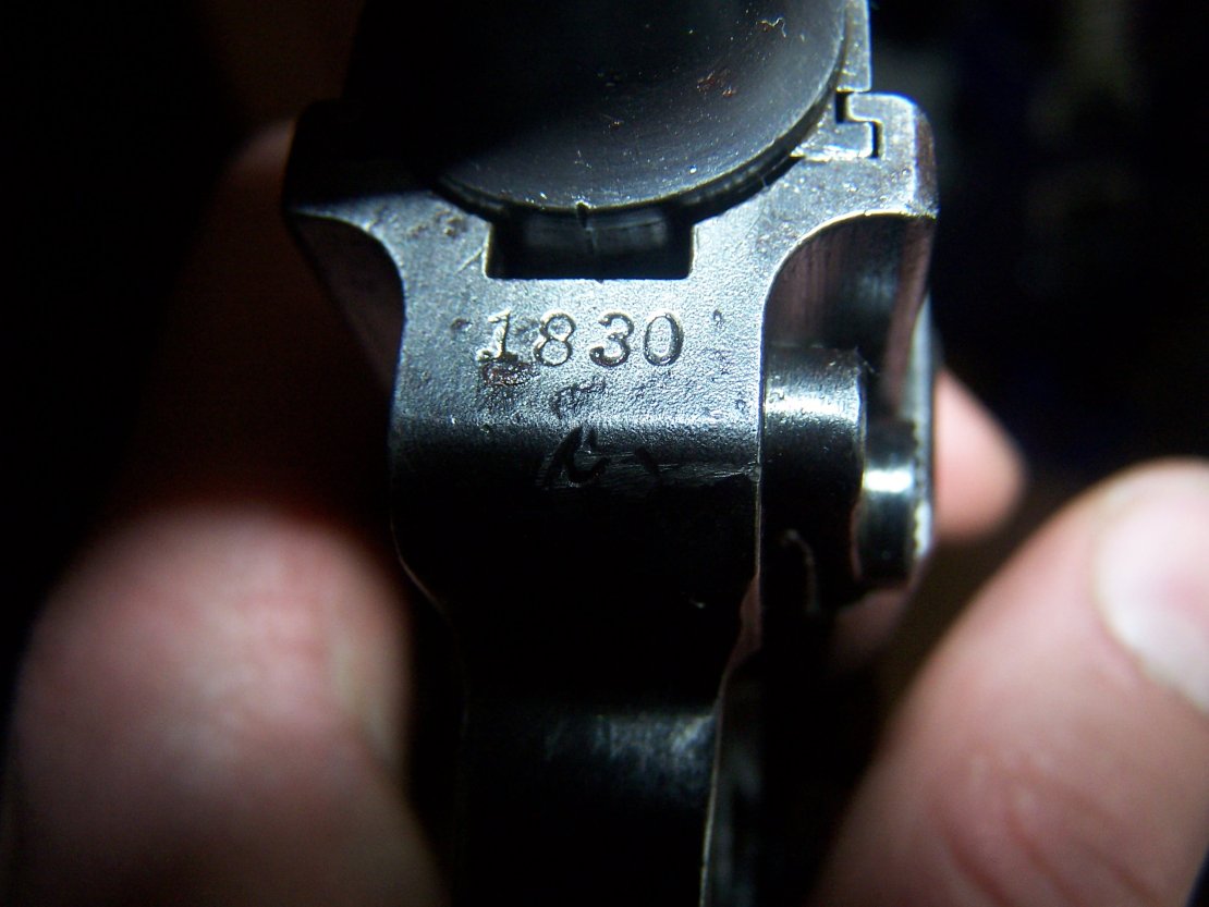

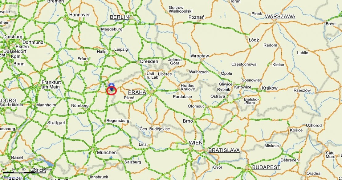

Ok, the pistol was founded here:
