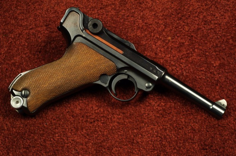

This pistol is a bit puzzling. The frame doesn't look re-blued. It's crisp and sharp and has what I would expect from an original blue finish.

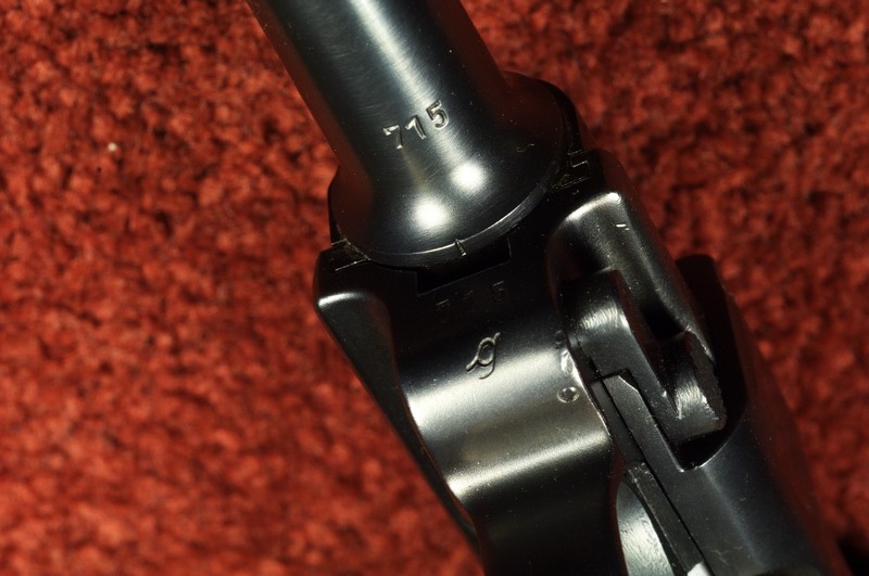

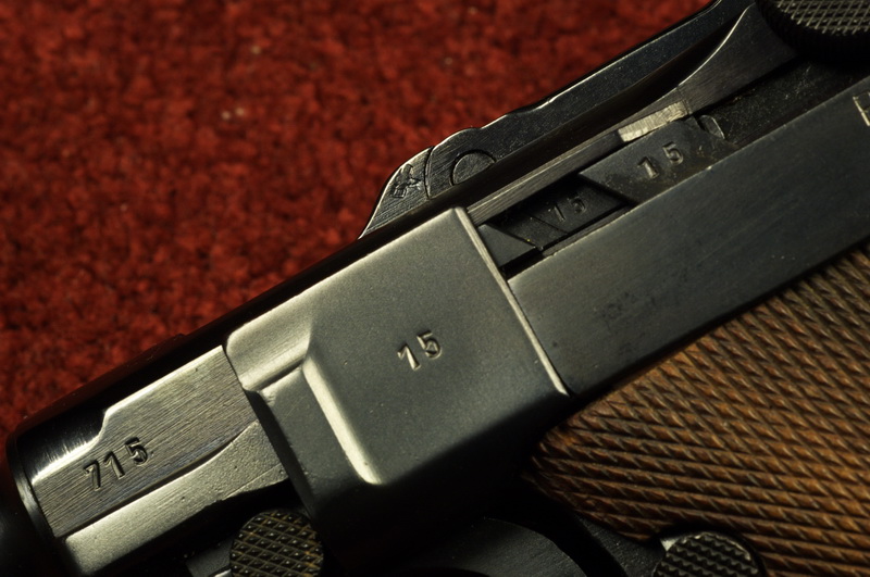

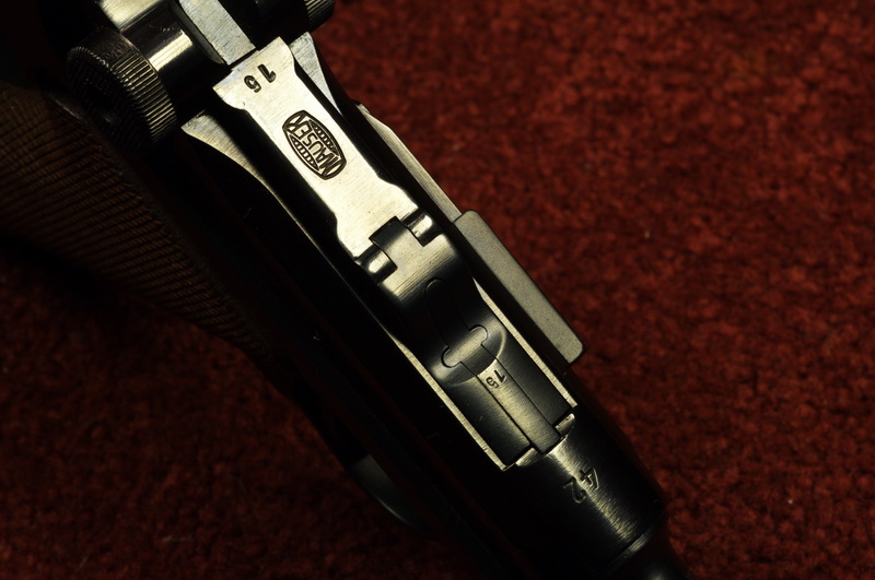

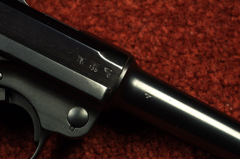

I'll add some pictures here. The receiver does have a deeper more shiny shade of blue, and the E/N proofed toggle train has a similar finish. The edges of the toggle are slightly smoothed, so that (and the blued safety bar and recoil link) point to a re-blue at some point.
But the pistol is in such "new" condition (Including a pristine bore) that I wonder when it was done. The barrel to receiver witness mark also doesn't lineup perfectly.
From Joop's comments on Jan Still's forum, "out of sequence" Lugers made up from obsolete replacement parts in the May 1942 timeframe are known in my serial number range, and this is likely one of them.
I wonder if the re-bluing of these parts was done as part of the process of finishing off these final Lugers from Mauser. All the marks on this pistol look like they were done with original Mauser dies.

Hi,
Thanks for observations... Yes - it does look re-blued to me also. The tone is different on the barrel / receiver / toggle train parts and the frame.
Some of the matte appearance of the parts is lighting, but the toggle train, receiver and barrel are noticeably shiny compared to the frame and trigger plate. The edges are sharper on the matte appearing parts.
Also, the toggle to recoil hook link is blued, it's retaining pin is blued and the safety sear block is blued. These parts should be in the white.
Since there is no wear on this pistol (tightest smooth receiver to frame fit, pristine bore), it makes me ask why this would have been re-finished in the first place.
Since it was likely made during a period when Mauser was gathering up parts from prior runs to complete the last military contract, I wonder if the work could have been done at Mauser as part of that process. Otherwise, why would someone re-finish an otherwise "new" pistol... If so, why only parts of it...

I have to say that I am really torn by this one. I copied the photos and did some color correction on them to account for the lighting and the color balance being shifted by the red background. Either this gun is nearly stone mint or it is one of the best reblue/restoration examples I have seen. I am leaning toward original.

I was looking more at the sideplate. Most that I have seen show some tool marks but that one has an even frosty look. Maybe a cast replacement?
Also on the right side (second photo) of the gun the entire frame looks blasted to me, sort of a satin blue. Certainly not the same as the top of the toggle, etc.
The finish on this gun sort of reminds me of the Interarms Parabellum guns.

Ron, I based what I must emphasize as my OPINION on this "reproduction" on the original photos and was less concerned with the color correction as I was with what appears to be mildly rounded edges (rear toggle link bevels, upper receiver in the chamber area chamfers, sideplate edges ... and the lack of serial number halos on the frame... I have been wrong before, but I don't think so this time. YMMV... A first hand evaluation might tell a different story...

Hi John, I wouldn't expect to see halos on a salt blued gun like this one. Regards, Norm

In looking at the color corrected photos, most of the contours and edges look pretty good. The thing I find most disconcerting is what David pointed out, the "satin" appearance of the frame, particularly on the right side. But it doesn't show up nearly as satin on some of the close up shots so I don't know what to think. Sure would like to have gun in hand. Perhaps photos taken on a neutral background in natural light might help.
