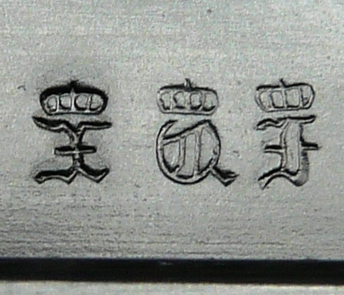

Unread 03-04-2012, 03:41 PM   #4
klaus 3338
Join Date: Jun 2009
Location: Germany
Posts: 525
Thanked 437 Times in 166 Posts
here are two pics of Spandau proofs....
there were minor variations during the years...

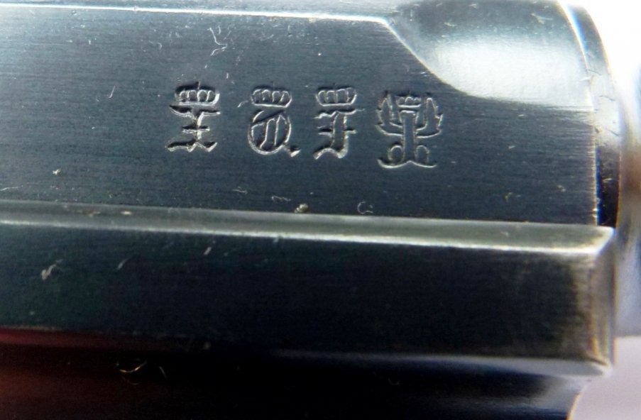

Unread 03-04-2012, 04:38 PM   #5
Hi Klaus, I never realized before that early DWMs had the Spandau mark. When did DWM get it's own eagle? Here's a clearer photo for your files. Best regards, Norm

Dwight- you used the words “Erfurt style proof” for the power proof stamps (Beschussstempel in German) on all Erfurt Lugers and the breech blocks and barrels on the DMW Lugers 1915-1918.
The "Spandau proofs" are the power proof stamps on the DWM Lugers until 1915. As you reports above came the "Abnahmebeamte" Proofing officers and inspectors for the DWM Lugers from the Spandau Arsenal. And that was the reason that I used the words Spandau proofs.
Regards Klaus

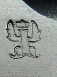

Unread 03-06-2012, 08:58 AM   #12
Is this Spandau 'squirrel'? it looks like a DWM one
Q1: Does Spandau proof always come with Spandau toggle link?
Q2: Gortz and Walter said "surely.... Spandau guns were caninibalized from damaged guns during a time of great stress -- the great Spring Offensive of 1918".... no further explanation in the article though.... why 1918?
Initially, I guessed samples having 1918 on chamber.... but on second thought, that does not explain why only 1918 guns were damaged.

Klaus -
Is that 'crouching squirrel with a crown' proof you posted a Spandau proof???
(Or should I say "Spandau inspectors' proof")???
It is the Spandau Power proof.
Spandau Inspecotor proofs are the crown/ gotic letter acceptance stamps as on the added picture.
I think that my English is too bad to write about the acceptance stamps.
Sorry
Klaus
All DWM Lugers were proofed by inspectors which were stationed in Spandau. Spandau is a small city near Berlin where the DWM Lugers were made.
Answer for Q1: The Spandau proof we are talking about has nothing to do with the Spandau toggle
The following member says Thank You to klaus 3338 for your post:
