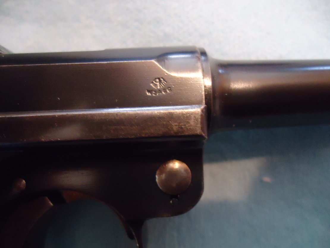

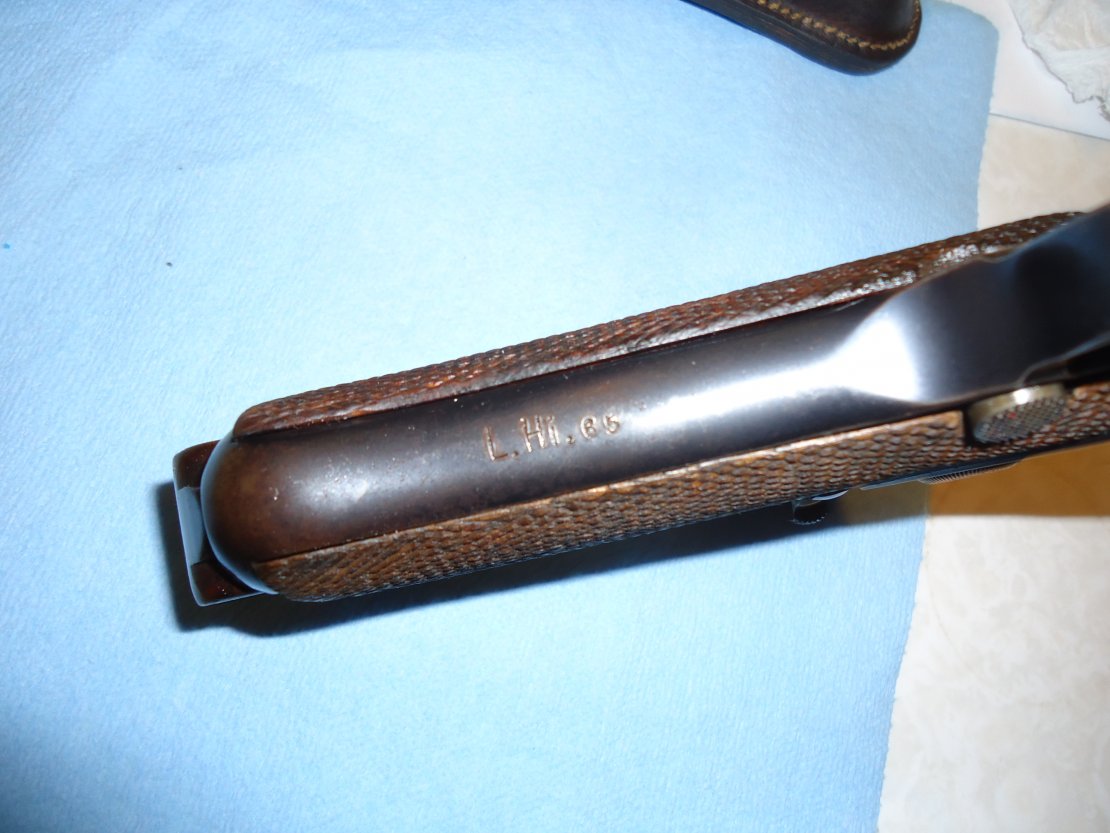

help identifying unit marking L.Hi.65 on early comercial model undated chamber, 9mm,, thank you

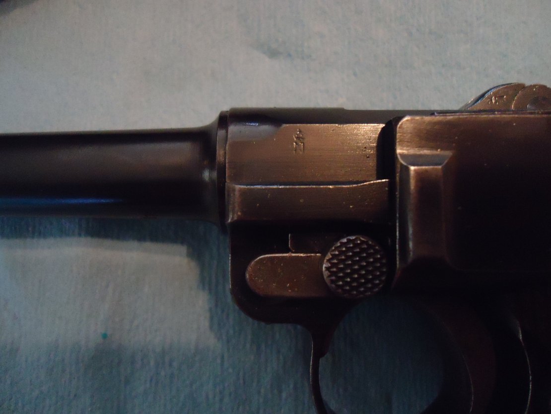

not sure of the production date of this fine early model commercial serial number 2331 9mm, unmarked , all numbers matching

Looks like rural constabulary Hildesheim district.
http://www.radix.net/~bbrown/police_unit_marks.html

thanks, i now know the unit markings and it is a a 1929dwm, with a police safety, rebarelled to 9mm

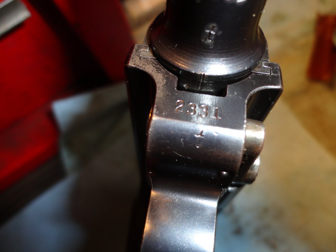

One small correction. I assume that your identification of the pistol as a 29DWM means it has an "s", "t" or "u" suffix. If so, it left the factory as a 9-mm pistol and was not rebarreled.

yes serial number is 2331 "t", i was told on the comercial thread it was rebarreled from 7.65 to 9mm. all i know is what i am told on this forum, i have owned several lugers before these but have never asked for help on those. Hi Dan,
Thanks for posting your extremely nice Luger.
Your Luger, S#2331t, is classified as a 29DWM in Jan Still's 'Weimar Lugers'. It was made in 1929. As Jerry stated before, this Luger started out as a commercial. It originally had a 30 cal. barrel. and no sear safety. The 9mm barrel and sear safety were added at an arsenal. Most 29DWM's were procured by the Army or Police. Only a few were sold commercially.
Mike C. This is what i was told on the comercial thread. Is this incorrect? thanks

Sorry for the confusion. It was the earlier 30 cal. Alphabet commercials I was thinking about, that were rebarreled for the police. Your 29DWM only had the sear safety added at an arsenal.
Mike C.

I agree with Don, Lugers in the "s", "t" or "u" suffix with the characteristics described above (termed 29DWM) most probably were manufactured with a 9mm barrel.
