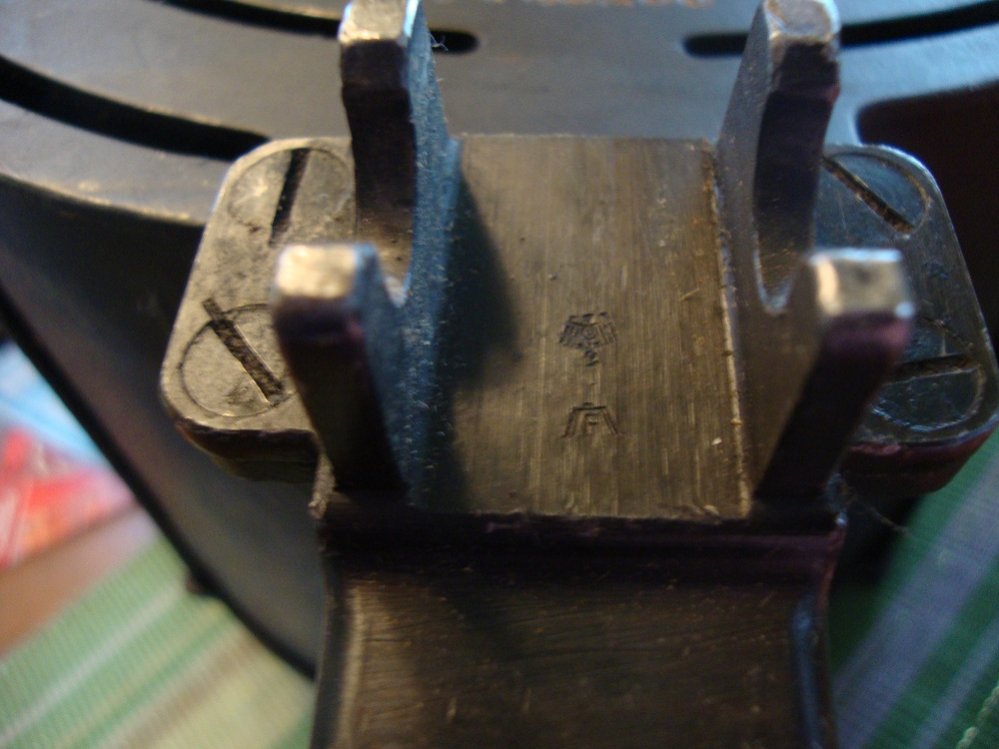

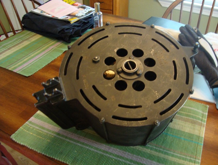

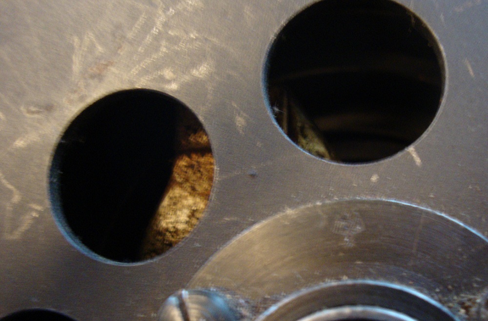

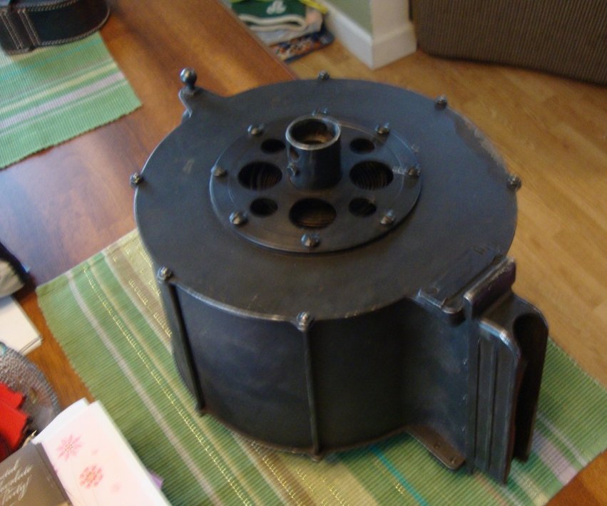

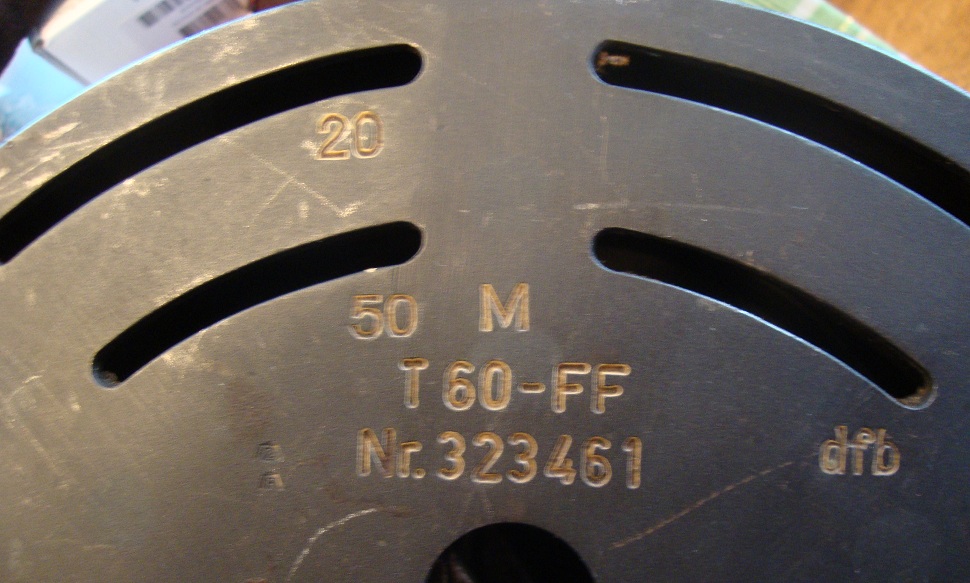

Got this 20mm drum mag, and I'm exactly sure what it's off of? Also would like to know what it's currently worth today?
It is maker marked, "dfb" and has several waffenampts on it, including "eagel/2", "Lufteagle/2", and "Lufteagle/F"
Thanks for any help,
Matt

This looks like a derivative of the Swiss Oerlikon's feeding drum, which was widely licensed or copied by other nations.

Did some searching and found out that this is a drum magazine for an MG FF 20mm cannon. It was used by the Luftwaffe from 1935. By 1941 it was gradually being replaced by the MG151/20. It was used on several aircraft such as the Me-109E3-F1, the FW190A1-A5, the Ju88, He-111, Do17, Do217, as well as many other aircraft. Later in the war it made a comback in the Me110 night fighters. Many G-series night fighters were retrofitted or factory-built with the Schräge Musik off-bore gun system, firing upward at an oblique angle for shooting down bombers while passing underneath, frequently equipped with two 20 mm MG FF/M. They fit perfectly to the back of the rear cockpit!
