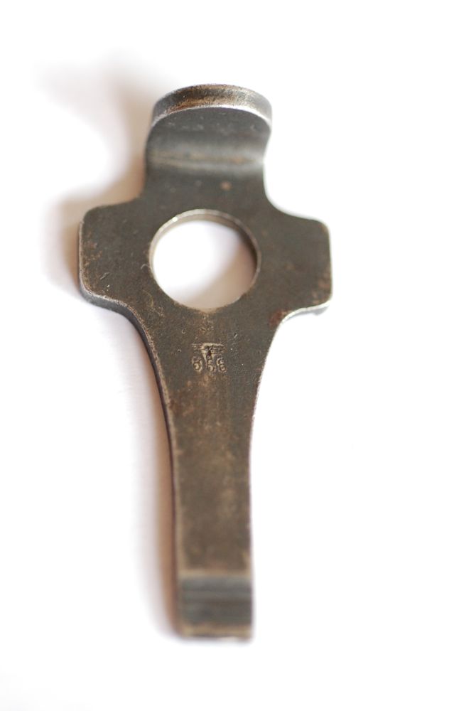

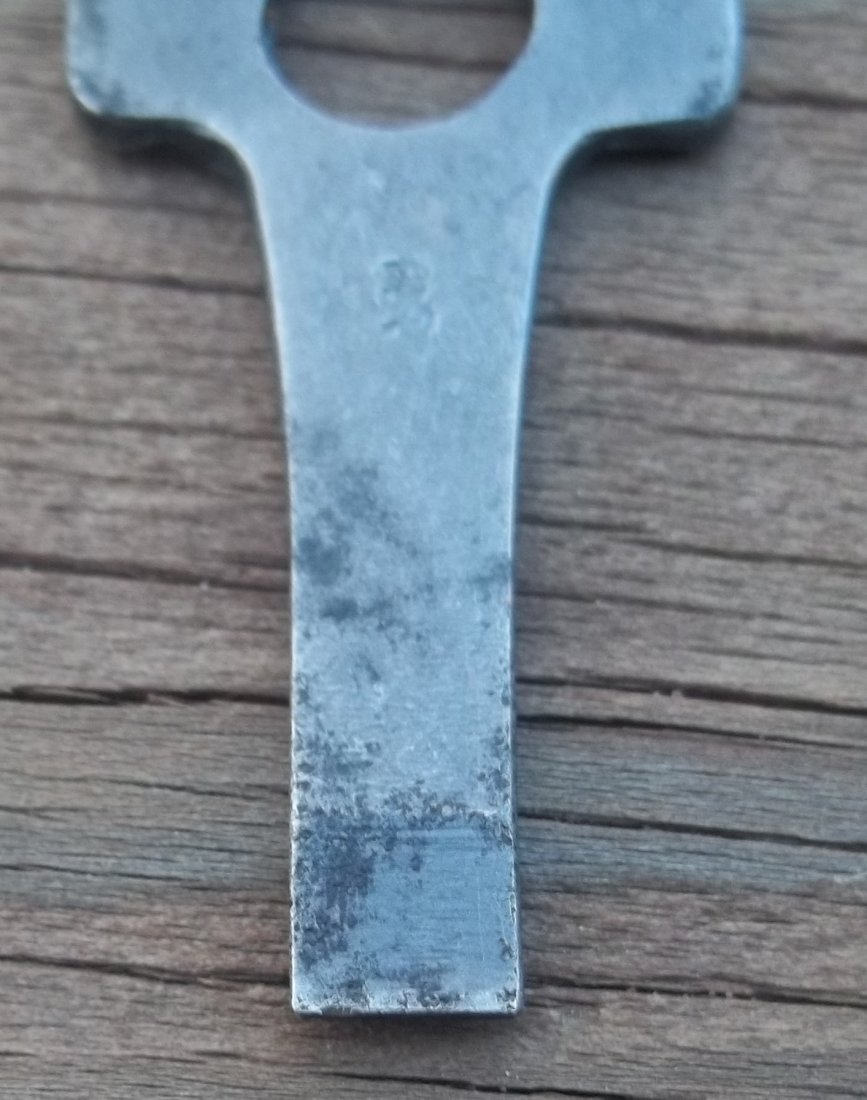

I have a 1939 Mauser 42 code Luger, what markings should be on an original take down tool. I am looking for an original tool. Also, I have another original take down tool that has a crown with a number 3 below it. I think it is for a WW1 Luger, correct me if I am wrong.

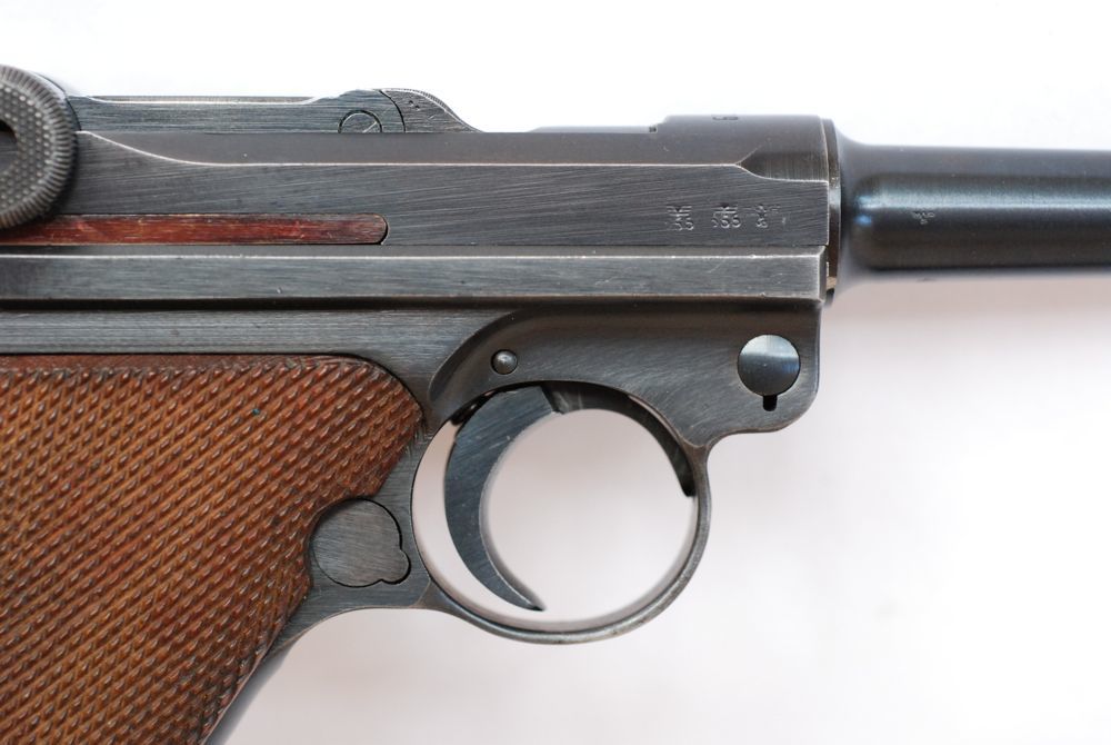

Hi Rob, Your 1939 42 Mauser has two stick eagle/655 inspection marks on it's left receiver, like the one shown. The tool should have the same mark. Regard, Norm

Doug,
Sorry to disagree but, this is the way I understand it...
The 'Crown/gothic letter' is a military acceptance stamp. Different stamps, with the first letter of the inspectors last name, were assigned to each individual inspector. Many different letters can be found on WWI tools.
WWII military tools should have an acceptance stamp.
There are a few WWII era unmarked commercial tools but, would not be correct for a military rig.
Most unmarked tools are DWM (the shape is different) and are correct with military or commercial rigs.
Robert,
You probably have a C/Z marked tool.
Mike C.

Rob280
I have attached a picture of a DWM Crown Z accepted tool for comparison.
Thanks

Mike is right.
I vapor locked while typing, as I was thinking of something else. It is a Crown/Z tool.
Sorry for the confusion.
