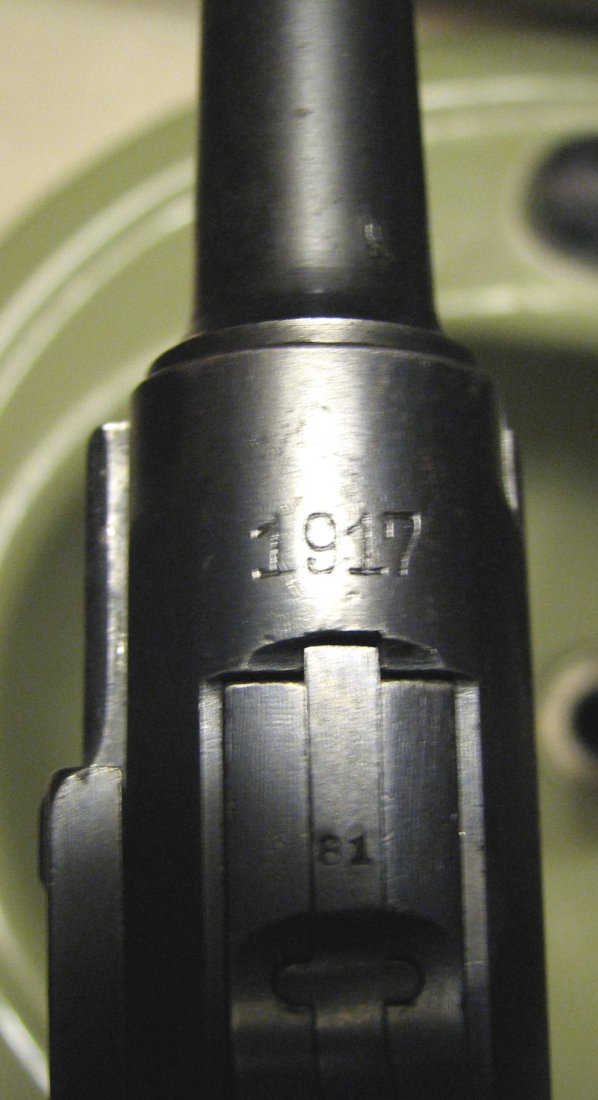

You have a WW1 DWM (I assume, since you did not show the top of the gun).
What is it dated?

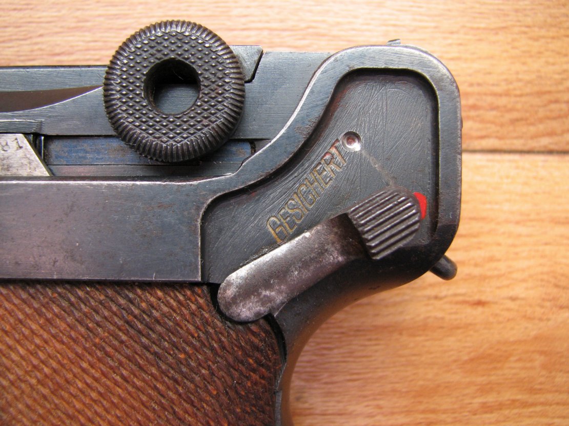

KEEP YOUR FINGER OFF THE TRIGGER. Since your gun has the relieved sear bar (nevermind what that means for now) leave the gun on "safe" (the GESICERT mark will be visible). Remove the magazine and pull back on the toggle knobs as far as they will go. If there is a round in the chamber, it will be ejected.
Unread 01-06-2012, 08:51 PM   #8
Fred, Remove the magazine from the pistol by pushing the button behind the trigger on the left side..the magazine will likely fall down at least enough to be withdrawn easily. Look to see if there is any ammunition in the magazine.
The pistol is on safe according to the photo's you show. It should be safe to remove the magazine.
Take the pistol outside to soft ground..point it at the ground in your left hand and push the safety forward to the fire position. Grasp the toggle knobs on the top of the pistol and pull up and back. Remember to keep your finger OUT of the trigger guard. When you pull up and back on the toggle the round in the chamber will eject and likely lock the toggle in the rearward position making the weapon safe.

The toggle will not lock back without an empty mag in the gun. Otherwise, your procedure is OK.

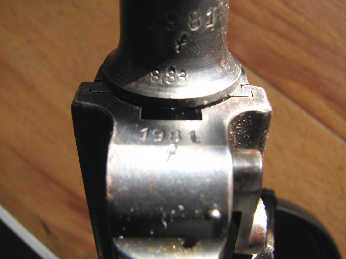

Your 1917 DWM pistol s/n 1981f looks like it's probably all matching, and in it's original finish.
Even with the pitting damage on the trigger plate, it is a collectable pistol, so you should avoid anything that could break a number matching part (like shooting it), and not attempt to do things that could damage the finish or the grips.

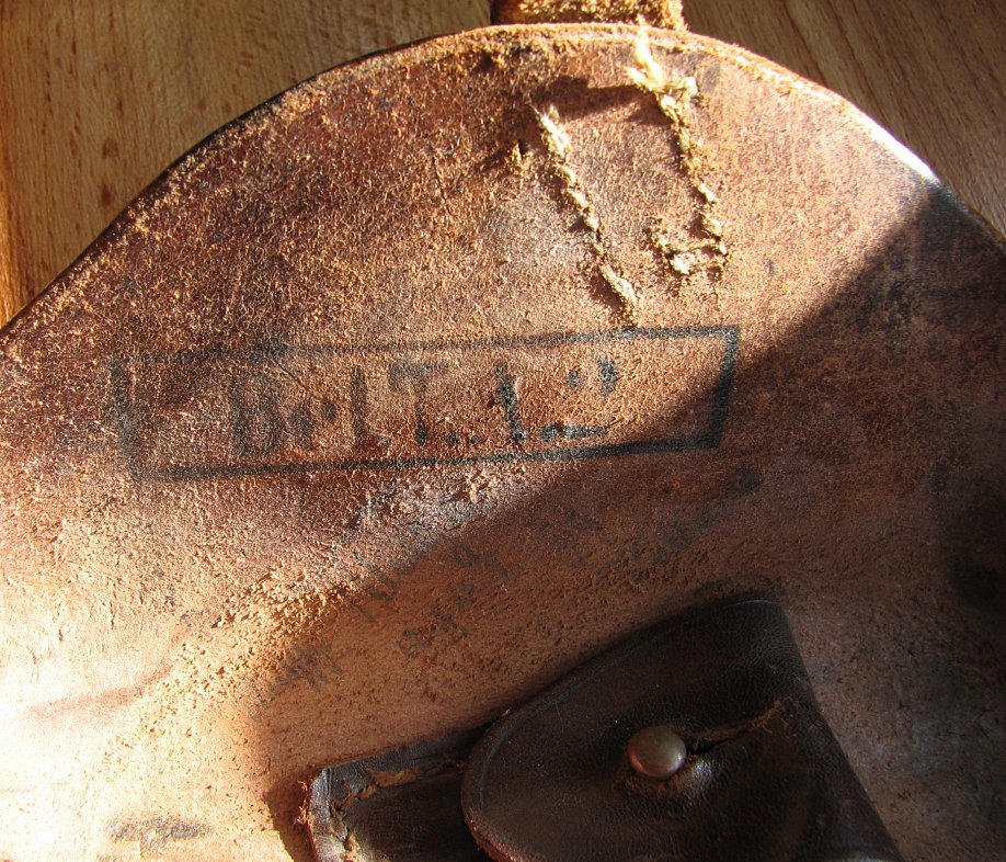

You also have a very collectable 1913 pre WW-I holster.
Don't store your pistol in the holster. The tanning chemicals can, over time, cause the kind of pitting you see on the trigger plate.

Don't try and clean or soften the holster. Jerry Burney on this board is the expert on holsters. Check by posting questions before you do anything that can't be reversed.
