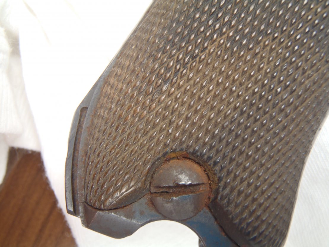

Looking for a replacement hand grip screw. I acquired this and want to disassemble and clean but noticed the screw probably won't make it. Are these hard to come by? The numbers match but it is a little crusty. I am going to clean the hand grips the way that is posted, anything special to cleaning the pistol itself? I am planning on just using gun gleaner and a toothbrush to clean, then coating with a light coat of oil.
Thanks,
Thomas

Thomas..With a pistol that rusty you need some help from 0000 steel wool. Dipped liberally in oil steel wool will take off the rust and leave whatever bluing is left intact.
Just be sure there is plenty of oil involved. Don't use it dry or with solvent. OIL.

Howard, thanks for the offer. I will pm you the address. I tried to unscrew it today and it did break. I am just trying to get rid of the rust. I am going to give the steel wool a try.

When you say the screw did break. Do you mean it broke loose or it broke?

The screw head broke in half. The stud part of the screw is still in it. I'm just going to let it soak for a while, then try to get it out.
But the good thing is, I got the grips off and the serial numbers match the pistol. I am going to clean them up, they should turn out good.

I got the screw out. After the head broke off, I took it to a gunsmith who removed it for $25, at least I didn't mess it up. Now I have to finish cleaning it, put it back together and enjoy it for years to come.

Apparently the rust was pretty bad, but in many cases soaking the rusty screw and area in Kroil Oil will loosen it up and it will come out without that hassle and expense. I realize that the area of the grip is tough to work in.
