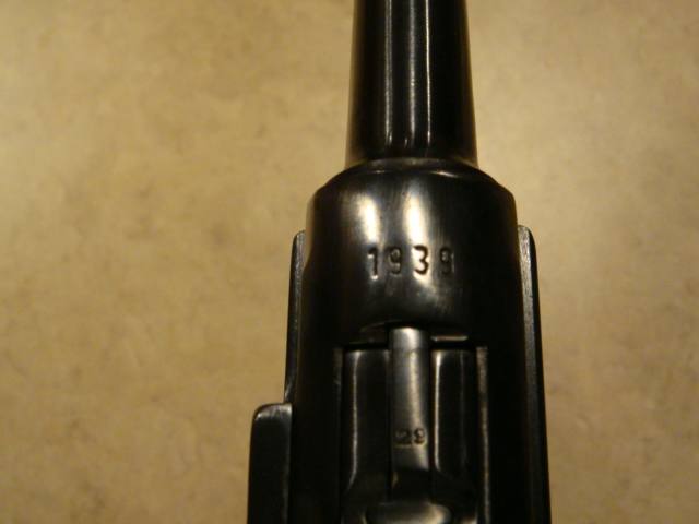

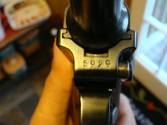

I just acuired this luger not all the numbers match. any info and value would be much appreciated.

i figured it was a shooter i wasnt sure about the reblued because the edges are sharp. i was curious about the marks on the side of the top slide.

most interested in markings from pic 3 4 5

Hi Raymond, As Vern mentioned, your gun is made up from parts of two different guns (at least). The eagle on the breech block, in photo #3 is an Imperial (pre 1918) firing proof. The Eagle/655's are Mauser inspection marks used between 1939 and 1941. Regards, Norm

A properly functioning refinished mis-matched "shooter" grade Luger would be priced between $500 and $1000, with many like this in the $600 range.
The serial number which is normally recorded for a Luger is the one found on the front of the frame above the trigger guard. There may be a script letter under the "5929" shown. If so, it's part of the serial number, and a suffix. "5929x"
The typeface of the number stamped here doesn't look like the dies used by DWM, but it may be original and just look different due to heavy buffing.

there is no leter suffex under the serial number any way to get the proper year from the main serial number. as mentioned only the barrel and barrel extention ???? are different from the main serial number.

Unfortunately, every 10,000 pistols, the 4 digit numbers were repeated. The numbers went from 1 to 10,000.
There were various periods when the entire numbering sequences repeated depending upon whether the Luger was a commercial or a military firearm. Since the receiver (dated in 1939) and the frame and the barrel are all from different guns, in different eras, I'm not sure of a good way to date the frame except to look inside and try and find similarities to the manufacturing work marks with those of another period pistol.
