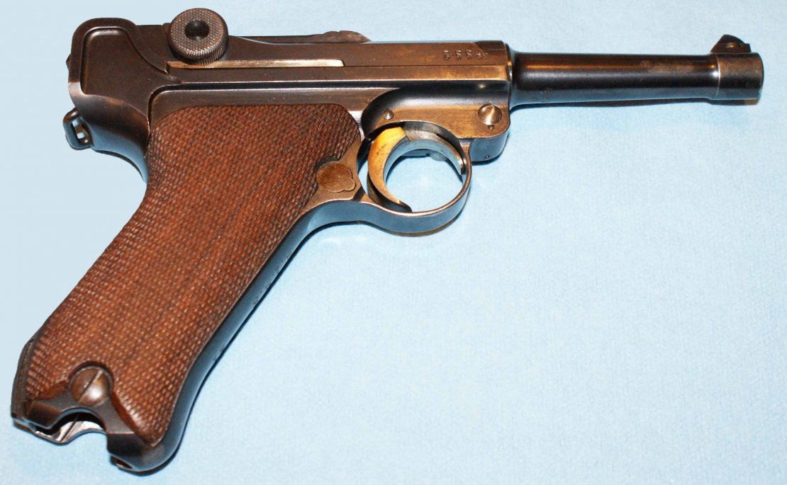

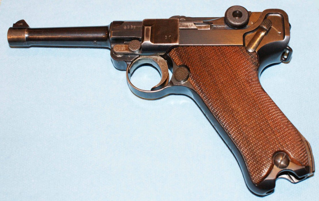

Oh-My-God! I followed the steps above from Art Buchanan's article, and the old girl now looks like an 16 year old. After about 1.5 hours in the Strip-X and after cleaning the grips, they looked pale yellow. I then put 2 rubbings of lemon oil on the grips and they have a natural walnut look, and they just shine. Could not be happier.
Thanks guys
Gary
gsewell is offline   Reply With Quote
Old 09-12-2011, 09:41 PM   #8
gsewell
Join Date: Sep 2011
Posts: 6
Pictures!
Keep in mind when I started the grips were almost black.

Arts been doing this all for a loooonnnng time.. pretty tough to get any better instructions then the ones written by Art, Looks nice, just like new!! best to you, til...lat'r...GT

Those grips look fantastic! I, too, have found that lemon oil brings out the natural beauty of the wood and makes the grain vibrant. After cleaning, grips can look grey like wood on an old barn...apply lemon oil and they come alive. Good job! Thanks for sharing.
