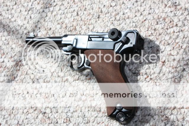

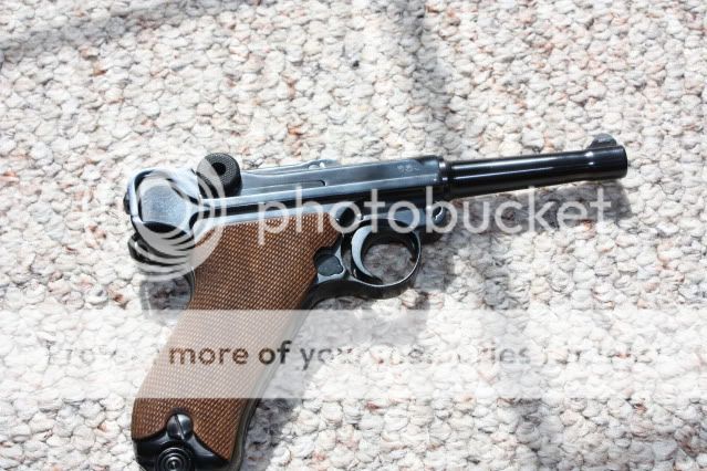

Hello all,
My name is Dave and I'm looking to buy my first Luger. A guy offered this one up for sale at $575 as a shooter.
I would appreciate anyone and everyone's opinion on it.

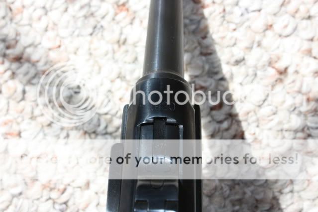

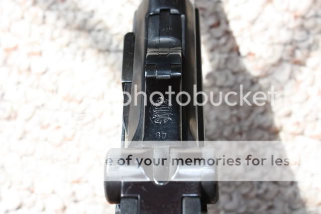

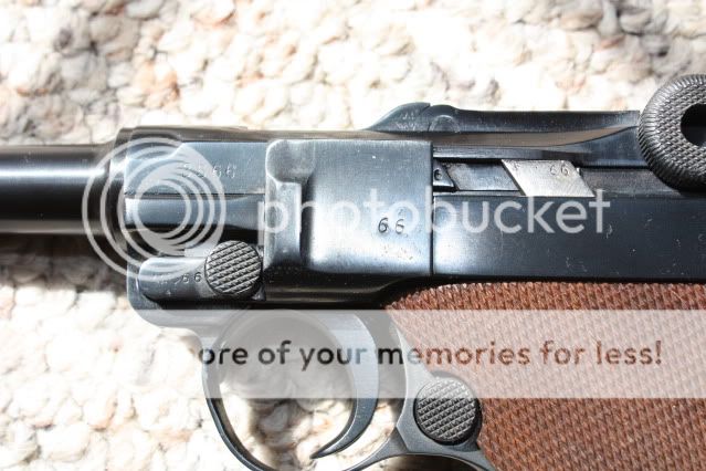

It's a 1920 DWM all number match - except the toggle. Believed to be reblued, and I don't see any strawing. No rust - and very nice bore.
I'm not looking for a super collecter. Just a some time shooter and interesting gun to own.
Is it OK to shoot these quite a bit or am I risking not being able to get parts later if something breaks.
Or buy something better? OR... ?????
Is it a fair price?
Thank you all for any and all help.
Dave

$575 is a good price for a reblued 9mm luger, this one looks very nice and yes it should be strawed, but what the heck.
Shooters aren't always dependable, can be a mixture of magazines or parts being weird.
Ask if its been shot?
That said, I would buy most lugers that look nice like this for $500-$600 most any day

I think that it looks like a nice shooter and worth that money. And FYI you can do the straw coloring in your own kitchen quite easily. 9mm or .30 cal?
Parts are available. You might ask for a 3 day shooting inspection period to make sure that it functiuons correctly, or have him meet you at a range.

Stock lug has been ground off...Grips are new repros...Mag is a repro...$575 is IMO high for this Luger...but I'm sure you could part it out and get your money back...I know; I'm prejudiced against lugless lugers...It's my upbringing...Everybody else is buying these up as fast as they can...I'm just a Luger Lug Snob...

Good catch Postino, but to me, a shooter is a shooter
The stock lug is on the back strap and most lugers have them, you can put on a stock and make it a mini rifle, HOWEVER that said, it is only allowed on artillery, navy and a few other lugers, NOT 4 inch ones. It is illegal in the USA to attach a stock to a pistol. Why did the germans put stock lugs on? did they use stocks on 4 inch lugers? No, it is highly doubtful if they ever did that.
but, you could use that as a means of possibly getting the price down.
It doesn't change the view I have of its value, the only thing is if the lug was ground down too far and goes into the handle / through the handle, I have seen that, but it would be obvious.
Finding lugers for less than 600 is possible, if you want to look around and wait. Personally I would write down what was said here and talk to the shop or owner or whatever, also ask to check the bore condition.
