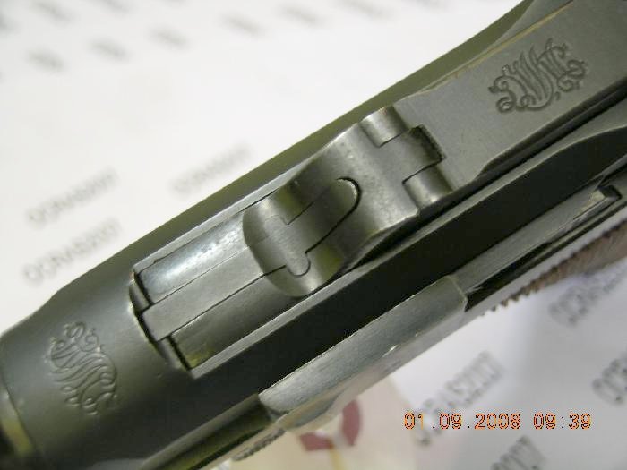

While looking for pics of Luger carbines with forearms removed (and finding mostly links, not pics!), I noticed this -
DMW Luger in 30 Luger Caliber, with an 18” Barrel
http://www.auctionarms.com/search/di...temnum=8506929
besides being sold by Sarco, and having a German commercial proof on the barrel, it has a receiver with the DWM scroll on the *chamber*...as well as on the toggle...
How common is this???
(Pic below)

Rich, The DWM on the chamber is not common on Lugers but is found on a contract pistol..Bulgarian maybe? Where they put the country crest on the toggle and moved the DWM to the chamber.
Unread 05-24-2011, 12:14 PM   #3
Jerry's identification is correct. This is a made up piece. It has a receiver from a 1908 Bulgarian Luger and probably was fabricated sometime after the mid-1960s.
Unread 05-24-2011, 12:24 PM   #4
Ah! That makes sense! Sarco was putting together parts Lugers back in '08...And now I see the frame & receiver numbers don't match...and the rear sight is similar to an artillery, but the slider button is on the wrong side (like a C96 Mauser)...
And it has an odd [to me] proof on that DWM marked chamber/receiver...Looks like a Norwegian or Swedish proof...???...Bulgarian???...

It is a Bulgarian rampant lion, as found in their national crest.
