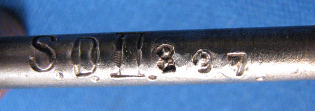

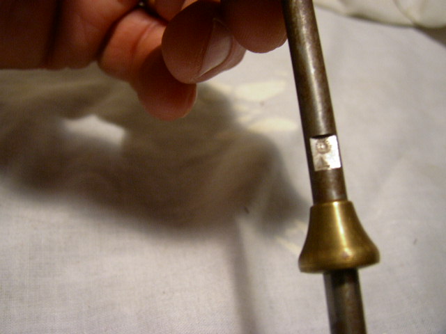

Slot cut in rod has star/sunburst with an L underneath. Same star as on some police luger magazines. According to Gortz and Sturgess this is a converted artillery rod. Lots of patina and rust. I cleaned the area where the star L is in order to see it. No other marks on rod. Comments?

Never saw one like it Bill. I believe it could be a converted Artillery rod...

Bill,
I am for myself sure that none or if than only very few LP08 rods were altered for the police. I do not know how many I found during the years but that were many.
The wooden handle distinguee from the LP08 rod. The police had 7 rings with the same distance between the rings and they were not so deep cut into the wood as on the LP08 rods.
There is another difference: (hard to explain for me in English) The shaft of the police rods are not formed like a spiral or thread.
I also have never seen the cut on a rod when I found it in Germany.
Can I see the shaft, please?
I hope that helps.
Regards Klaus

One more thing: Mostly were numbers on the part over the stop. One I owned had S.D.IV. and a number on it.

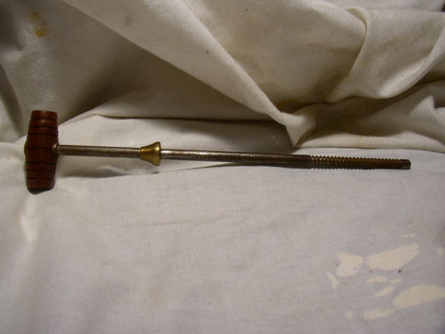

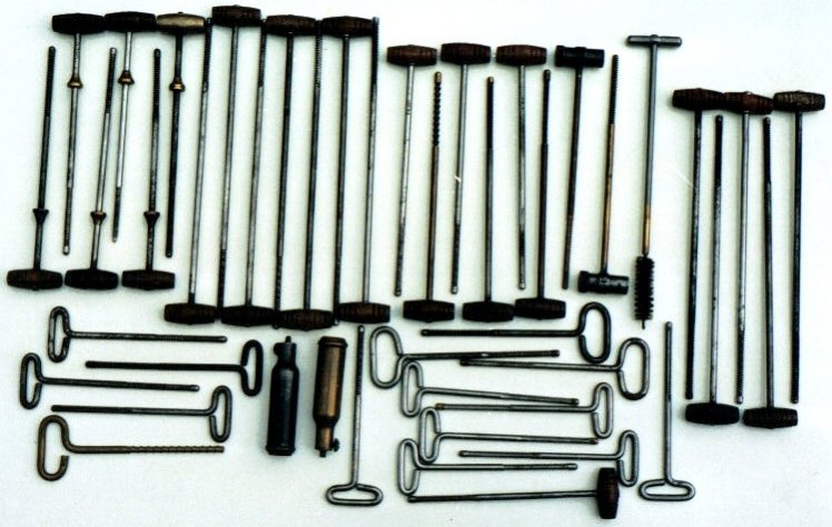

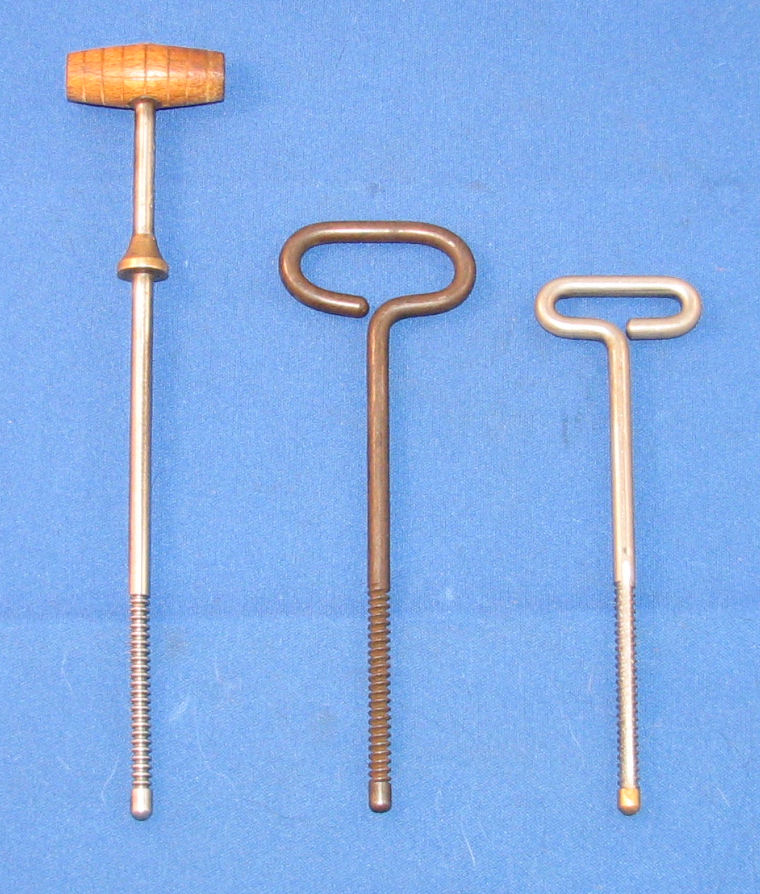

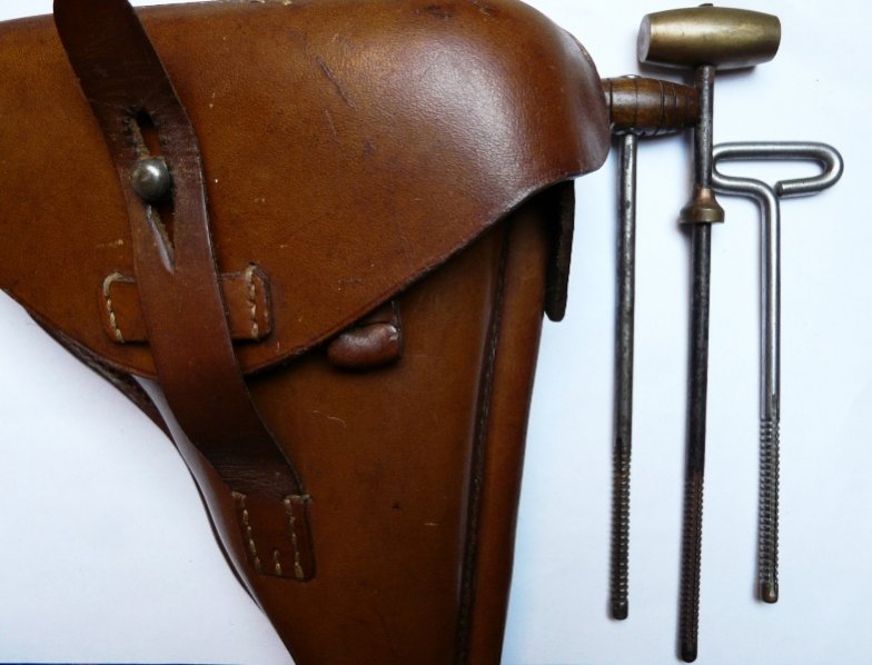

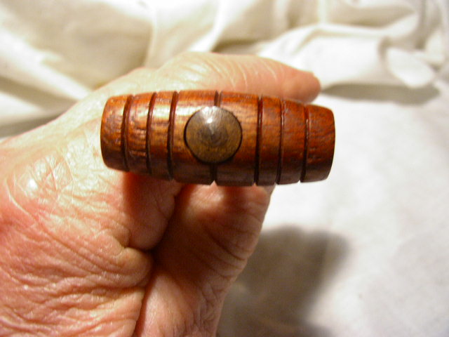

here is my police rod

Edward,
that is a pretty and correct example of a police rod.
Thanks for the photos.
The others are also interesting.
I have an exact "copy" of the second in the middle but do not know when it was made for ? (hope that was English). It is not the typical rod from 1906/1910.
The right one with the brass tip and the small loop could be one of the type which I found in
Sweden.
Unread 05-10-2011, 05:29 PM   #7
Thanks: 2,078
The middle one came with a 1926 holster and a friend of mine, Jim, has a rod that looks just like it, except his has an eagle 6 (simson) marking, and we both believe that the 1926 holsters were made for simson's (or likely were)

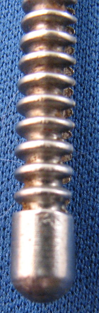

Klaus,
Thanks for your input.
According to Gortz and Sturgess Vol 3 pg 1522:
"After 1918 numbers of LP08 cleaning rods were shortened to be used for the 100mm barreled P08 in police service."
"New handles usually of beechwood and having seven rings were fitted."
"New rods were also made to this specification but they lack the protective cap. The screw thread is shorter being only 40mm long and the usable thread start at the tip clearly differentiates these newly made from converted."
Their picture examples show spiraling threads.
I assume if artillery rods were cut down the threads would be spiralled (original artillery).

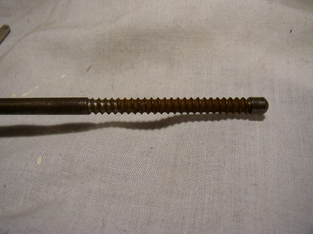

Here is a picture of the threads on my rod.
Jan Still's Weimar Luger and Early Nazi Lugers on page 182 shows two police rods. One appears to spiral; one doesn't?
It seems cleaning rods are a separate world with very little research or understanding.

Also in Bender's book Luger Holsters and Accessories on page 301 are 3 Weimar rods. Two have spiralled cleaning shafts and one does not. Obviously they were made both ways. Unless one or the other is fake which I doubt. Bill
