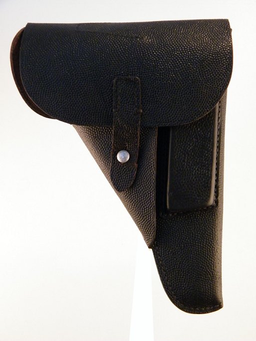

All in all a pretty consistent DDR VoPo rig. It only needs a holster
I'm looking......I like those pebble grain ones.....
