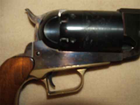

This is what I call fire blue, just a propane torch

It works. I should have mentioned the entire Walker above is 'fire blued'. Also should have mentioned, I also use a Mapp gas torch. By hold the flame on one small place, I can create the color case hardened effect, moving it when color starts to change. After 10 years or so, the color on the barrel is starting to wear off.

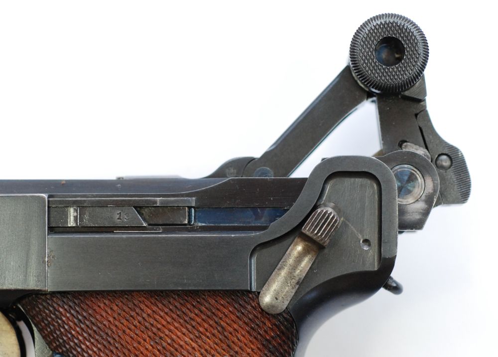

Thor has found a nearly perfect match for the early DWM rust blue. Borchardts are not fire blued, they are rust blued. Springs, pins and sights were fire blued but not the gun.
Unread 03-26-2011, 05:58 PM   #7
To illustrate what Ron said, here's the difference between fire blue and rust blue. Regards, Norm

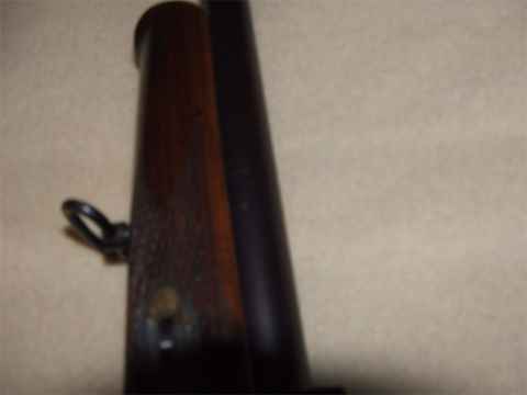

About 15 years ago, or so, I rust blued my carbine with some 'german rust blue' I bought from a guy running a small ad in Shotgun News. Was easy and made a satiny finish. It was in a small bottle and a thick, kind of beige color. Not sure if pics do it justice, dark, but not black.

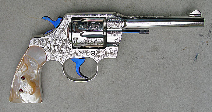

The small parts were fire blued, not the whole gun. "Fire Bluing" can also be done in your kitchen oven if it will heat up to 550 degrees. I do strawing and fire bluing in my electric kitchen oven. If you don't get the color just right, it polishes off easily and can be redone. The secret to a good job is a high polish and absolutly clean of any oil (including body oil from your fingers!)

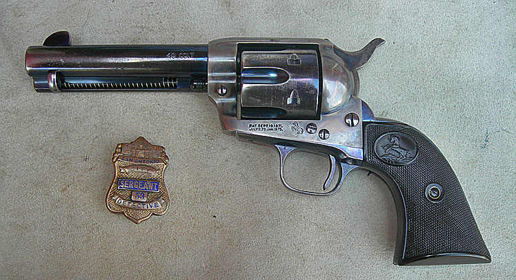

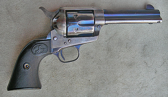

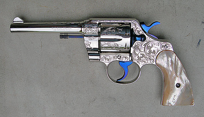

Default Examples of "Fire or Nitre Bluing"
The Single Action has all parts except for the casehardened frame & hammer Nitre Blued.
