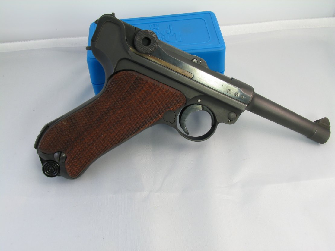

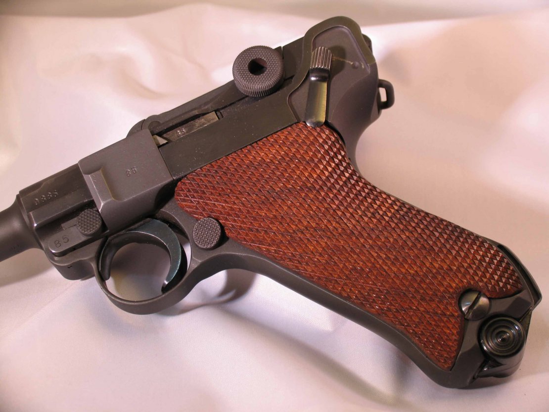

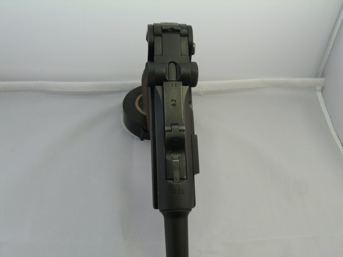

I've been visiting this forum for a few weeks now and have finally decided to make a posting. I have what I believe to be a P08 made in 1939 with all matching parts and 42 stamped on the top. My question is, is this a shooter?

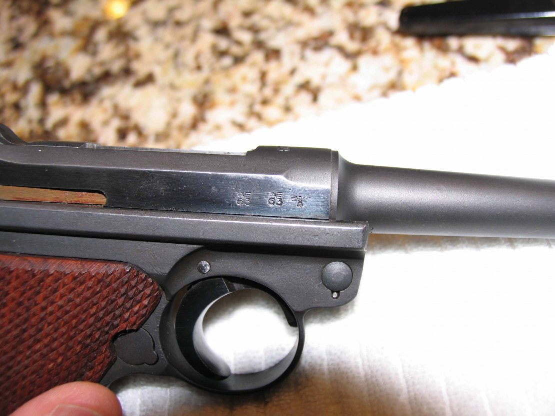

Default Some Pictures
I'll try to get some pictures up loaded.

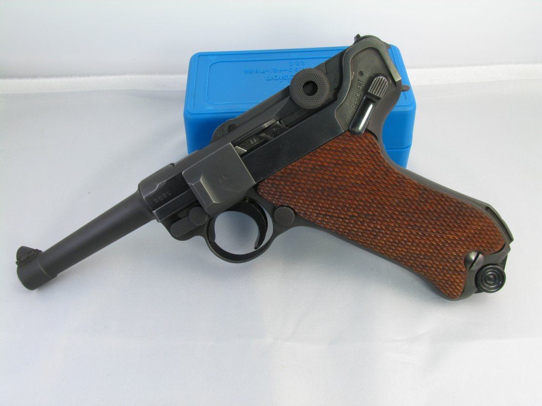

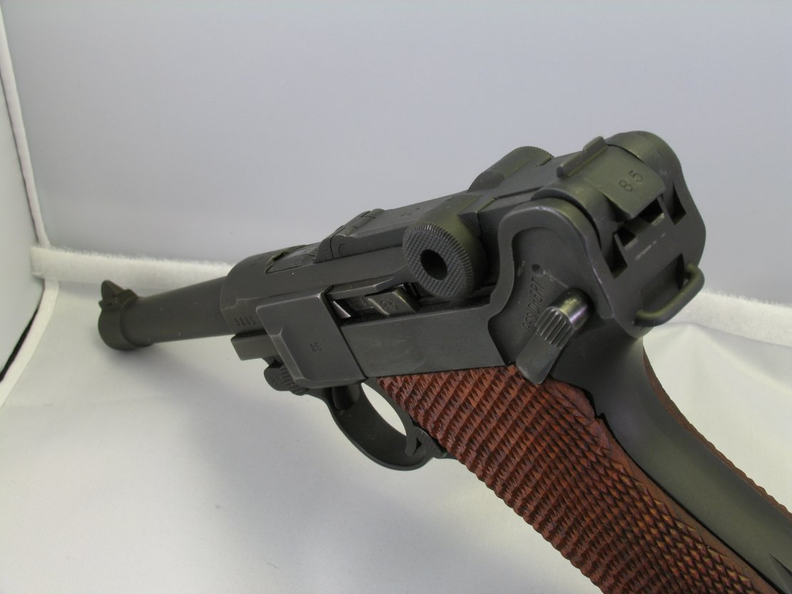

Refinished, grips and mag are aftermarket. I don't know what you have in it or want to do with it, but as is it is a shooter. It may be worth having Thor restore but I'm not seeing enough detail to make that call.
Go have fun and make lots of noise.

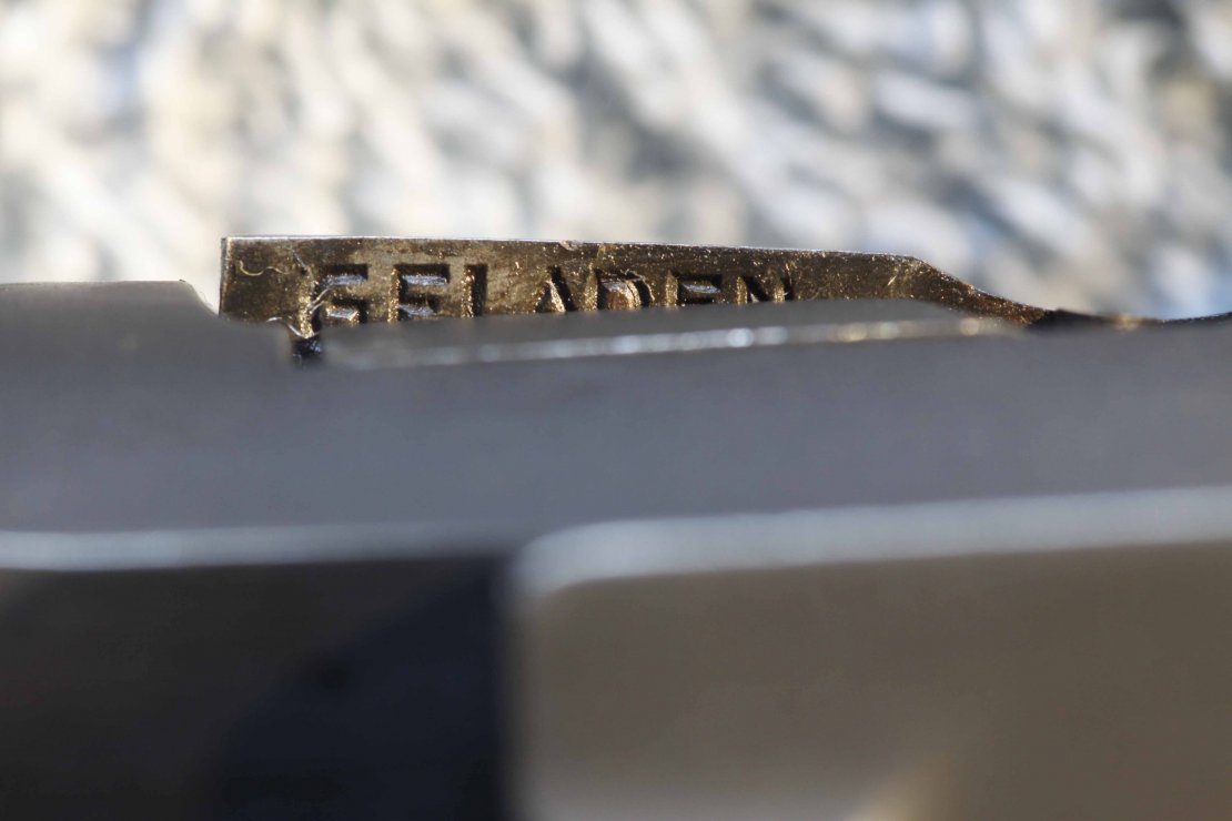

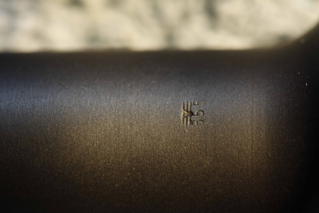

Default Close ups
I resized my close up....

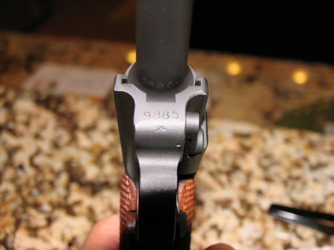

Any ideas what the symbol is below the serial number?

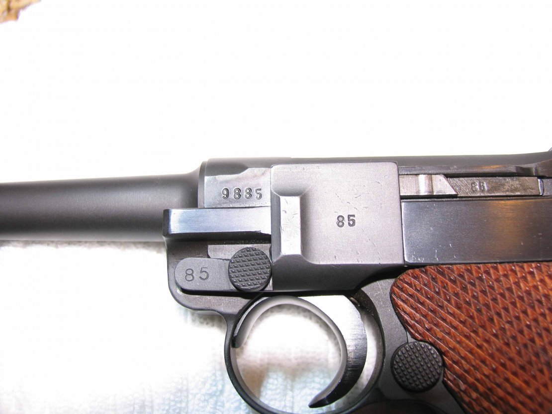

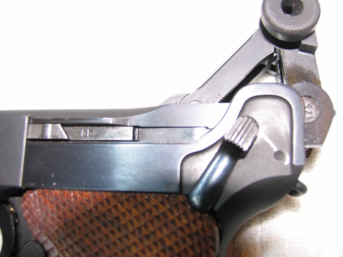

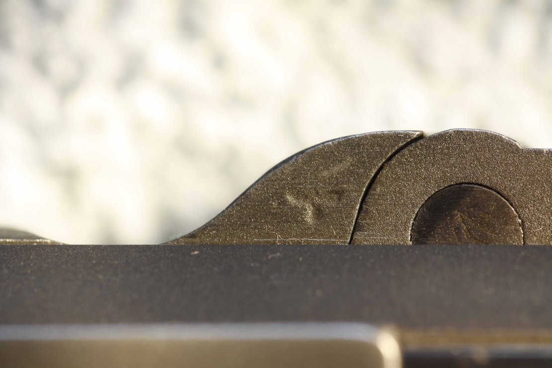

I'm not seeing much buffing damage, so it is a question as to how much work it would be to get the metal "un-blasted" and back to its original degree of polish prior to blue. And those numbers on the takedown lever don't look all that original to me.
I can't say what a good facelift would cost, maybe in the $500 range for labor, and then you'd need grips (mismatched) and a correct magazine (also mismatched), when you could probably buy an original in good shape for $1500. And that is probably more than your restored gun will be worth in the end.
I know I'm rambling here, but suffice it to say that this one is probably enjoyed for what it is, a shooter. And save that money for a nice original Luger.

Default is that a powdered metal finish?? doesn't look bad as a
refinishing option for a shooter.............
Unread 02-05-2011, 11:41 PM   #13

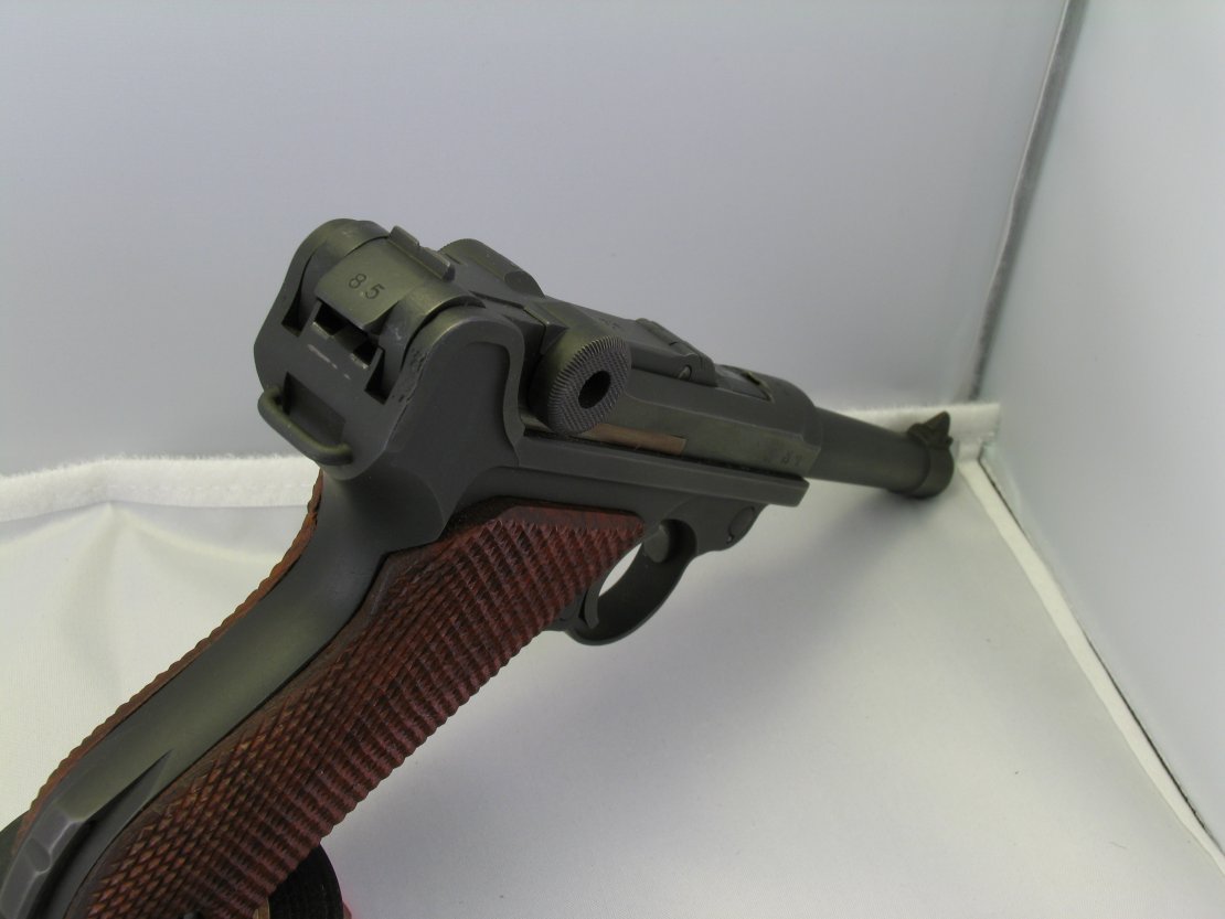

I suspect that the metal was bead blasted prior to bluing. The 2 tone finish shows that they taped off certain parts like the right side flat.
Unread 02-06-2011, 09:46 AM   #14
Or draw filed/sanded after blasting & before bluing. I used to blast beer bottles with names & dates to celebrate memorable occasions; electricians tape worked great for masking off areas to remain smooth.

Blasting hides a lot of defects...Pits, scratches, dings...

Also, the take down lever is not original to the Luger. So it's not a matching pistol.
Nice shooter. Is it import marked?
The symbol on the frame below the 4 serial number digits is a cursive "r", and it's part of the Luger's serial number. "9885r".
Unfortunately, the serial number digits on the frame are not the ones it left the factory with, so someone carefully did their best to make this appear to be all matching.
The digits on the frame, barrel and take down lever are made with the same font dies, and this size font is not what the factory used.
Unread 02-06-2011, 10:51 AM   #18
The digits on the frame and take down lever are made with the same font dies, and this size font is not what the factory used.
+1
The frame under the serial also appears uneven, falling off to the sides...as if it was filed...
