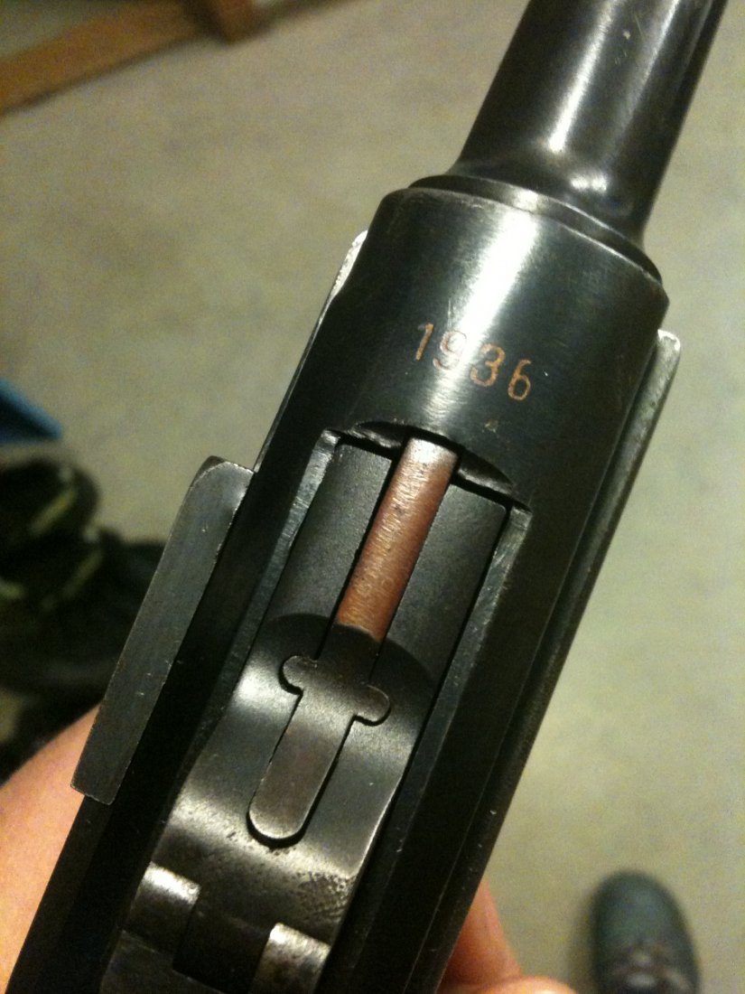

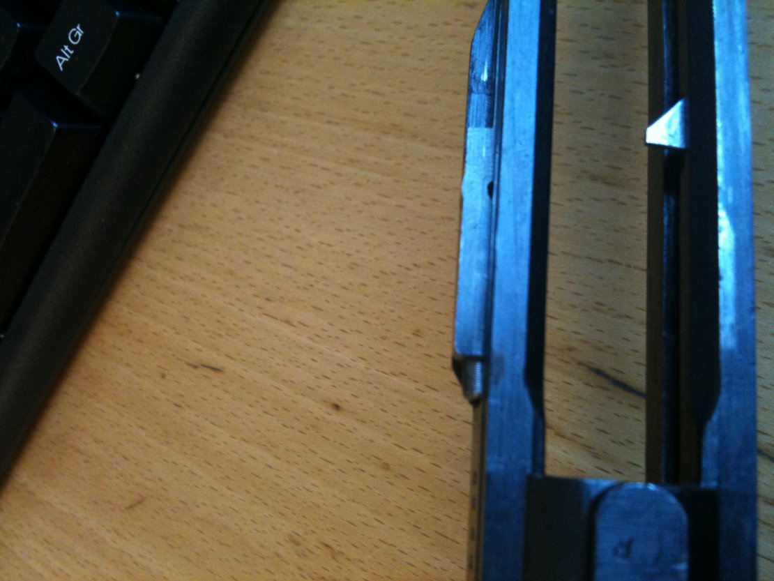

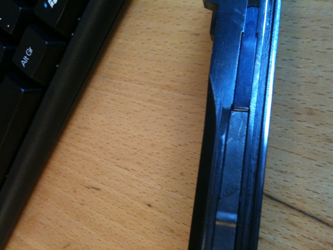

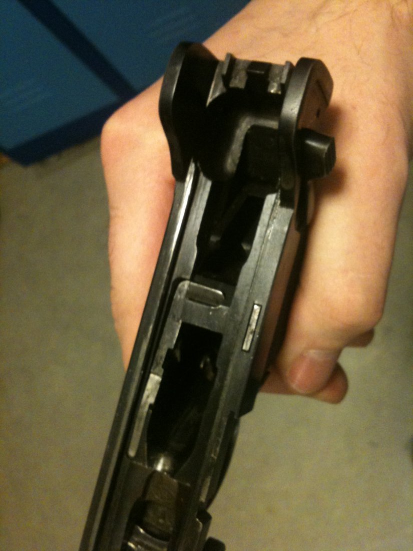

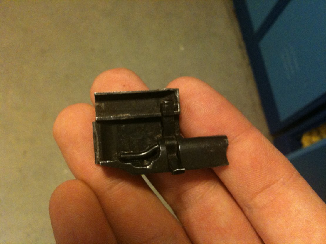

My Luger has a "gap" between chamber and breechblock.
Is this normal?
It also has a problem when I close the breechblock fast. It fires an often 2 or 3 shots on automatic.
Like a locking problem.

The gap on your pistol, while a bit wide, does not seem excessive. Your sear is the root of the multiple discharges. There may be debris or congealed lubricants in it. Does the little plunger move freely? Is there any dirt or debris surrounding it?

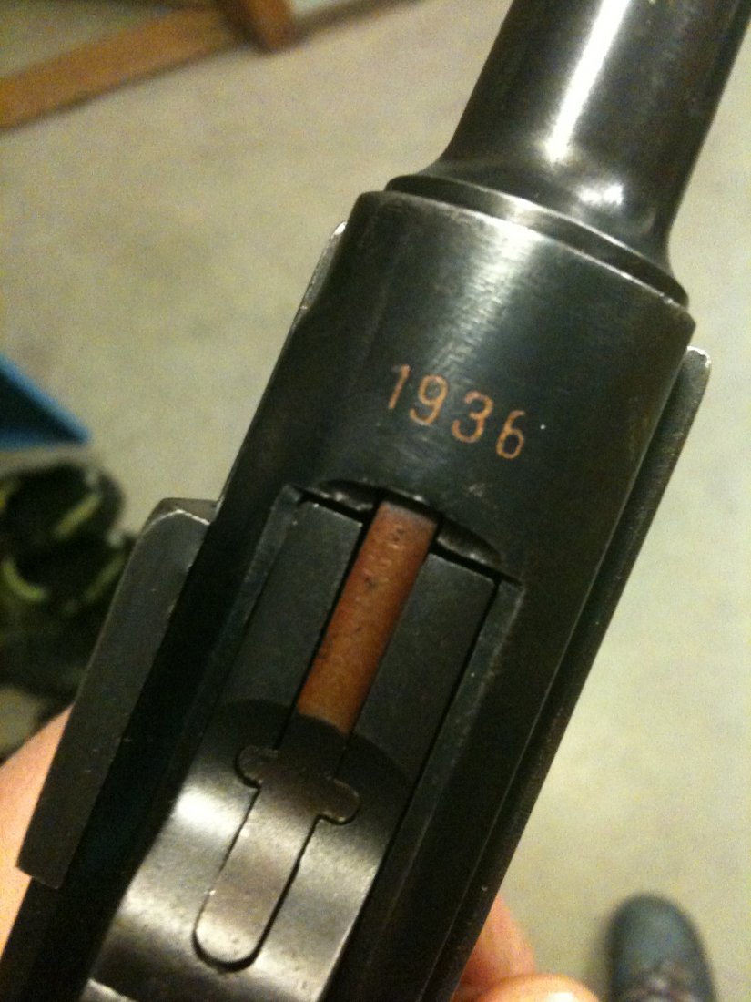

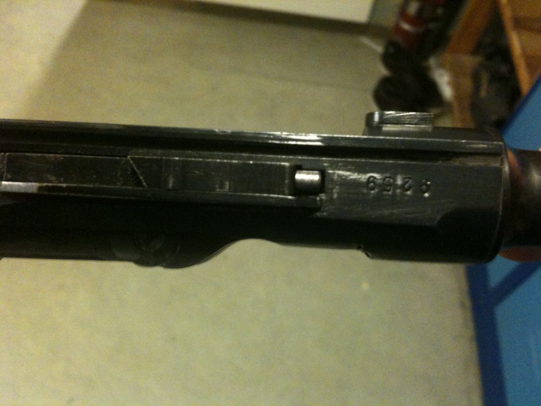

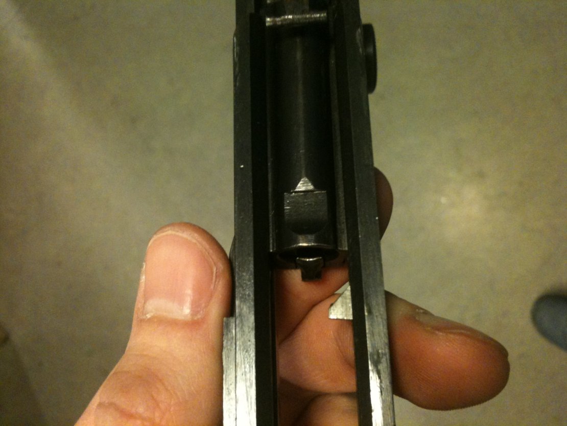

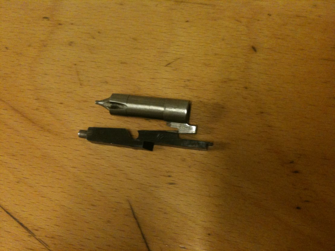

I have disassembled the pistol and there is not any dirt on it. What little plunger do you mean?

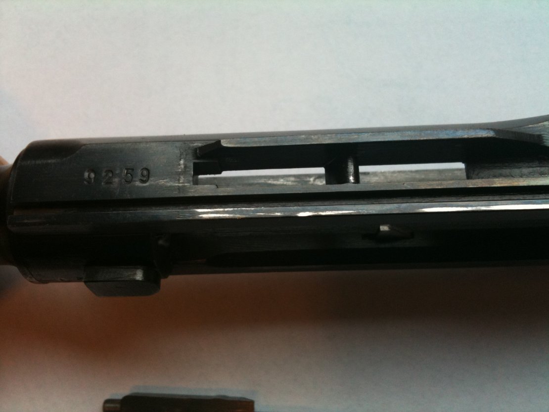

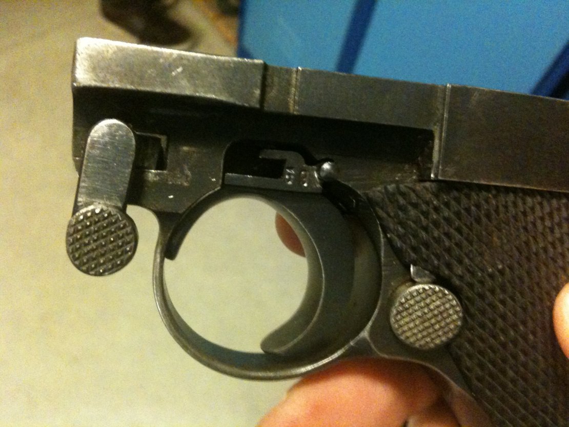

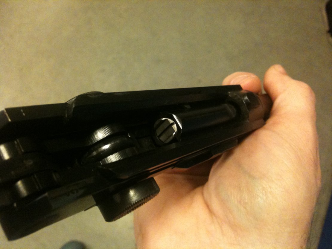

Here are some more pictures.

Unread 02-03-2011, 11:56 AM   #4
Neil Young
Neil Young's Avatar
Join Date: Jun 2008
Location: Scottsboro, Alabama
Posts: 552
Thanks: 567
It's the shiny little thing in your 4th photo down, just to the left of the serial number. It should depress easily and then rebound. By depressed, I mean axially, into the sear bar.

The little plunger moves great into the bar and pops out fast. What other problems can cause this?

Have you removed the entire sear assembly from the upper frame and gone over it carefully? Check for debris or burrs that might hang it up or gunk in the spring.
A remote but possible cause for multiple discharges would be weak ammo, which manages to fire and eject but does not reset the sear.
That's all that occurs to me without having the gun to examine.

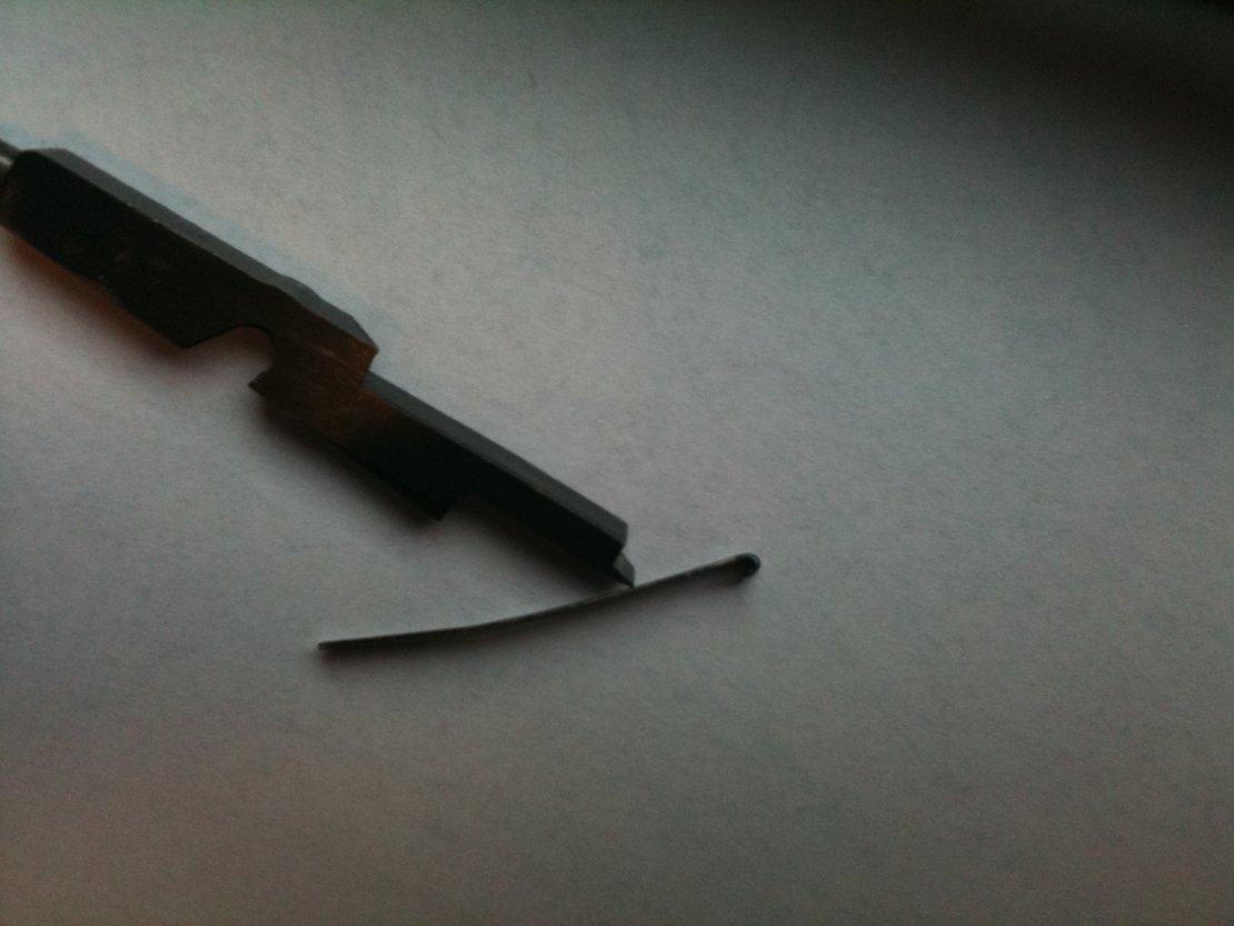

Also check for as weak or bent sear spring! This spring is a flat piece of spring steel which slides into a recess in the upper frasme behind the sear. It must be removed before the sear can be removed from the upper receiver

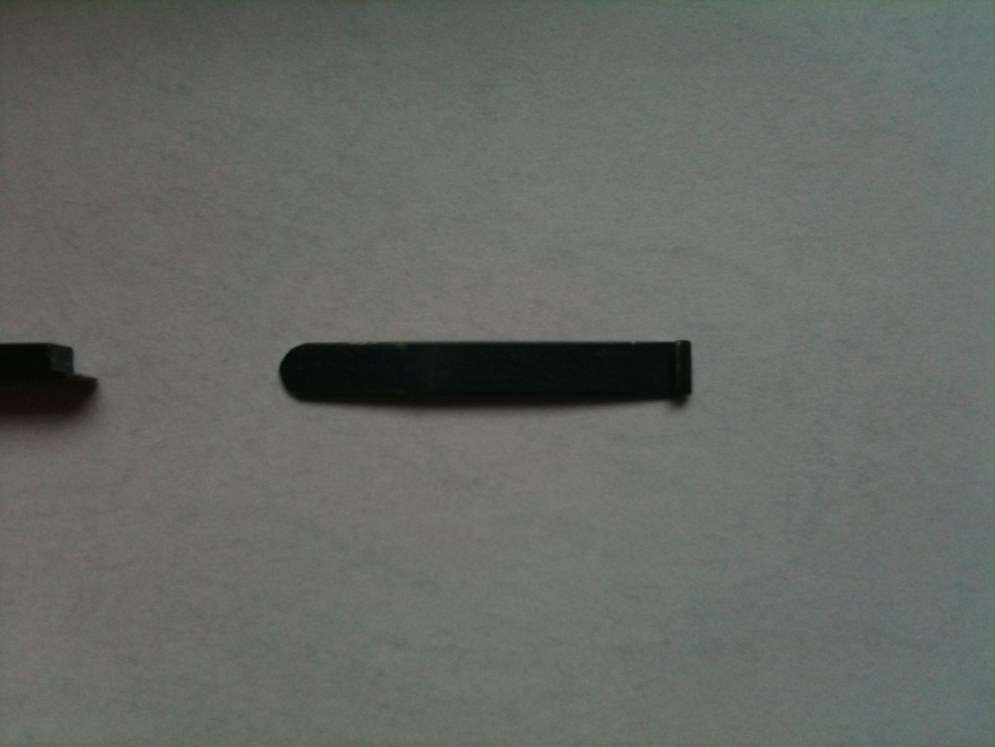

I have taken the sear apart and clean everything. But I do not know if the spring is bend right

I have taken everything apart and cleaned it, but still no luck.
Must I consider new parts?

Hi Andreas, and a belated welcome to the forum!
The full auto failure is most likely related to either a failure of the disconnector (the small roung plunger at the end of the sear bar), or a problem in the engagement of the sear and the firing pin.
What is the condition of the axle pins that hold the toggle train together? Do the pins fit snugly into their mounting holes. This fit is very exact. There should not be looseness in the toggle train. It should not move forward/backward when in battery.
It would be useful to see the sear engagement surfaces closeup (the firing pin and the sear). It's too dark to see the sear surface in your photographs.

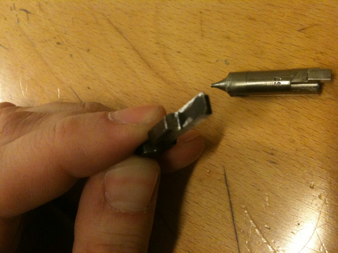

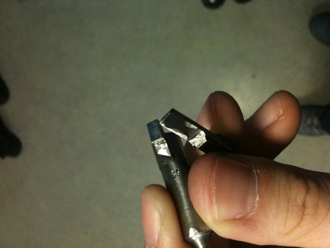

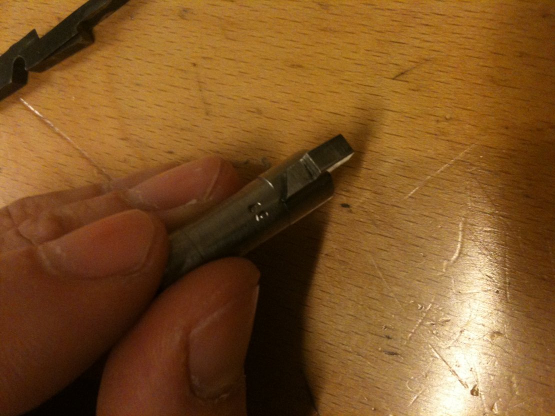

Here are some pictures of the sear and firing pin.
It looks ok to me.??
The trigger plate fits tight to the receiver.

It may be the photo angles, but the sear doesn't look squared to me, and it looks like it may be filed shorter than normal.
Can someone who has worked on Luger trigger/sear adjustment comment?
