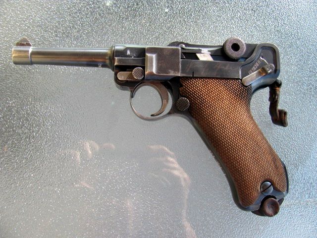

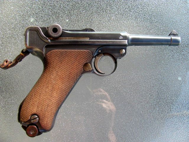

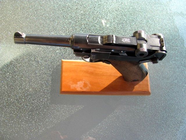

Unread 01-20-2011, 03:47 PM   #4
Default Is This One
or what is it? TKS

Unread 01-20-2011, 04:35 PM   #5
policeluger
Location: Ca.
Posts: 2,141
Thanks: 8
Thanked 89 Times in 54 Posts
Police with a speedy strap to pull out of holster, got one just like it here somewhere.....
Unread 01-20-2011, 04:38 PM   #6
Thank You for your clarifiction!
Unread 01-20-2011, 05:23 PM   #7
Don M
Don M's Avatar
Join Date: Aug 2004
Location: Houston, TX
Posts: 1,429
Thanks: 67
Eric, this one probably has one of the 29 DWM suffixes. I don't have my glasses on right now. Some people (usually Sellers) would call it a sneak for that reason. However, it does have the DWM logo so it is not one of the ones originally intended for the Riff contract.

Unread 01-20-2011, 05:30 PM   #8
They are just so cooool! tks
