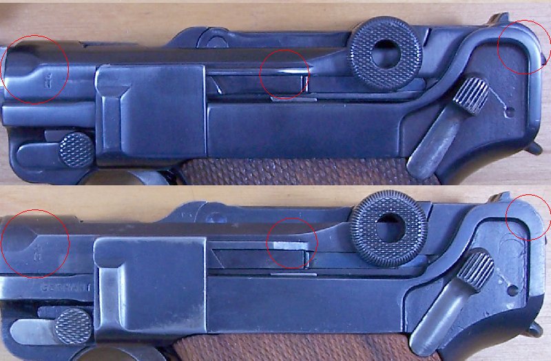

I viewed a pistol this last weekend that had been buffed and reblued, but the seller insisted it was original...
So for those that are unsure, here are some signs to look for...in a Luger...
These are two commercial Lugers, and the biggest tipoff is the smoothed edges and high gloss...Look at a specific area on each pistol, and compare them...
I look for buffing; a pistol that has been "dipped" (blued without buffing) is a bit harder to recognize...

Unread 01-11-2011, 12:13 PM   #2
Railsplitter
Location: Chandler, AZ
Posts: 112
Thanked 13 Times in 11 Posts
Excellent point and comparison photos. I agree. When those sharp edges loose the "crisp" look and pick up a radius it's not a good sign. To me, the entire pistol gets a "soft" look ... almost like it is starting to melt. Outstanding photos !!

Thank-you! The difference between the sharp edges on the original finish and the rounded refinished edges are obvious. I have been relying on buffed out proofmarks and finish color/characteristics to tell the tale and was unaware of this much more obvious indicator.

I think that most novices are MORE attracted to the mildly "Buffed" appearance as being more attractive. I bought my 1st Luger (now have 5, one is a complete Arty rig with loader) to use as a prop for an exotic glamour photo project I was involved in. Picked it over the other 3 because it just looked so much sexier. Of course I registered with this forum AFTER this purchase and realized I paid $200 more than I should've. I realize these were war-time tools spit out in quantity (Germans are noted by myself for atristically over-engineering and complicating everything), the milling and planing marks do give them a sort of unfinished look (which I now appreciate). There will always be a market for ALL the BUFFED shooters out there as long as the "Romance" of the Luger image exists for the next generation. Thanks ALL for this Great forum. Joe

Nice job, Rich. Your excellent photos should prove very helpful when questions of originality arise. Regards, Norm

Good points, I also see a LOT of salt blued DWM, and Erfurt Lugers with those edges. Look for these signs on those Lugers for refinish.
1. No paint in the safety marking
2. Blued in the magazine well and inside the forks of the receiver
3. The finish "feels" waxy when you rub your thumb across it.
4. Bluing looks thin.
5. The absence of polish cut and/or tool marks, DWM and Mausers were polished differently
6. A blued muzzle
7. RED paint in one of the thumb safety "dots" (two small dimples in the frame ears)
8. Look a the flat ares in the light, you can see the light reflect a bit wavy indicating the flat is no longer flat.
9. A blued firing pin or hold open on Erfurt or DWM Lugers
10. OVER polish to mirror under the bluing.
11. No wear on the sideplate island flat, or on the end of the frame side rails.
Any Luger that has a finish that is 100 years old will have been in a holster a few times, unless it has not been in war or preserved very carefully right off the assembly line. Sides of the muzzle barrel band will show wear, high edges on the recevier forks, etc
12. BLUED parts that should be strawed or fire blued.
13. Mis matched parts, or engraver pen marked parts, different height of letters, numbers, fonts on parts.
14. Grips that look out of place, non issue grips, ie Black Widow grips on a DWM.
15. Grips that have a fat edges or really bad checkering.
16. A hold open on a DWM or Erfurt should have a small area on top that you see fireblue to straw color, with the spring in the white and the larger block in the white.
17. An original rust blue will usually show some brown color in strong sunlight.
18. Straw parts on an original gun almost always will show whiter color on oneside of the trigger where the index finger has been drug across it, the bottom of the safety lever can look whiter than the top of it.
19. A original Luger should show some evidence of firing from the toggle stamping the rear of the frame by the lanyard loop area at the very back of the gun.
20. The area on the right side of the frame under the right frame rail should show some remainder of longitudinal tool marks (lines) if it is a Military model.
21. Inside of frame ears flats should have either circular tool marks or longintudinal tool marks that looks like lines at different angles, a MATTE look in these areas that has been salt blued really sticks out.
Any number of these things MIGHT be found in a Luger that is overbuffed and reworked. As a restorer, I try to mimic the original condition as best I can. The rounded edges shown by Postino IS the absolutely most graphic indicator of a amaturish reblue. The frame ear edges round over REALLY poke my eyes out!!

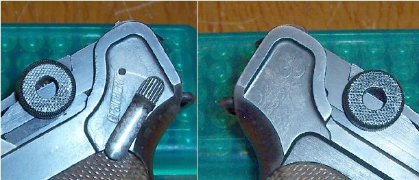

Outstanding list of points, Thor! (Right Click, Save!)
I should have been more specific, too - I was referring to amateurs, not true professionals such as yourself! Specifically, my local rebluer, who *insists* on buffing all his reblue jobs (removing tool marks).
There is one other area I have noticed, and that is the area inside the frame 'ears'. Some reblues I have seen have that area buffed, then blasted, to give a satiny look which contrasts with the polished flats. It looks nice, but is not [IMHO] original (except maybe on presentation pieces). I saved a pic somewhere, but can't find it right now...

Postino, here is a good example of the matte ear! Barf!

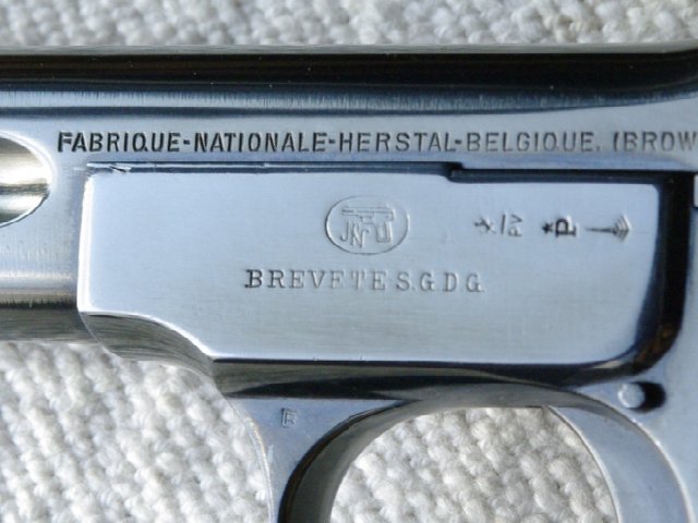

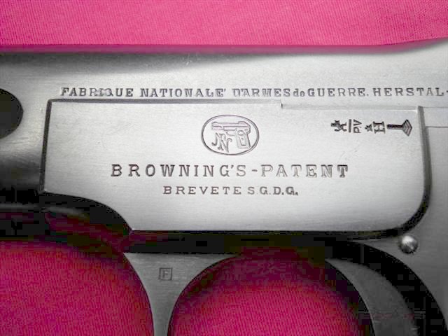

Also a good indicator! I don't have two Lugers with original & buffed out proofs/text, but here's a pair of FN 1900's to compare...

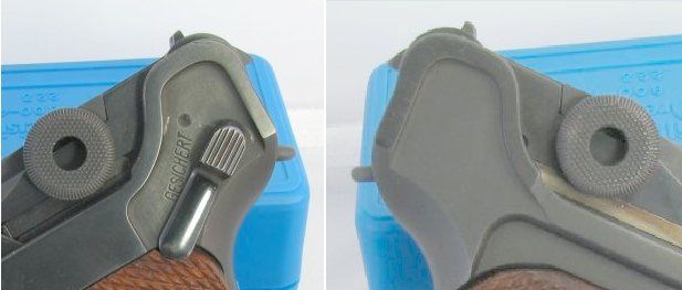

Here's another example of buffed & blasted frame ears compared to my S/42 frame ears...
Original frame ears *should* have tool marks...

not always...look at some original Commercials and Swiss's the ear areas are often smoothly fininshed with no obvious tool marks

My two original commercials have tool marks...I don't have a Swiss (never even seen one, except in pics)...
Should we amend it to say...Military production???

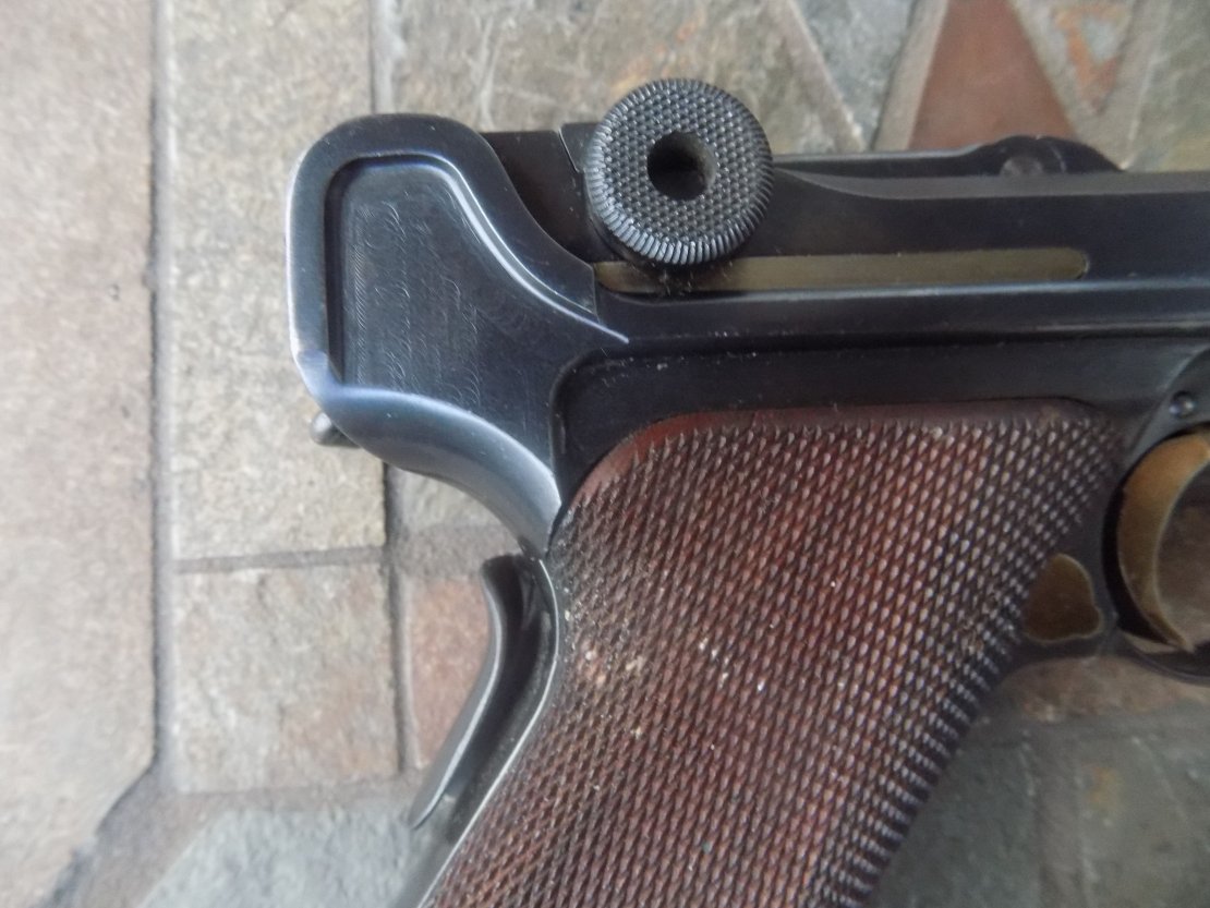

1906 Swiss Military~

Hard to tell ones are those in great metal shape, but regionally "enhanced". For example, the M1930 that I shoot has a polished grip strap. I guess there was some light rust dots there in the past, previous owner aggressively clean it using steel wool. If this grip strap is regionally reblued, it will be hard to tell due to other area is all original. Of course, I won't do that. But who can guarantee its future owner won't do that....
Checked a Schnellfeuer a few weeks ago. Its grip frame (registered) is all original, but its barrel has a digit professionally erased. Barrel and frame matches Form 4 s/n. If that digit was erased to "force matching", that's purely based on wrong knowledge -- the frame number (i.e. registered number) is only partial s/n in Mauser. The work was done very professionally though.
Regarding FN 1900, there were viewers asking "is this professionally restored".. being cautious is good, but that caution was applied on wrong object. I have never seen a single regular FN 1900 being professional refurbished. Its current market price does not support that yet.
