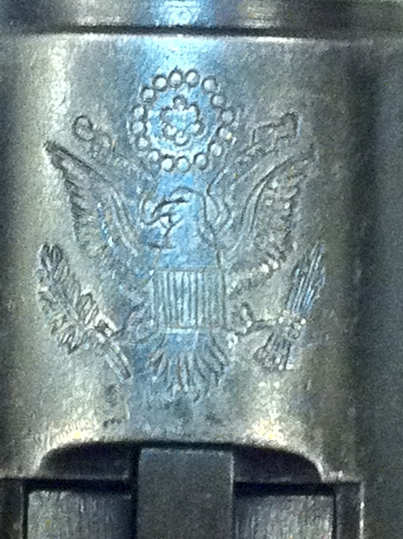

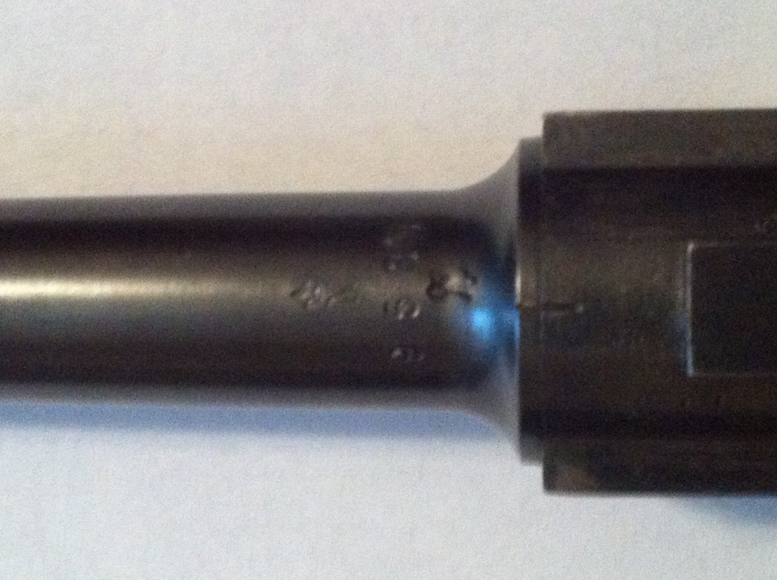

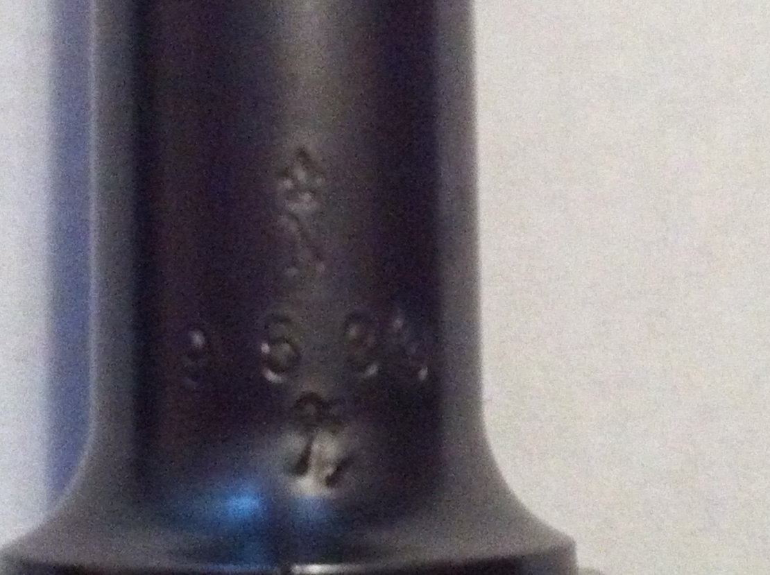

I have doubts about this American Eagle barreled extension I've had for a while. I fear it might be a fraud. The American Eagle chamber crest looks very crude when compared to others I've seen on this site. The barrel is in 9mm. The number 9539 is under the barrel,and GERMANY is stamped on the right side of the extension. I've never posted pictures before,so I hope all of them show. Any information would be greatly appreciated.

It appears fake to me! This is a crude pantograph engraving.
Somebody took an awful lot of time to make so poor a copy of the original..

No suffix letters on AE Lugers.....

Looks like some previous owner liked the way the AE Luger chamber crests look and engraved their own crest... No, not original IMHO. Enjoy it for what it is, a shooter.

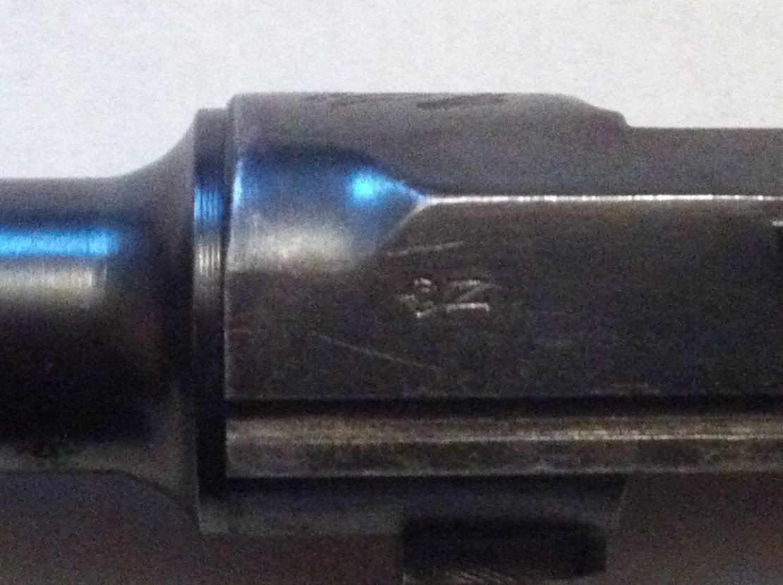

I think it is probably an original AE receiver with a weak chamber marking. Someone replaced the original 7.65mm barrel with a 9mm barrel and "restored/enhanced" the chamber marking with a circular punch. I do not think it is a pantograph as the line terminations are sharply squared off and do not have the rounded look of a pantograph. I am curious and would like to see a clearer photo of the mark below the serial number on the barrel if that is possible. Your photos ar pretty good for a first timer by the way. Thank you.

Could very well be a post WWI 9mm with suffix. A full shot of the pistol would be helpful.

Definitely not pantograph work. Most likely amateur engraving.

Until photos of the whole pistol are shown no real answer can be given. There were many AE Lugers sold into the US market in the 1920's and 1930's most notably Stoegers. Another indicator would be safety and extractor markings.

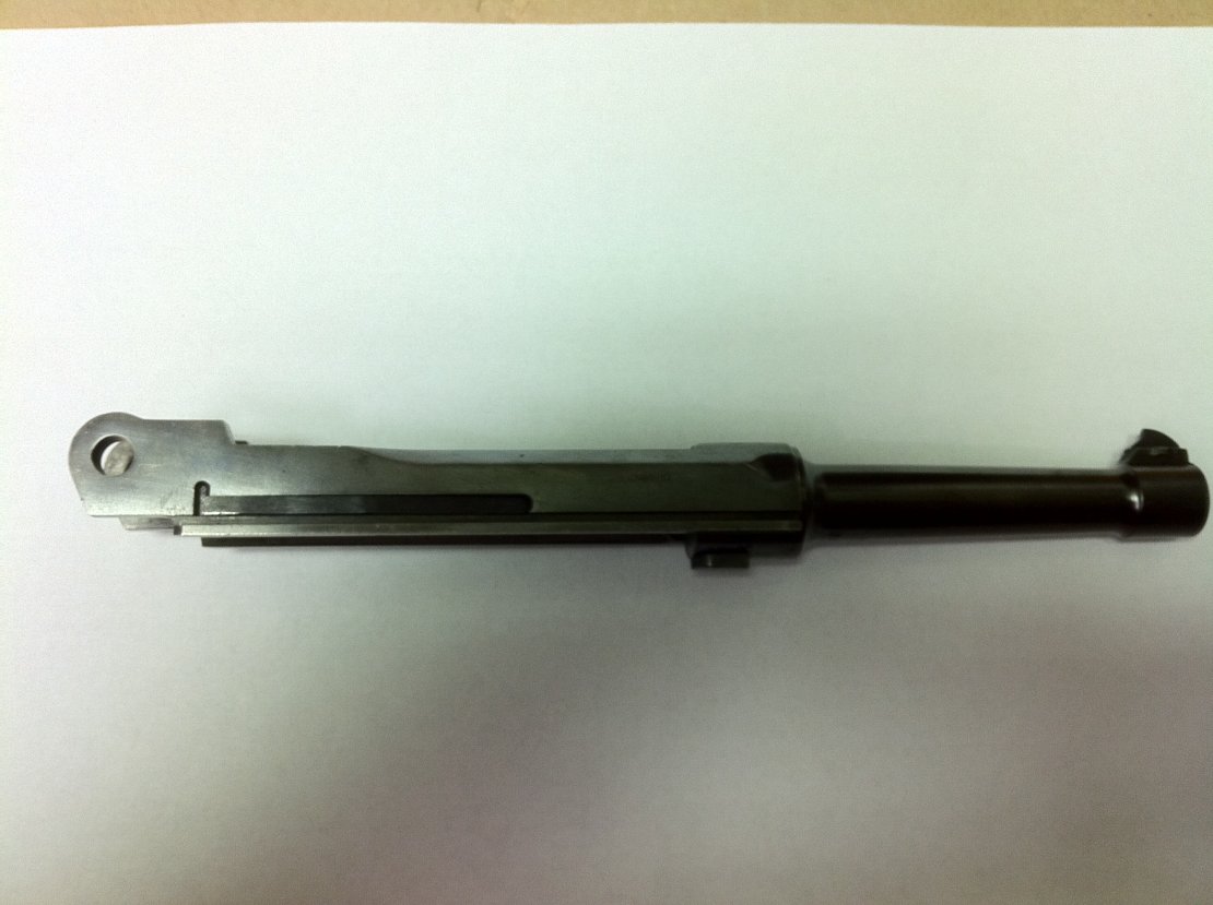

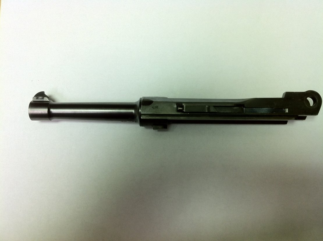

Thank you all for the great replies. But it is my fault that I did not make it clear that all I have is the barreled receiver and the mismatched internals. I am building a mix master shooter and hope to soon find a complete frame. Is it safe to say that the receiver is DWM ? Any more information would be greatly appreciated.

The horizontal "Crown N" on the side was used by DWM, so yes a DWM receiver.
I am pretty sure we have seen this gun before during a previous review. It looks like it has been parted out.
Good luck on your shooter,
I think Simpson LTD has a couple of frames for sale and Luger Doc can supply you with everything else you might need. You can also ask him about frames,
He is very reasonable in price and good to deal with. You will be happy with your purchase.
Many uppers are twisted during barrel replacement, if you can check yours for proper operation before spending too much on additional parts. They can be straightened but there is a cost involved.

The beak, the vertical lines across the chest, and the arrows are all suspicious looking, to my old untrained cynical eyes...
